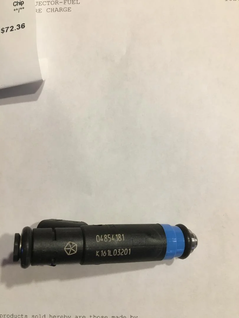

ok, so I had the dealer injector installed and only approx 100 miles so far so can't say it solved the issue.
some observations, which I'm sure you old timers know but I had no idea and may assist someone in the future.
1. my oem injector on my 04 LJ is Siemens. # 04854181
2. I purchased this injector from 2 different reman vendors off ebay (just to compare with the dealer part. they all were were advertised as Siemens 04854181, and were screen printed with the Chrysler logo and part #. exactly the same as the dealer OEM injector. 1 was $18 to my door(injector planet) the other was $70.20 for 6 from atlantaautopart.
3. they were all the exact same part with the exact same markings, screen printing etc.
4. the dealer part was listed as reman, but had was 100% pristine in condition. absolutely no indication of having been used.
5. the ebay parts all showed signs of having been used but looked very well redone.
6. so, I believe 100% in OEM. I guess you will just have to trust the vendor, but these I got from ebay were OEM.
7. If anyone needs an injector now, has a good reputation here and will pay shipping (and install and give feed back), I will send out 2 injectors for free just to know if they work. 1 from injector planet and one from atlanta auto.
