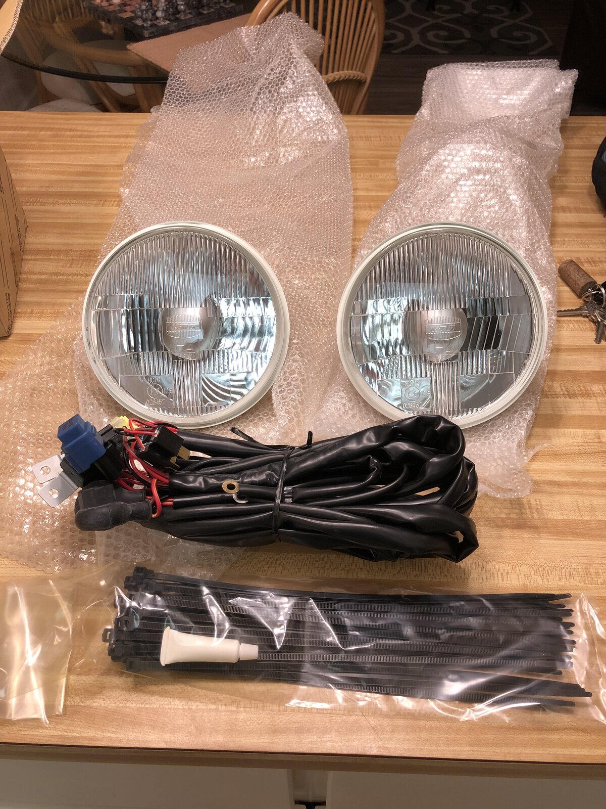

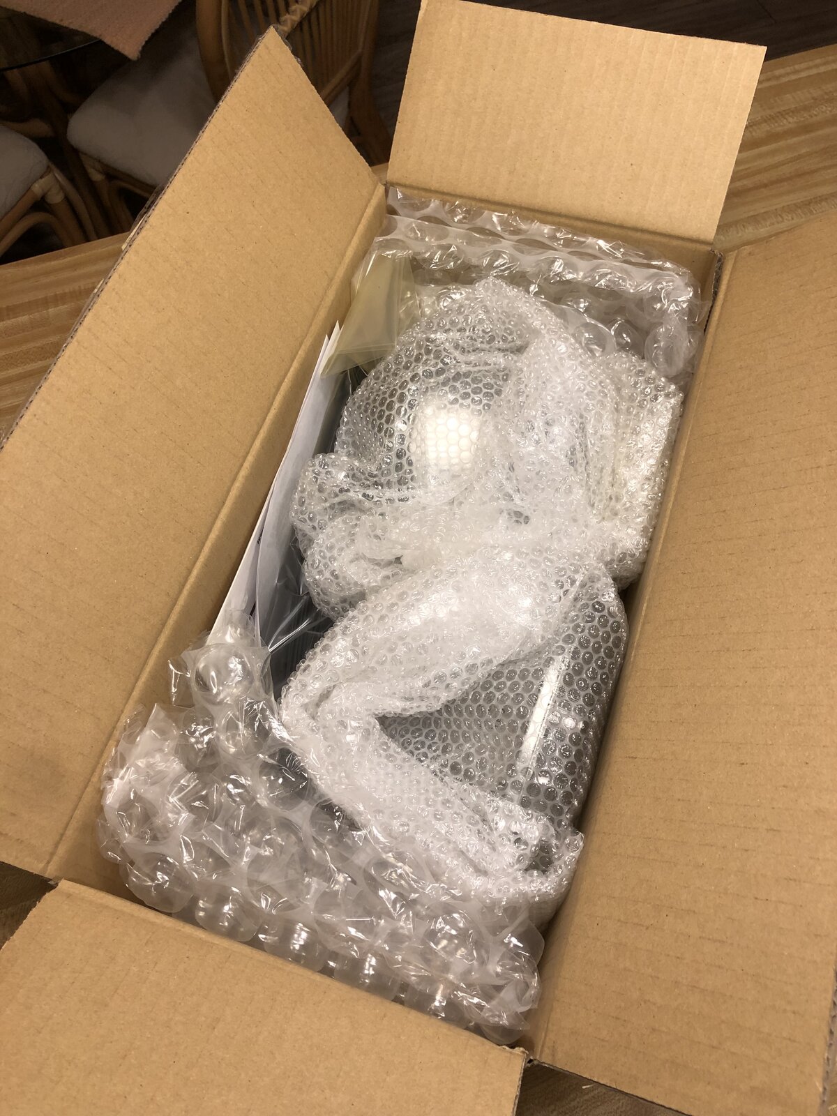

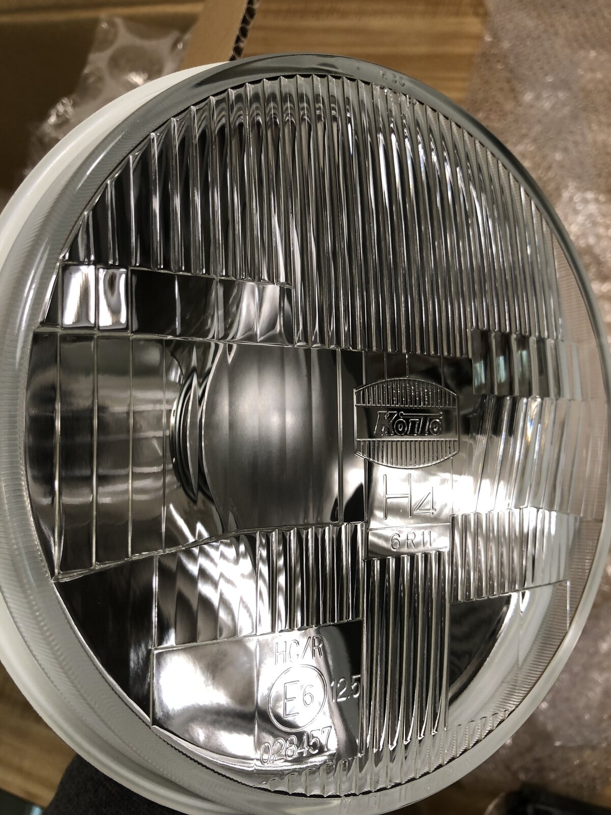

Product came in a nicely packaged box that shipped out of Phoenix the day before. The kit includes two H4 housings, bulbs, and a complete heavy-duty wiring harness with fuses and relays designed to wire directly to your battery.
View attachment 282934View attachment 282935View attachment 282936
The brand of the lights is Koito, and they are extremely well built and manufactured in Japan. These are glass surfaces and feel very heavy duty with a thick glass lens.

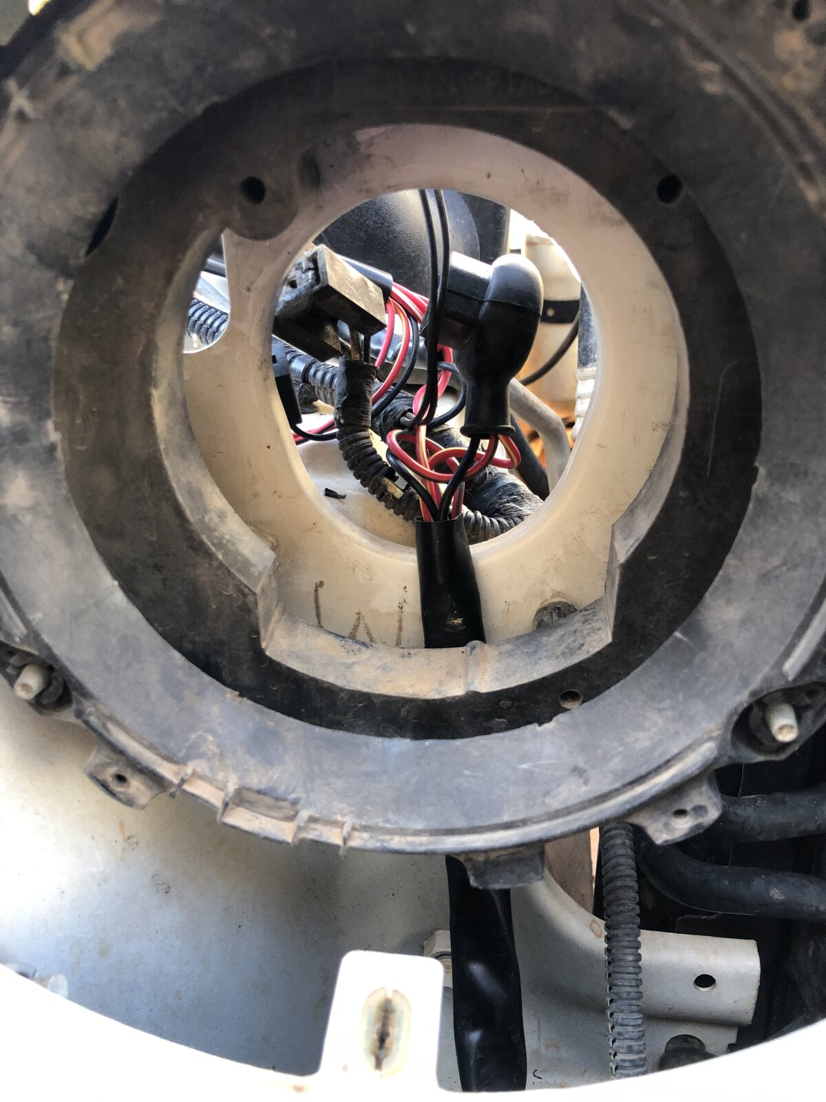

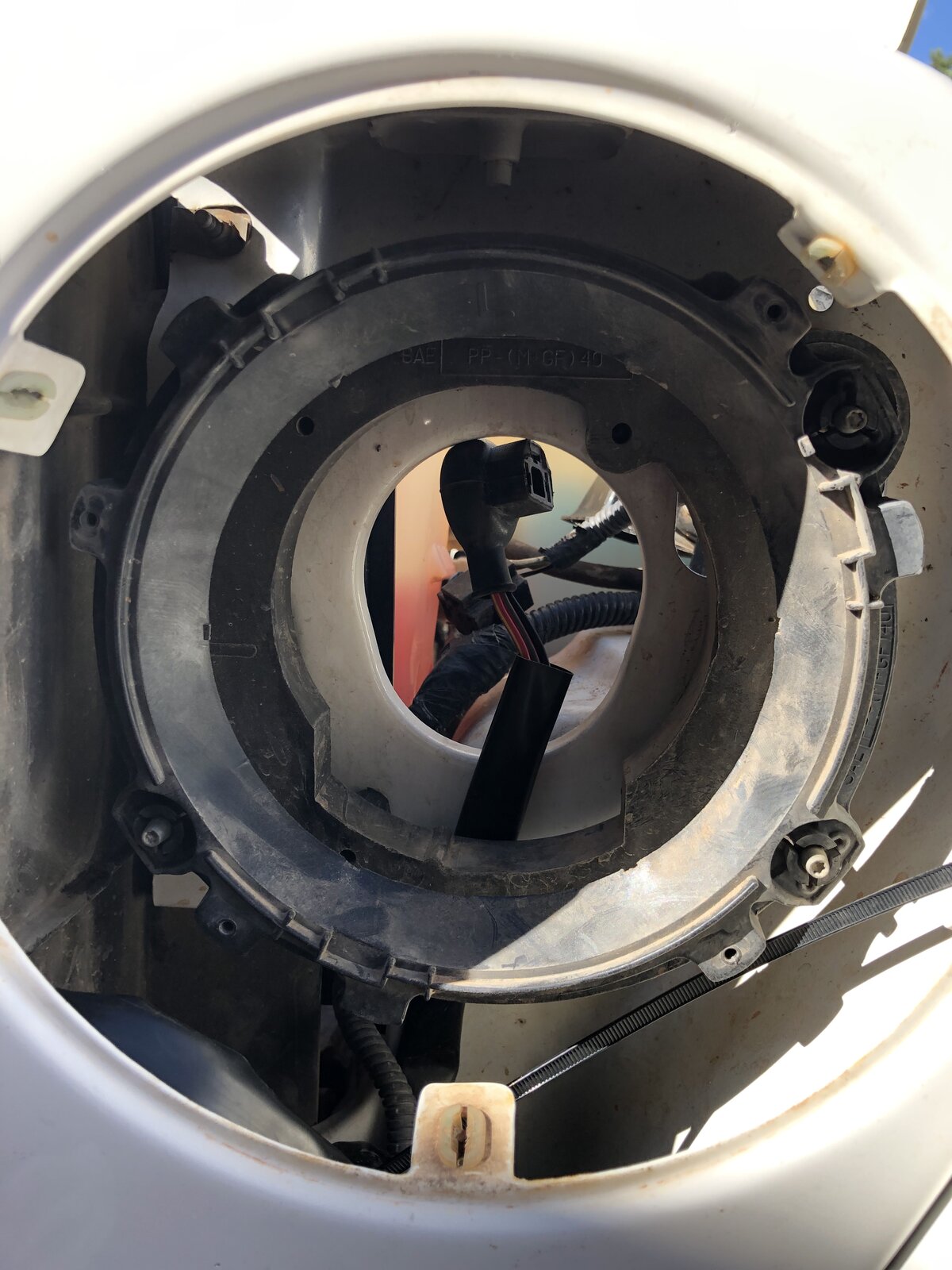

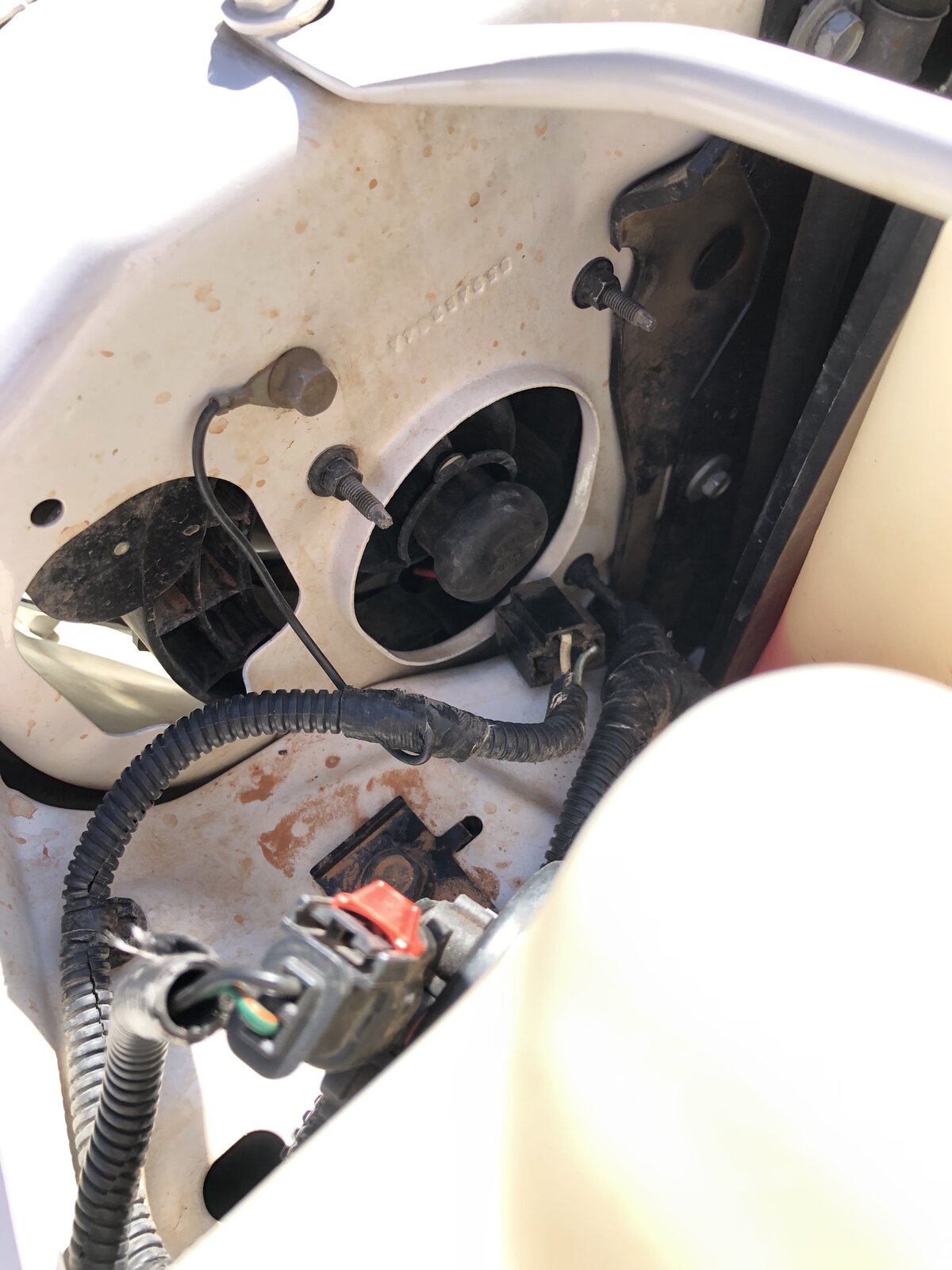

Today I worked on install. First step was to remove the stock headlights after deciding to run the wiring under the headlights and through the grill to the driver side. My first stretch of wiring ran under the PDC and followed the loom running past the AC line.
View attachment 282943View attachment 282942

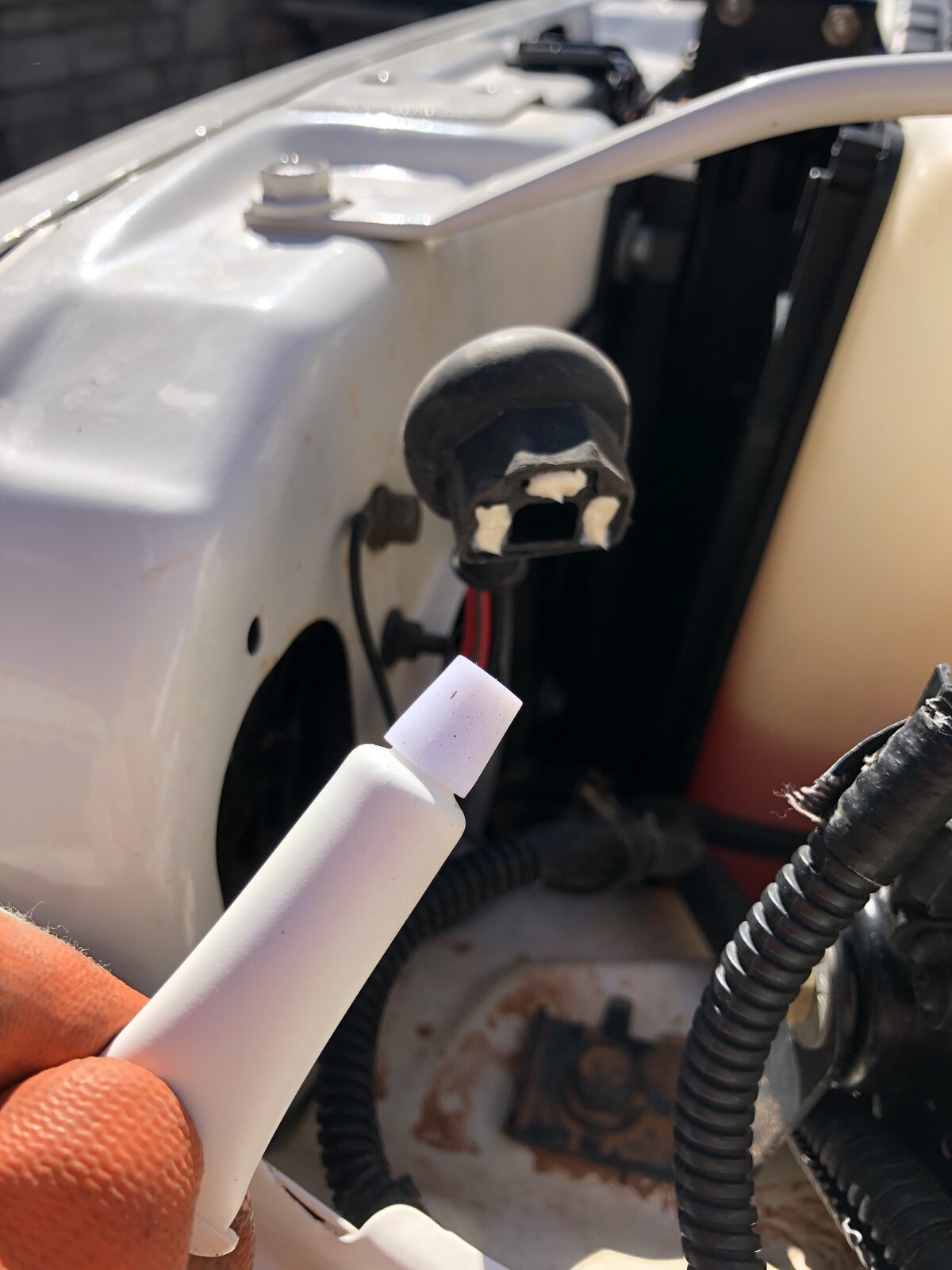

Next step was to line up the first headlight plug where the headlight would sit. The plug that attaches to your factory harness for signal is wired next to the first headlight plug. The manufacturer was kind enough to pack the plugs with dialectic grease where the wires were inserted. The new plugs also have nice water/weather proof boots attached.

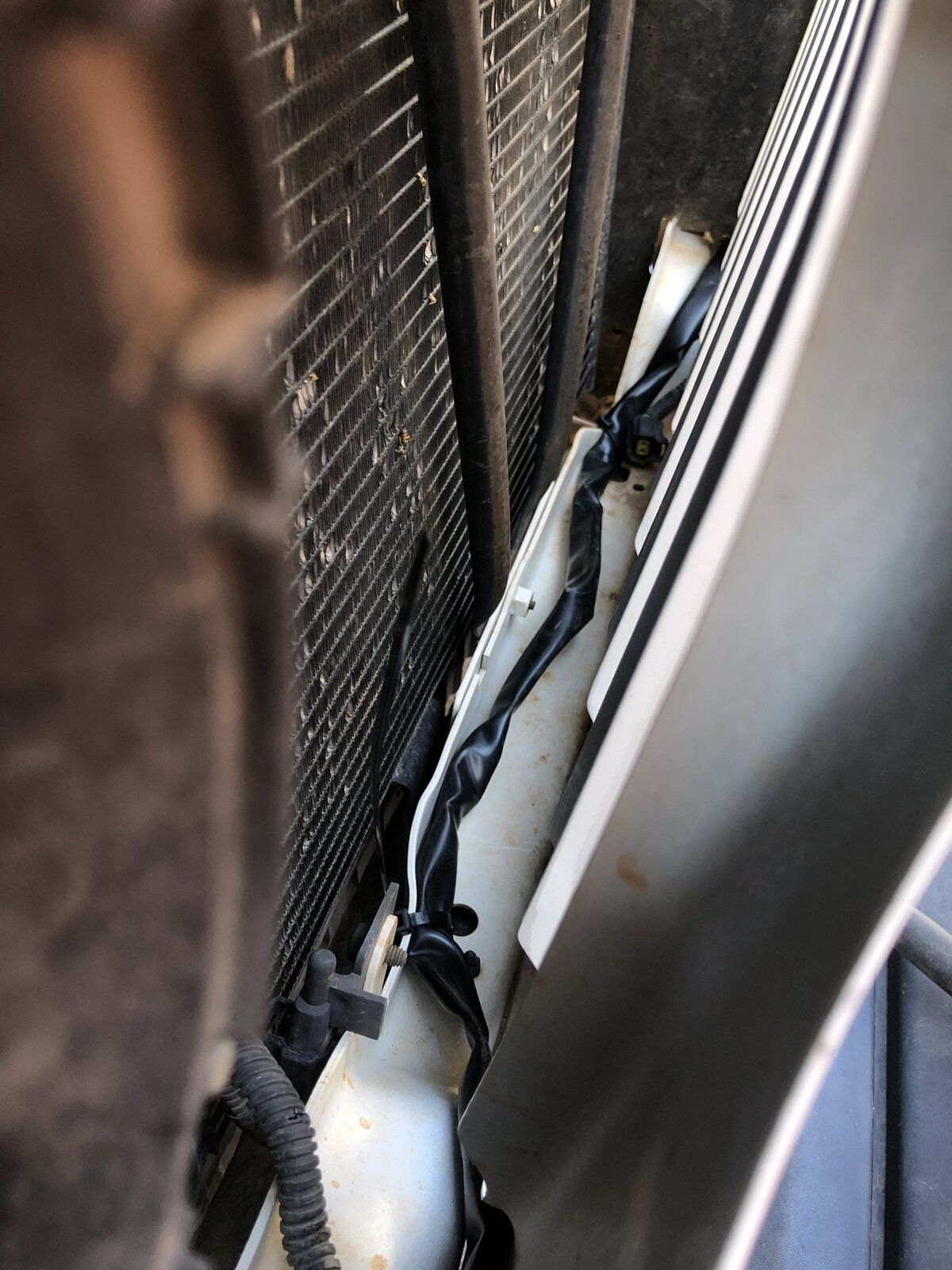

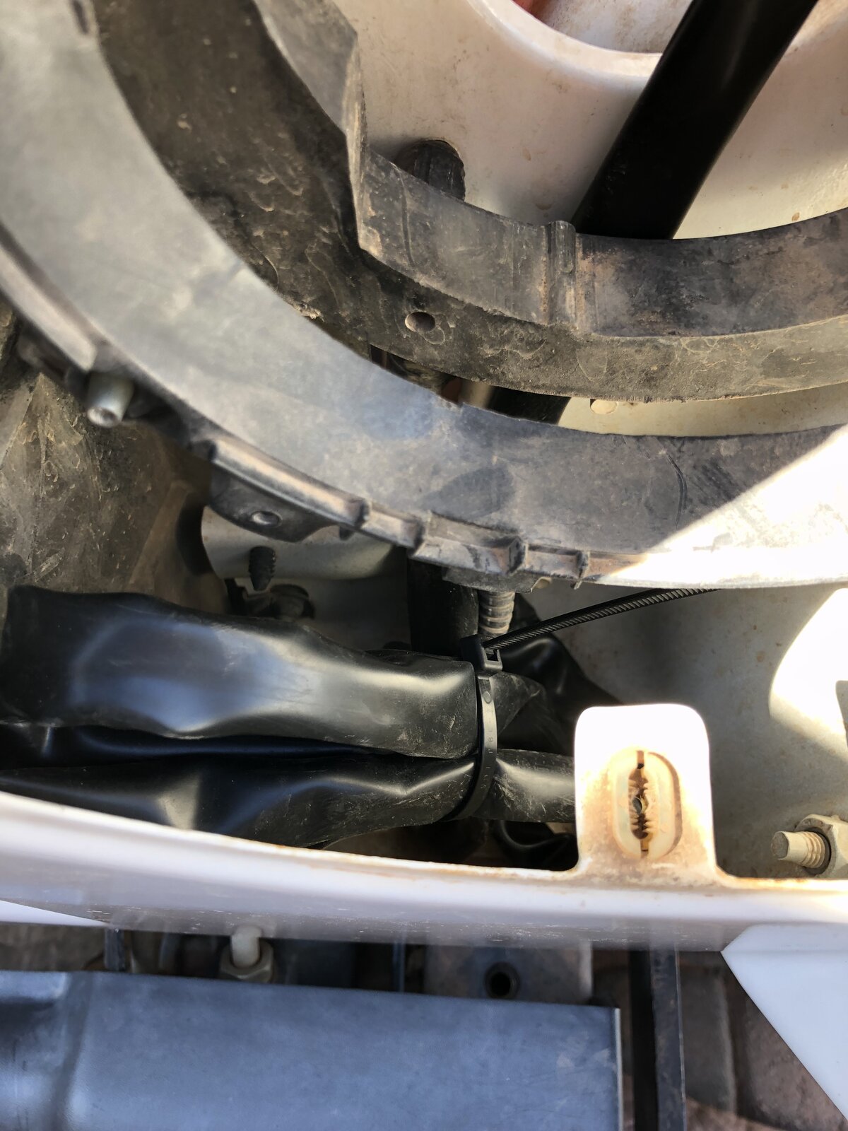

Once my length was set, I started securing the harness to the bottom of the grill with the 50 (not exaggerating) NASA-grade zip ties provided in the kit. The wiring ran nice and neat through the channel in the bottom. On a side note, I also found where the air temp sensor plugs in for the fancy electric mirror.
Next I adjusted the wiring to the proper length behind the driver headlight, and bundled and secured the excess wire underneath it in the dead space below the light.

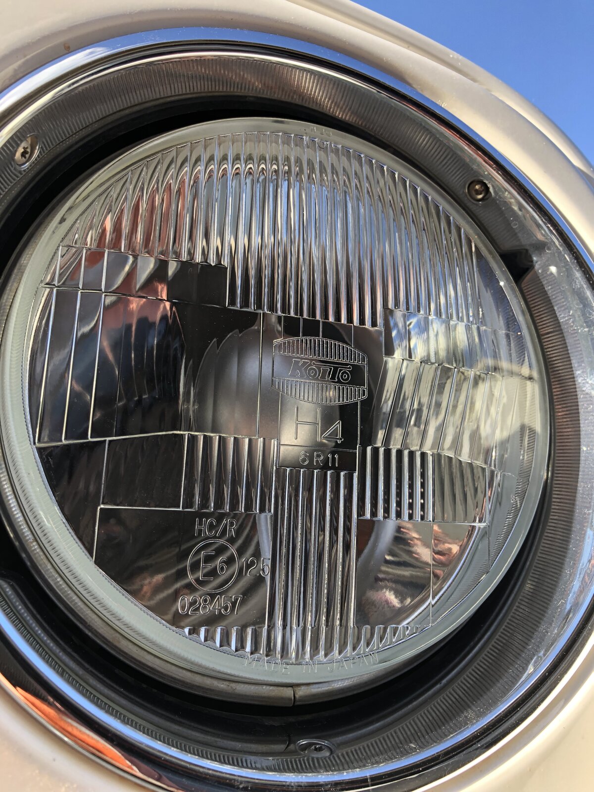

Satisfied with how the wiring was run, I installed the driver side light and packed the plug with the supplied dielectric grease. You can see how nicely the two rubber boots on the light and plug fit together.

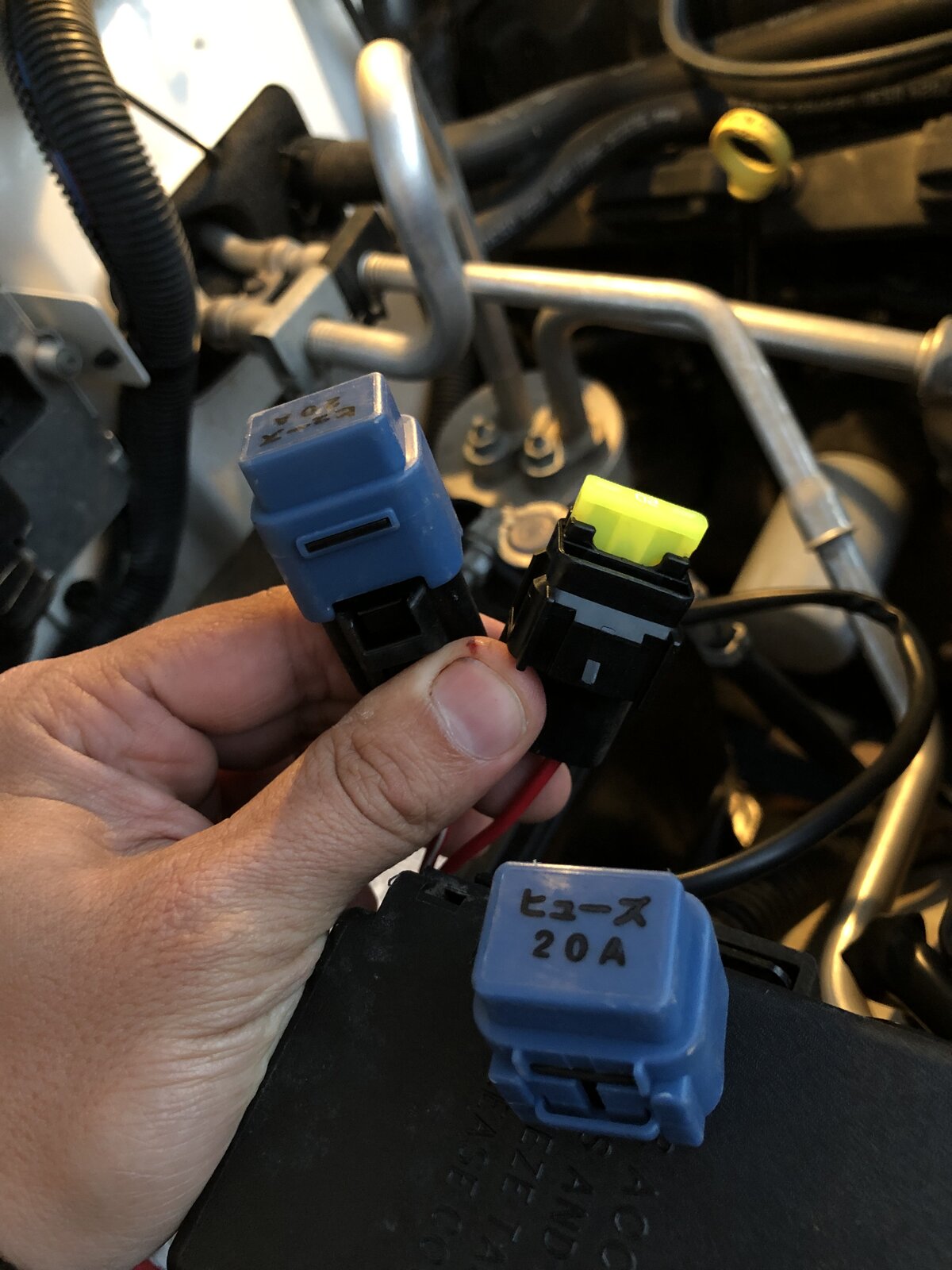

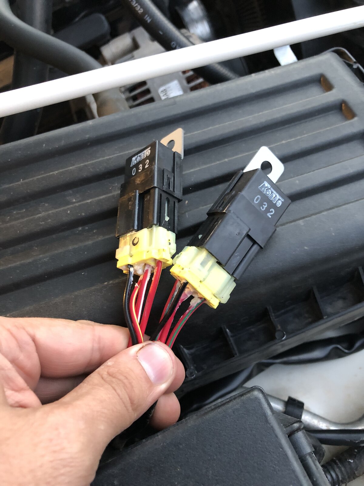

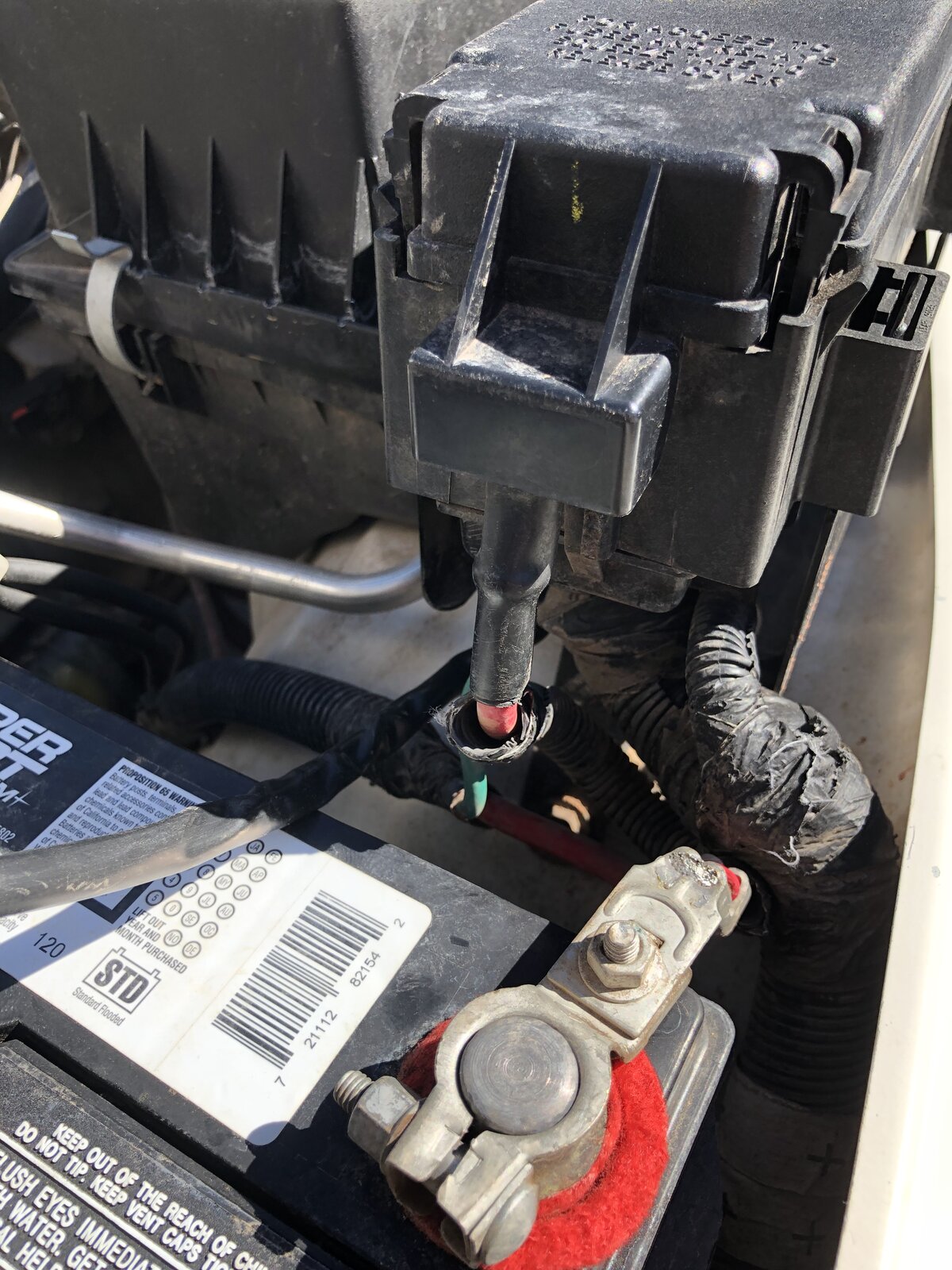

The same was done on the passenger side. There was a bit of excess wiring between the battery and the first headlight, so I zip tied the excess off under the PDC and out of sight. Once tied off, I could find a permanent place for the inline fuses and relays in the kit. These were also all packed with grease.

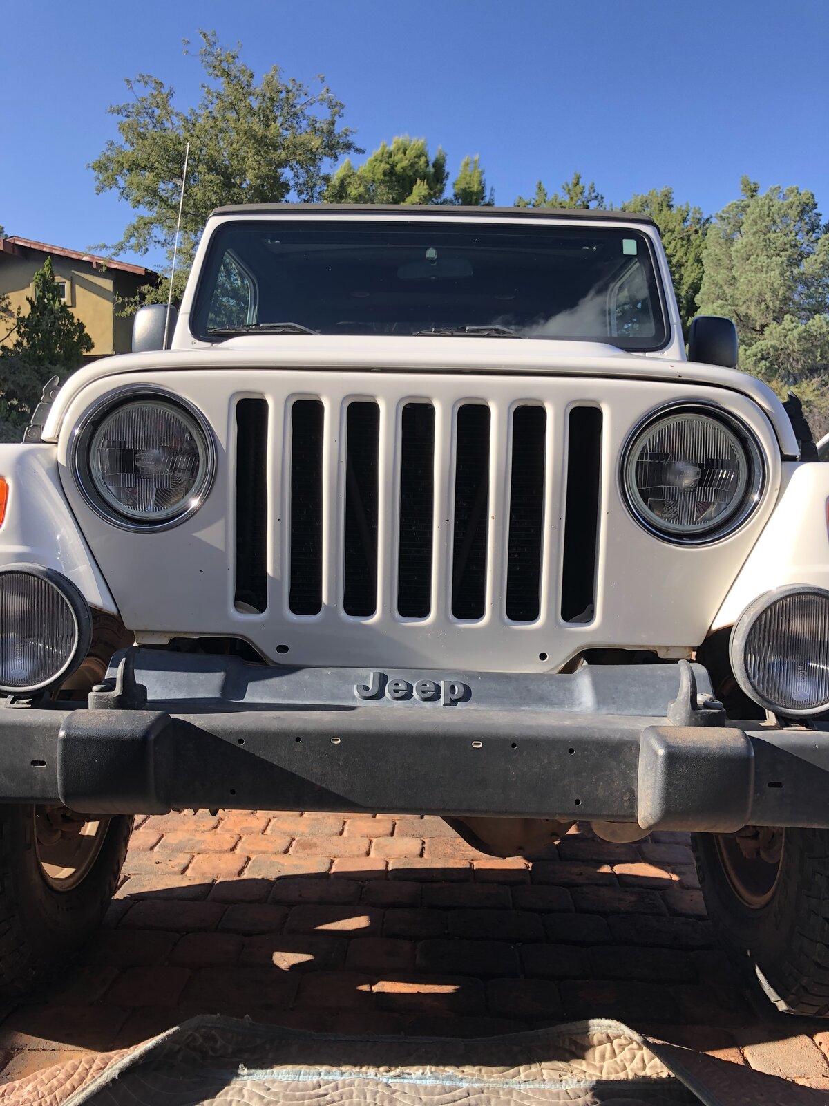

Alright here are my results after a little adjusting.
Low beams. Like I mentioned before, they have a nice crisp and flat cutoff so you aren’t blinding anyone in front of you, which allows you to set them a little higher. They are nice and wide allowing you to see well off of both sides of the road. The brightness isn’t anything to celebrate about but then again they’re low beams.
High beams. Well….they’re high beams! And mighty bright ones too. Lots of light in all directions, and even a little bit of light cast on the ground right in front of the vehicle, which can be a common dead spot depending on the vehicle. Overall I’m happy with the light kit and it was definitely money well spent/saved.
