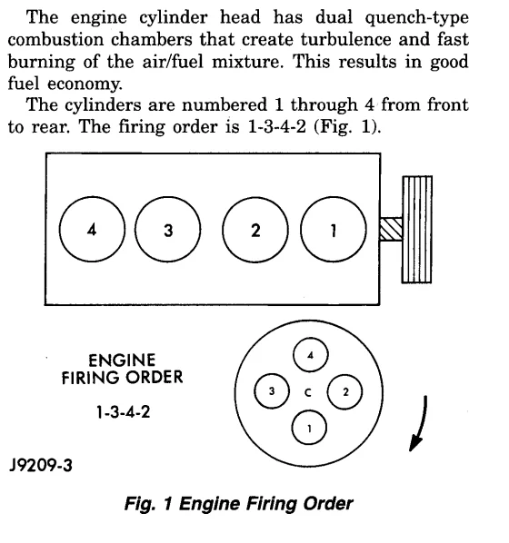

If you were pulling the spark plug behind the A/C compressor wouldn't it have been the #1 spark plug not the #4 spark plug?
