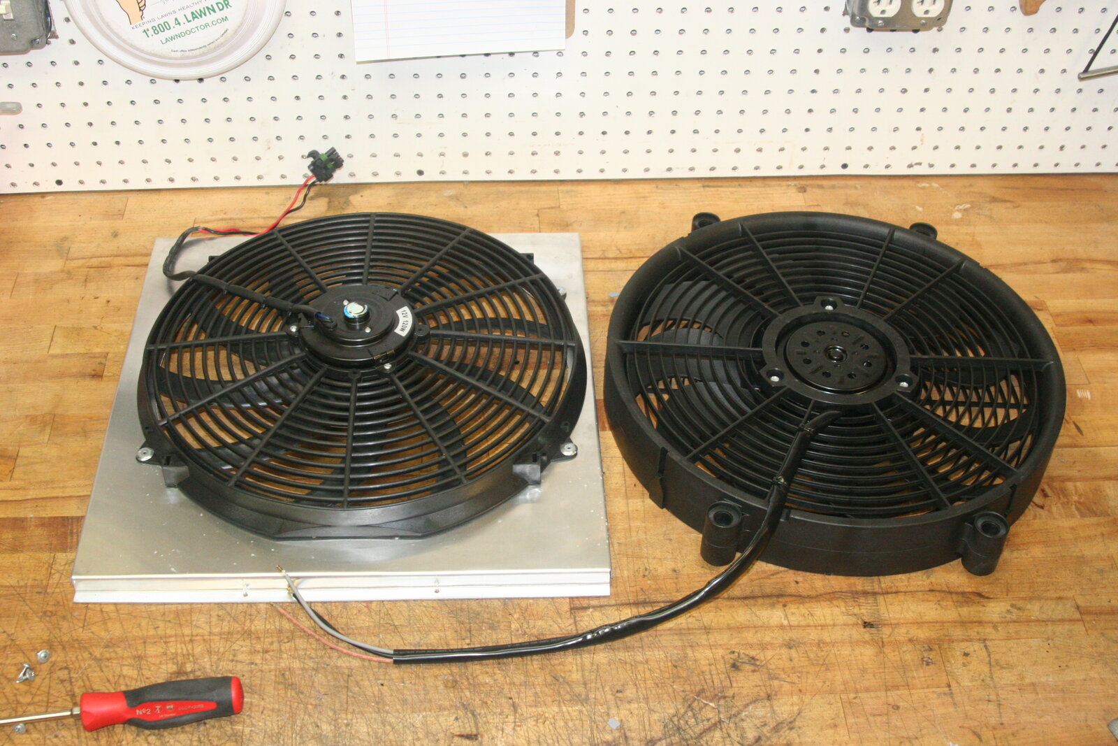

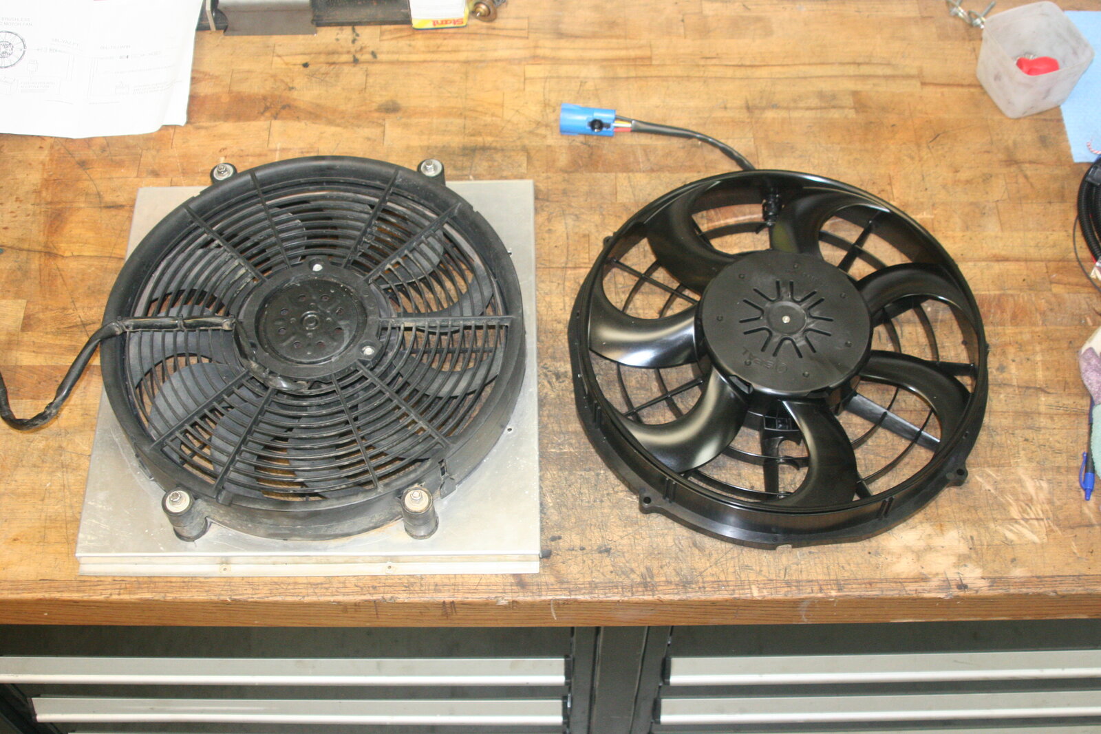

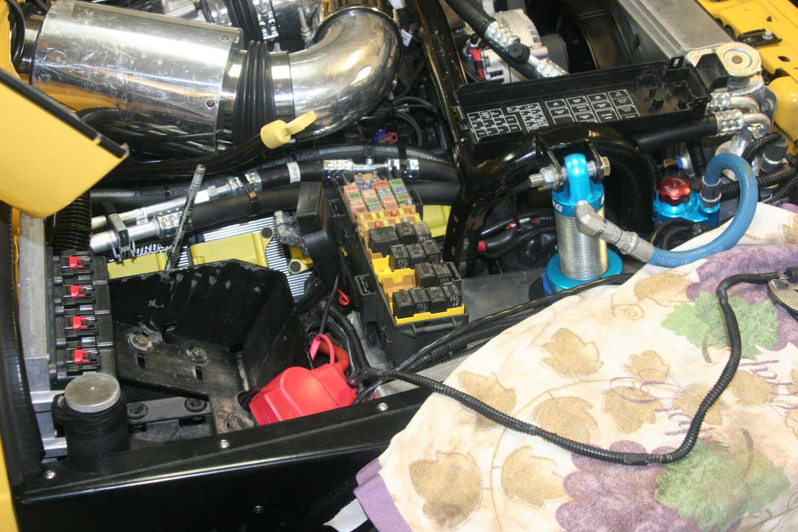

When I built the Hemi, it's was running hot with the original fan I bought, so I replaced it with the most powerful fan I could find at the time - one that was still slim enough to fit between the engine and the radiator. What fit the bill at the time was a Derale 17", 23.5 amp fan. At the time SPAL had more powerful fans available, but all were too deep at about 4.5".
That's the original on the left, the Derale on the right.
In front of the fan is the radiator, A/C condenser, and radiators for power steering and the tranny which together cover the entire opening. I now think that the 23.5 amp fan is not enough for that setup.
