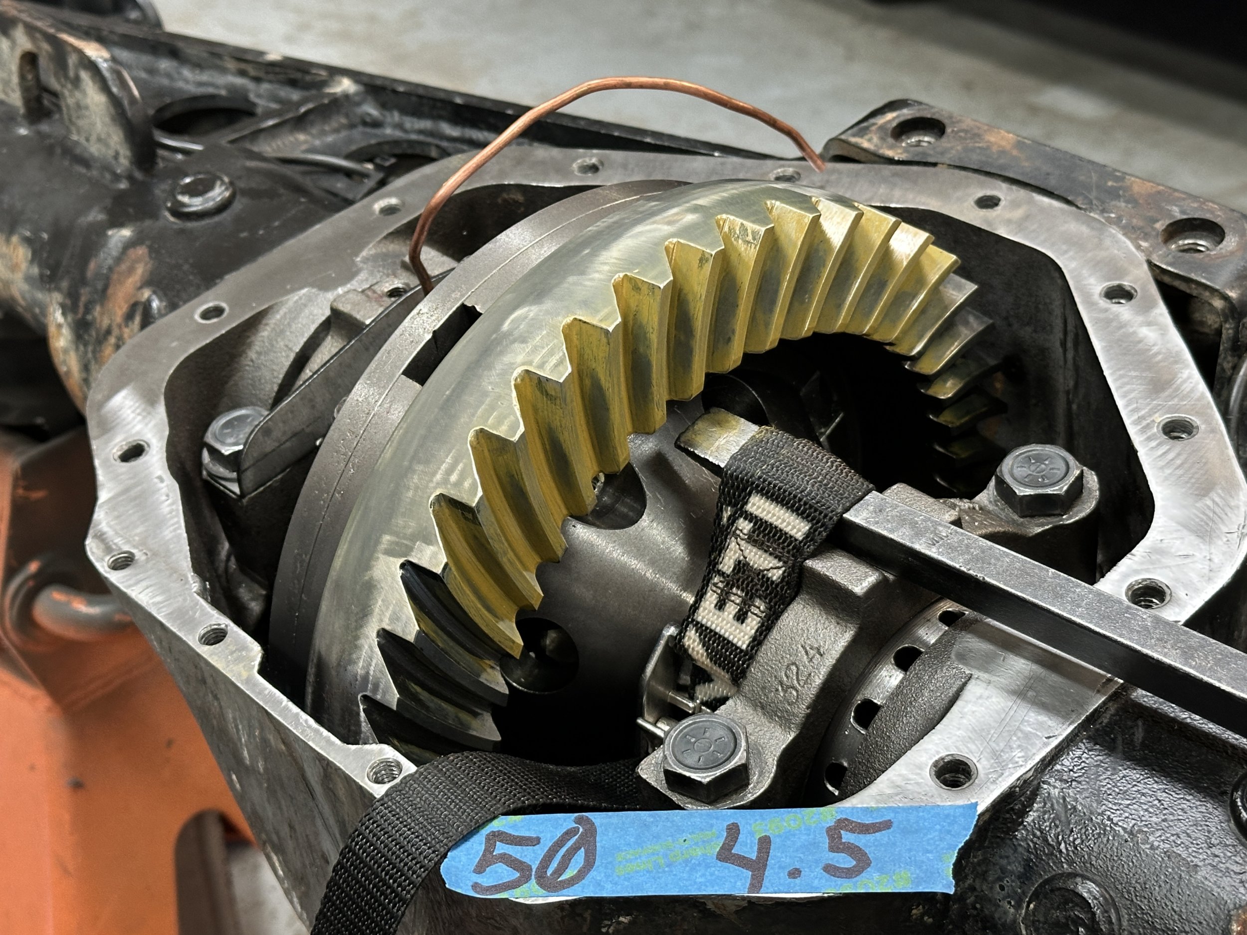

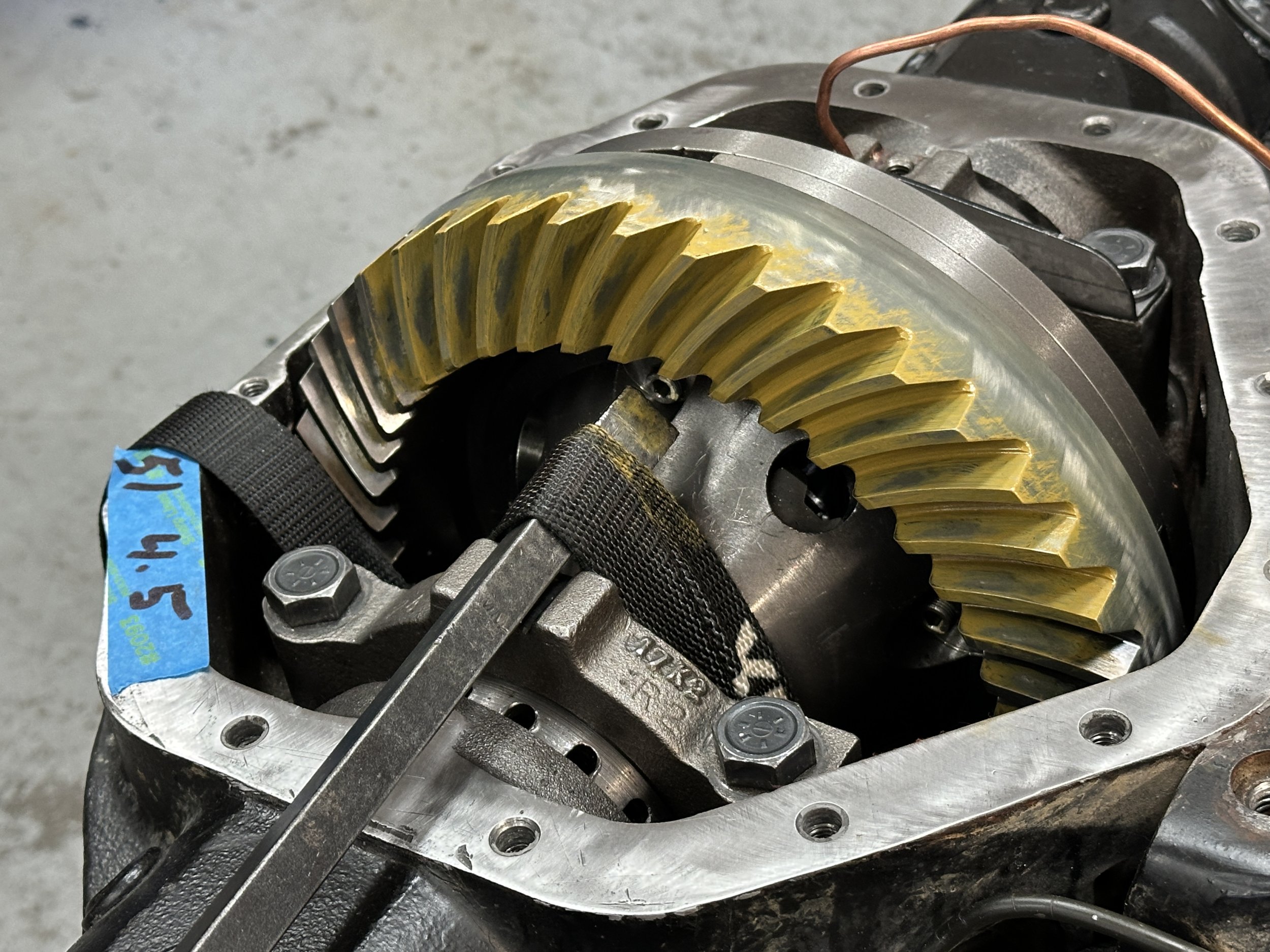

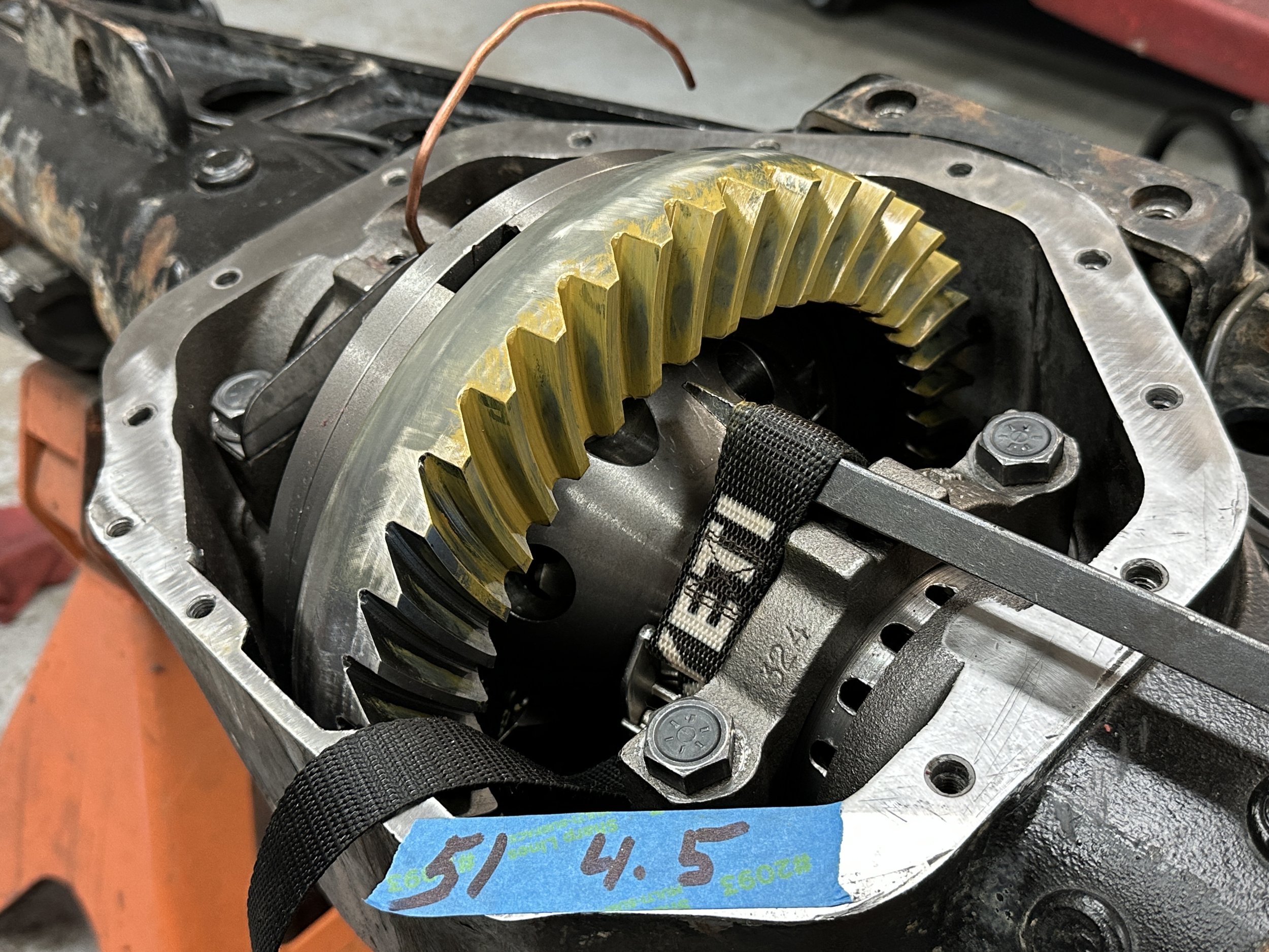

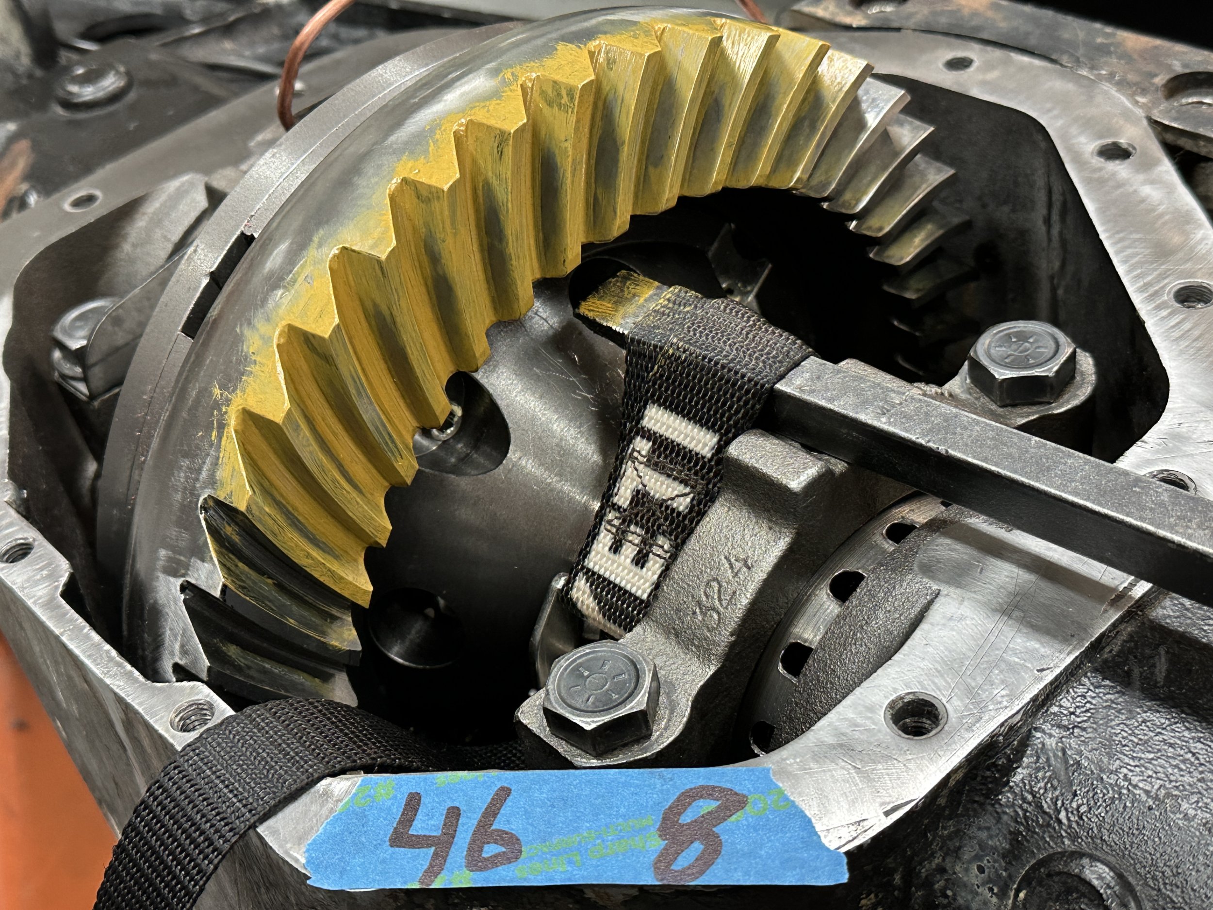

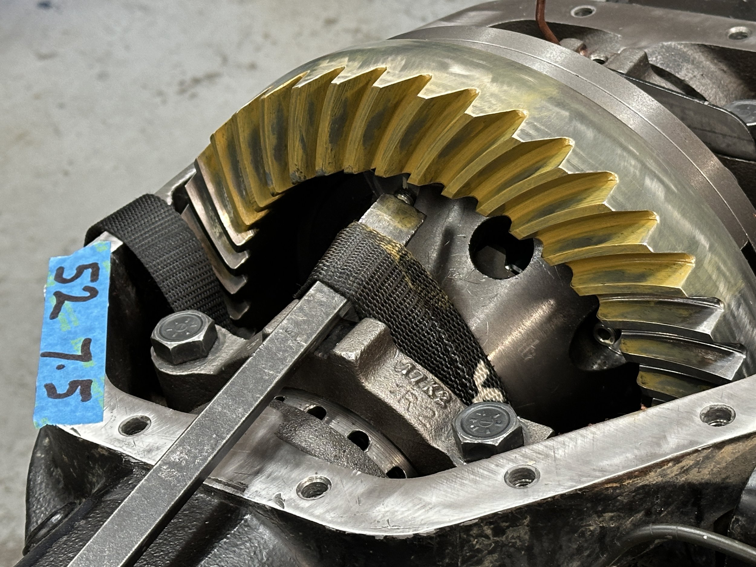

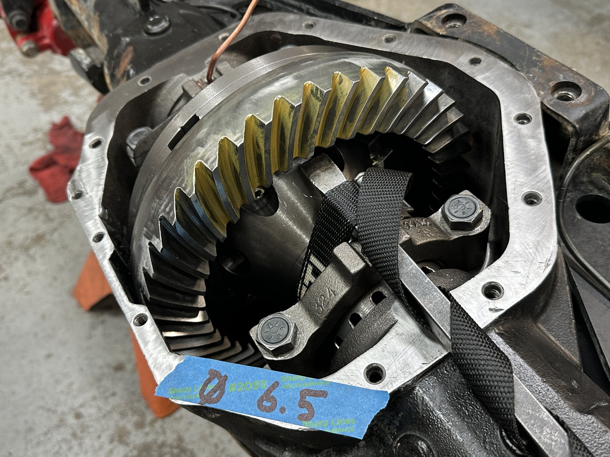

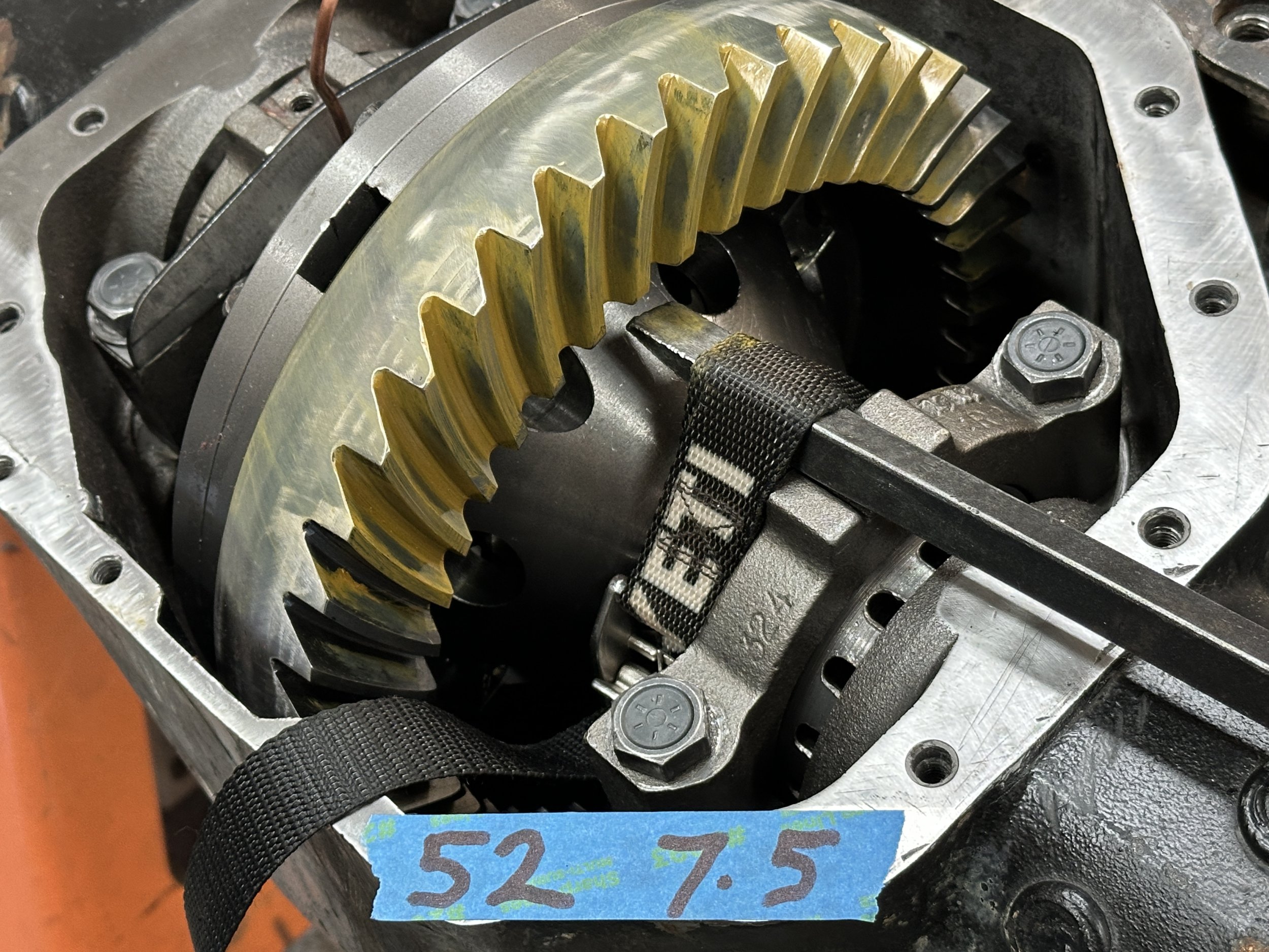

OK - added 1 thou to go shallower: 50 thou shim and 4.5 thou backlash:
I don't think I can get any better on the coast side:

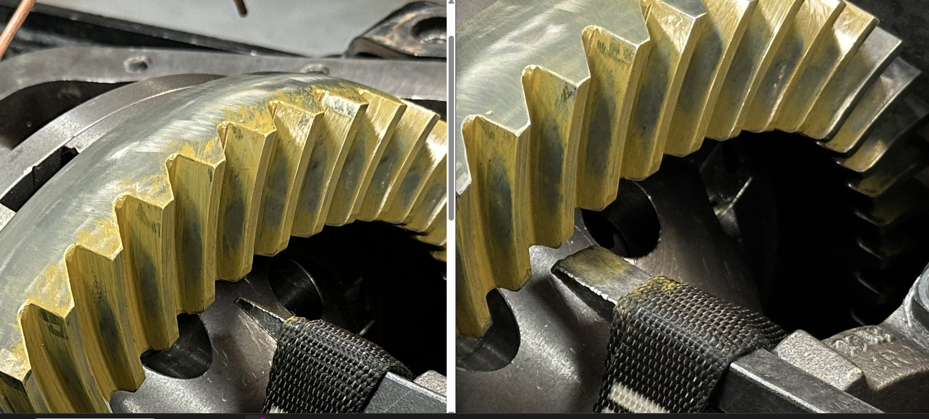

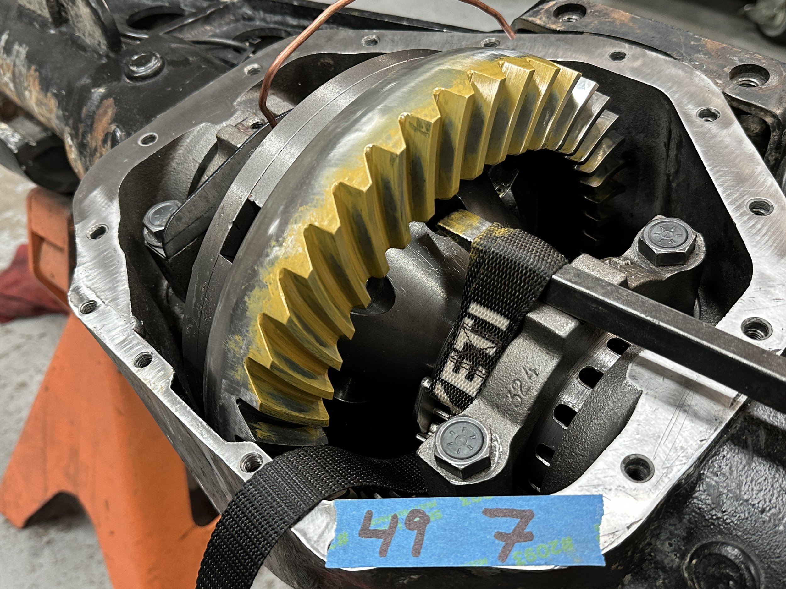

And comparing the drive sides of the 49 7 and the 50 4.5 - it looks like the pattern is just a bit more centered heal to toe on the 50, but still appropriately on the deep side as I'm trying to achieve.
Mikey? ( @hosejockey61 )
Sorry for the delay, getting my ass kicked at work today. I agree, I think you are there. Let us know what Ben thinks as I'm curious.
