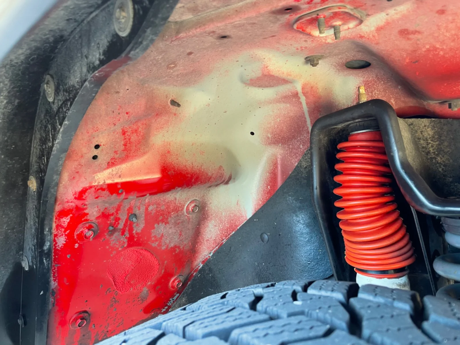

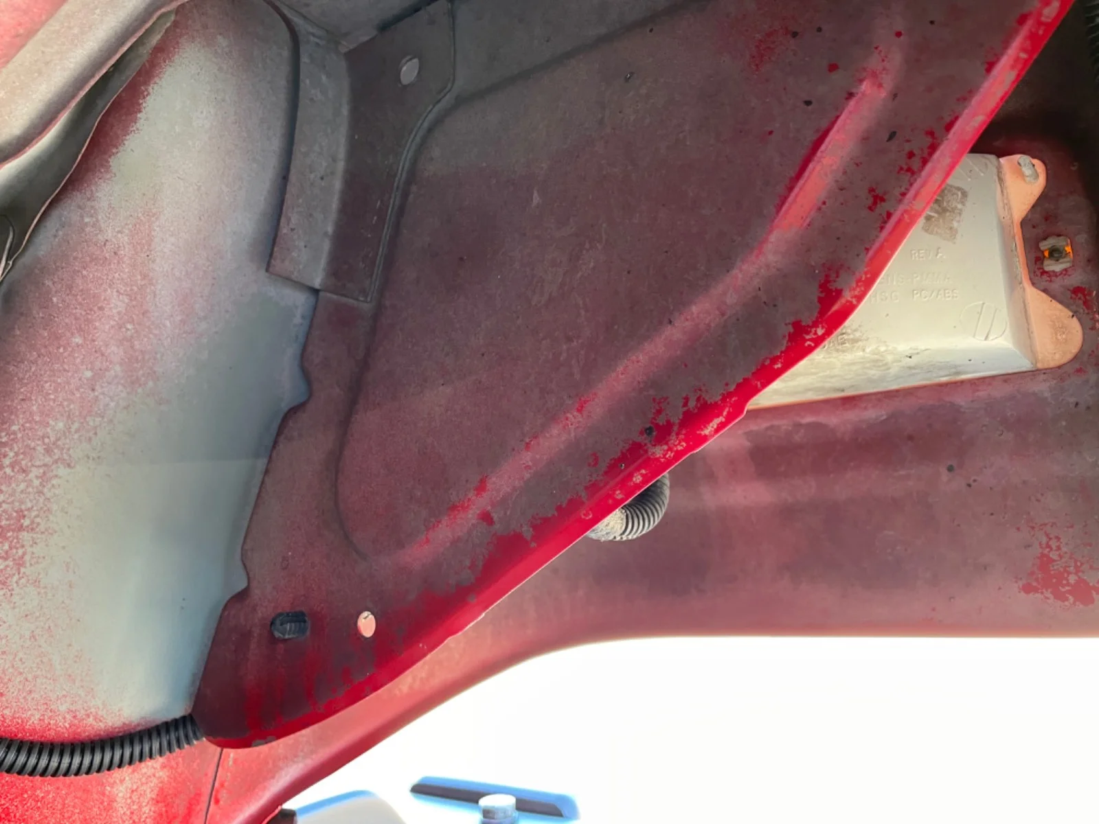

Hello! Thank you in advance for your help. I was looking at a 2000 Wrangler Sport. 108k miles. Had the Jeep inspected and report came back with:
The underside shows areas of minor surface rust. Attached pic.
Also, as for paint condition it said:
I noted some rock chips on the front end. I noted wear and some overspray. Attached pics.
I just want to know if these are normal and nothing to worry about or red flags to walk away from sale.

Would need more pics of frame. I'd stick your fingers in there anywhere you can and see if it's smooth, rough, or full of chonky chonks

I'm not sure what to think about the paint on the hinge & wheel well, but everything else looks pretty good. Does the red match the original paint code? Definitely peel back the carpet all over and see what's hiding there and follow all the other "buying a TJ" guide steps.
He's got a transfer case drop, so he probably had some driveline vibrations at one point. I'm guessing there's a lift with what appears to be like new springs & shock boots so the lift may be recent. I can see there's no SYE, likely no adjustable arms, which caused his vibes. So why did he lift it only to turn around and sell it right away?
I'd probably buy it based on what you've told us, but I'm also curious about the asking price, and of course the caveat that I only know what you've told us.
It almost looks like it was repainted , and the original color was either white or silver. The shocks don't match front to rear, but that is something inexpensive to correct.

A good cleaning and some satin black paint in the wheel wells would look good. but from the pics, it looks like it is just cosmetic.
