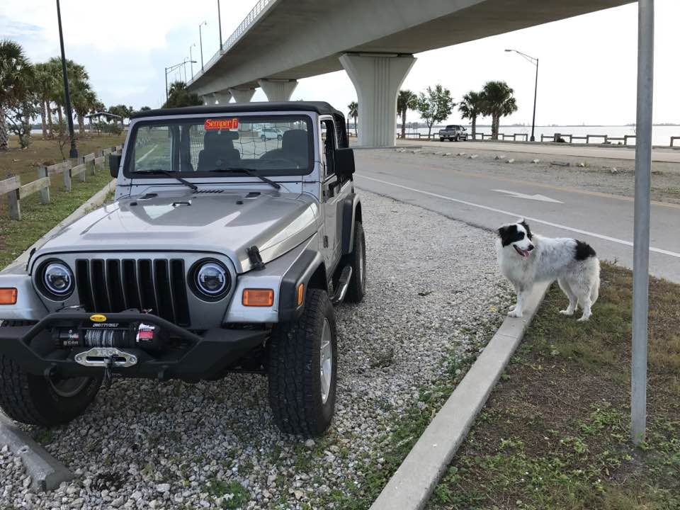

Okay... I've read the other threads, but not found the information I need. I have a 97 TJ which I had some mods done to when I bought it in 2016.. Among them is a 3" lift kit, wheels from a JK, new winch, bumpers, etc etc. Here's the 'Old Grey Mare' as she was a month before I left her at the Black Hills house and headed to Florida for the winter (actually pict is from when I bought it)...
Fast forward from 2016 when this pict was taken (looks weird without all the look where I've been decals LOL)...

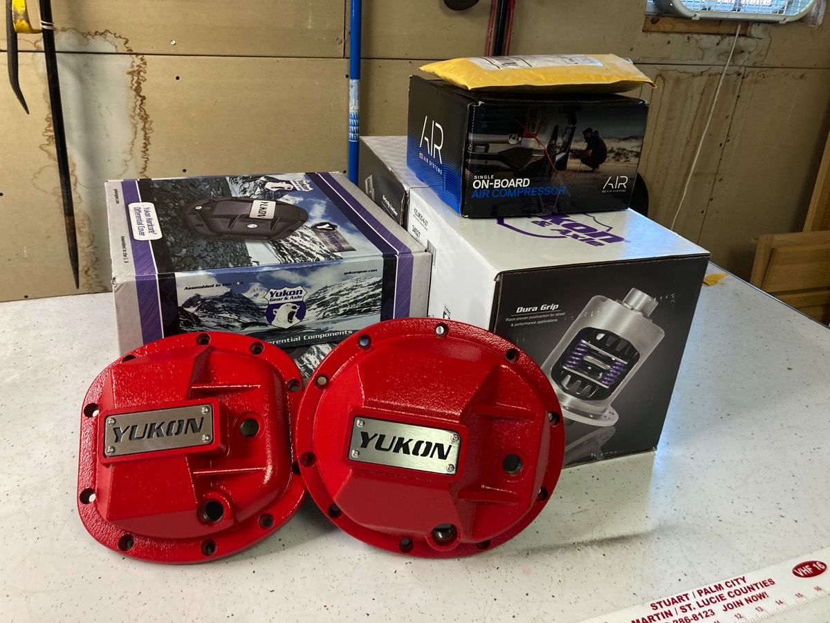

So before I left the old girl in South Dakota, I bought her some new trinkets: 4:56 gears, air lockers, and a complete overhaul kit for Dana 30 & 35 axles (not all in photo). This all should be completely installed shortly, I get there in May..

Did the PO install spacers and adapters for the JK wheels or did they swap axles and you have JK axles?

JK wheels have more backspacing, so with the JK adapter you're probably sitting right where a stock size tire would.
A larger tire would need additional spacing or a wheel with less backspacing to push it out.

Might just be the picture, or do you also need an adjustable trackbar?
