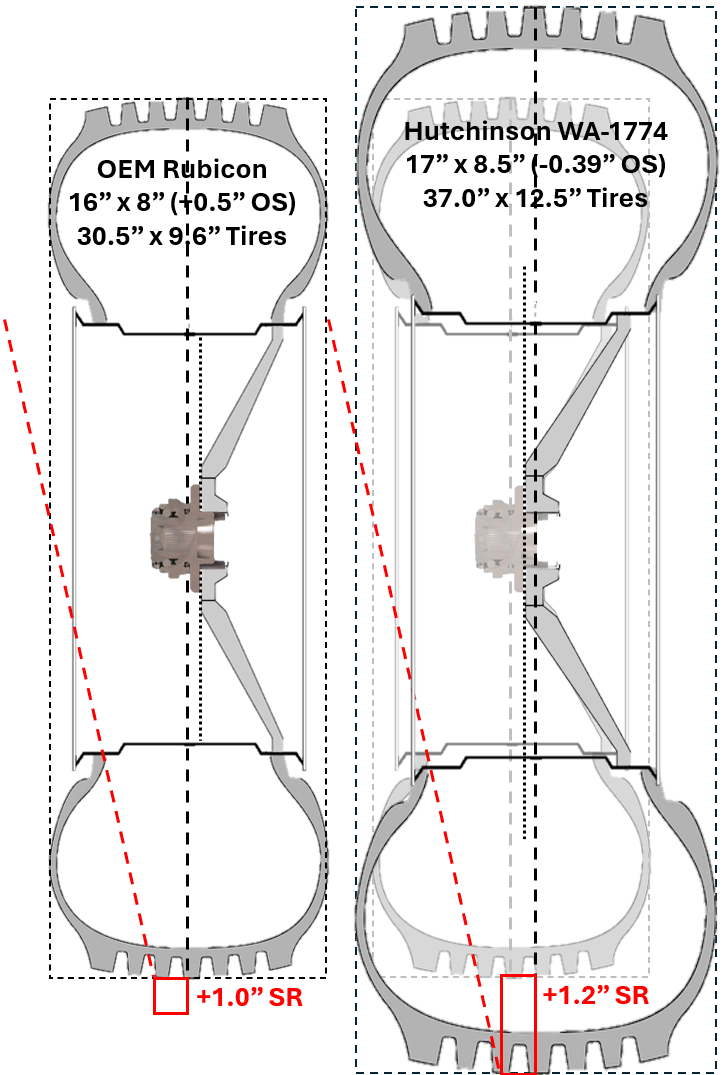

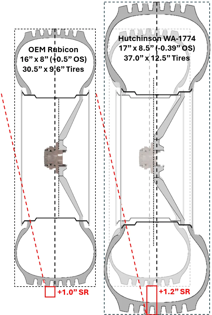

Here is also a diagram I made comparing OE TJ Rubicon Wheels/Tires to Hutchinson Rock Monsters with 37s that further shows the geometry. In this particular case the 0.89" reduction in offset (increased SR) along with the 6.5" larger tire diameter (reduced SR) yielded a net ~0.2" increase in SR. If you wanted to maintain the 1" SR on 37s you would want to find a -0.2" (~-6mm) offset wheel (on a 8.5" wheel that is 4.5" of backspacing). For a 35" the SR would be ~1.3" so ~-0.1" (~-3mm) offset (on a 8.5" wheel that is 4.75" backspacing). For other wheel widths offset remains the same but you would add 0.25" backspacing for every 0.5" of wheel width.
In theory a 35" tire on an 8" wheel with 3.75" (-18mm OS) backspacing would have almost 1.6" scrub radius. I think the reason why it is common is cause people sacrifice scrub radius for tire clearance. This is where a wider axle can help since it will give you the additional clearance without the need to sacrifice scrub radius.

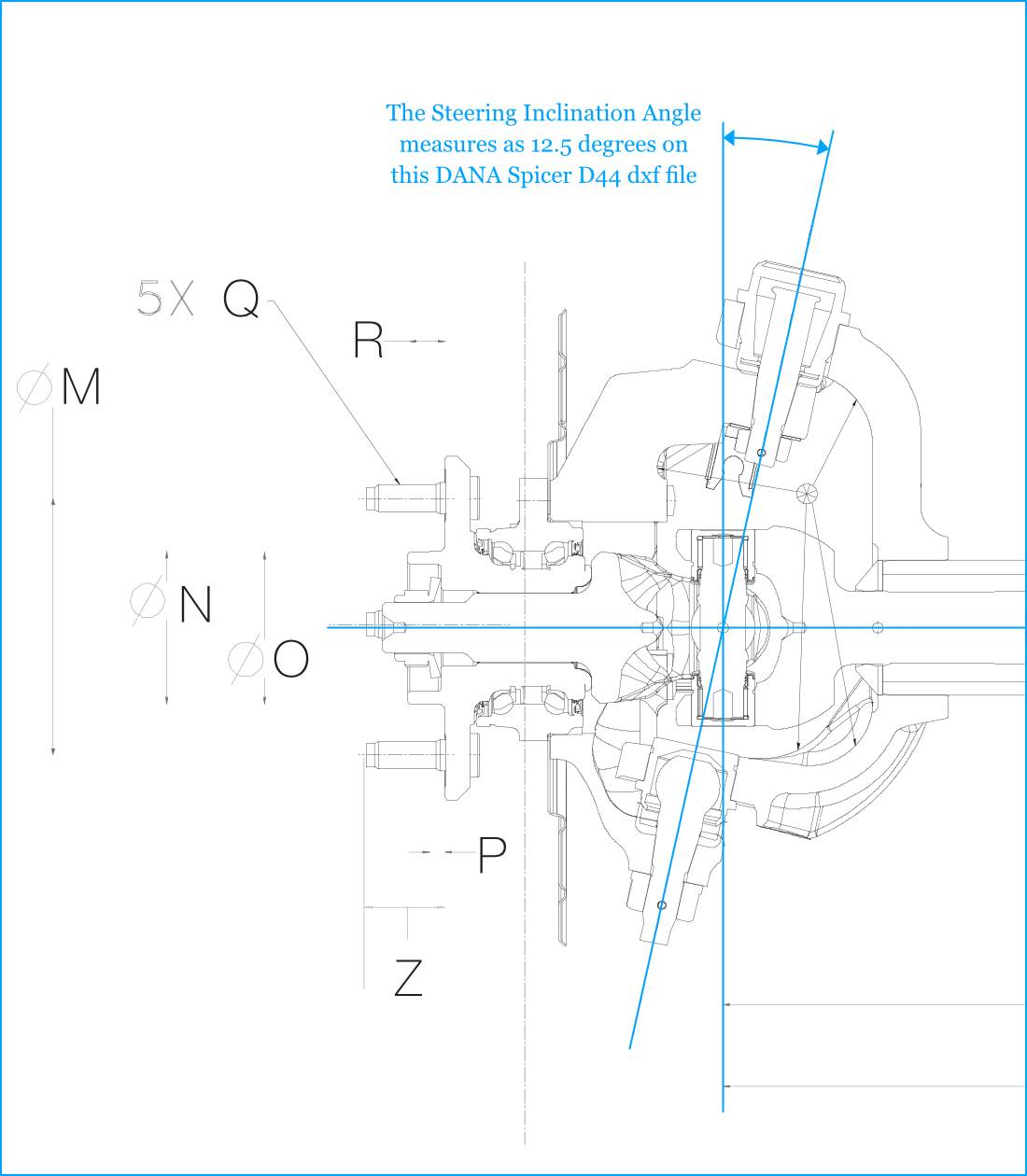

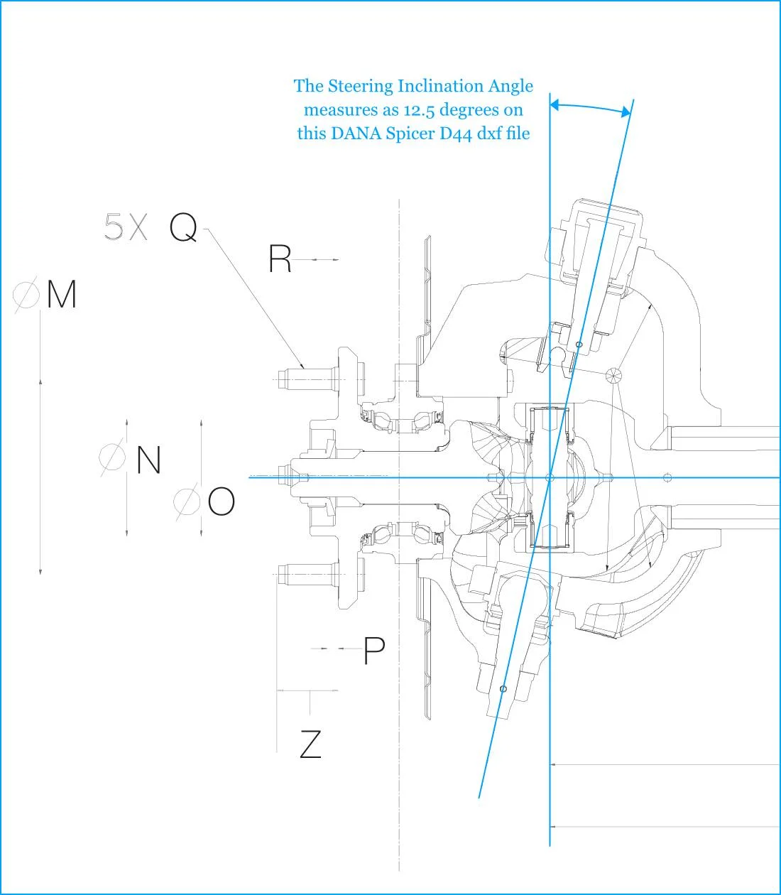

One caveat on my post above. I don't believe all Dana 44 variants have a 12.5 degrees steering angle inclination. Best to check your specific axle before doing the calculations.
