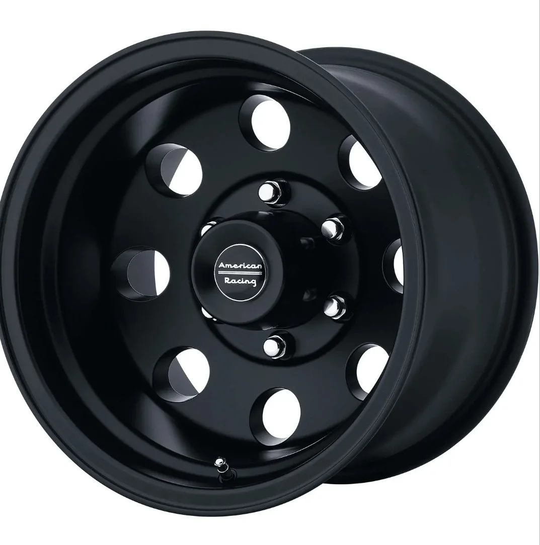

I'm in the market for some rims that will work with the large Yukon hub kit and 16" BBK.
I have a set of aftermarket rims but not sure if they'll work with the setup.
Concerns are wheel width and will the modified hub kit rotor fit within the wheel?
Rims are :
Brand: American Racing
Model: Baja
Part Number: AR1725785B
Color: Satin Black
Backspacing: 3.76
Offset: -6
Wheel Diameter: 15
Wheel Width: 7
Hub Bore: 108.00
Load Rating: 2000
Wheel Exposed Lugs: Yes
Wheel Material: Alloy
Weight: 16.71
Wheel Structure: One Piece
Wheel Style: Bullet
Bolt Patterns: 5x5.5
True Directional: No
Other Colors:
Satin Black
For reference I plan to run 35x12.5 tire
Look at what tire you want, the manufacturer will recommend the minimum width for the wheel.
7” is pretty narrow for a 12.5
Well if anyone needs some 15x7 rims open box never used, let me know : )
So it's doable but not likely recommended.
I have 12.5" wide tires on 7" rims. You might have a hard time finding someone to mount them, every place I called said they won't mount anything with over a 5" difference in the two. I had to have my friend that works at Big O do it for on the sneak.
Poor man's beadlocks tho

If they're the specs you posted above, they're the wrong bolt pattern for a TJ.
They are the specs and the bolt pattern will support the big hub kit up front (if installed) to support 5x5.5.

I'm poor or will be poorer after this hub kit project. I was hopeful since I already had these rims but now I'm not too hopeful on getting a set of tires mounted to them.
