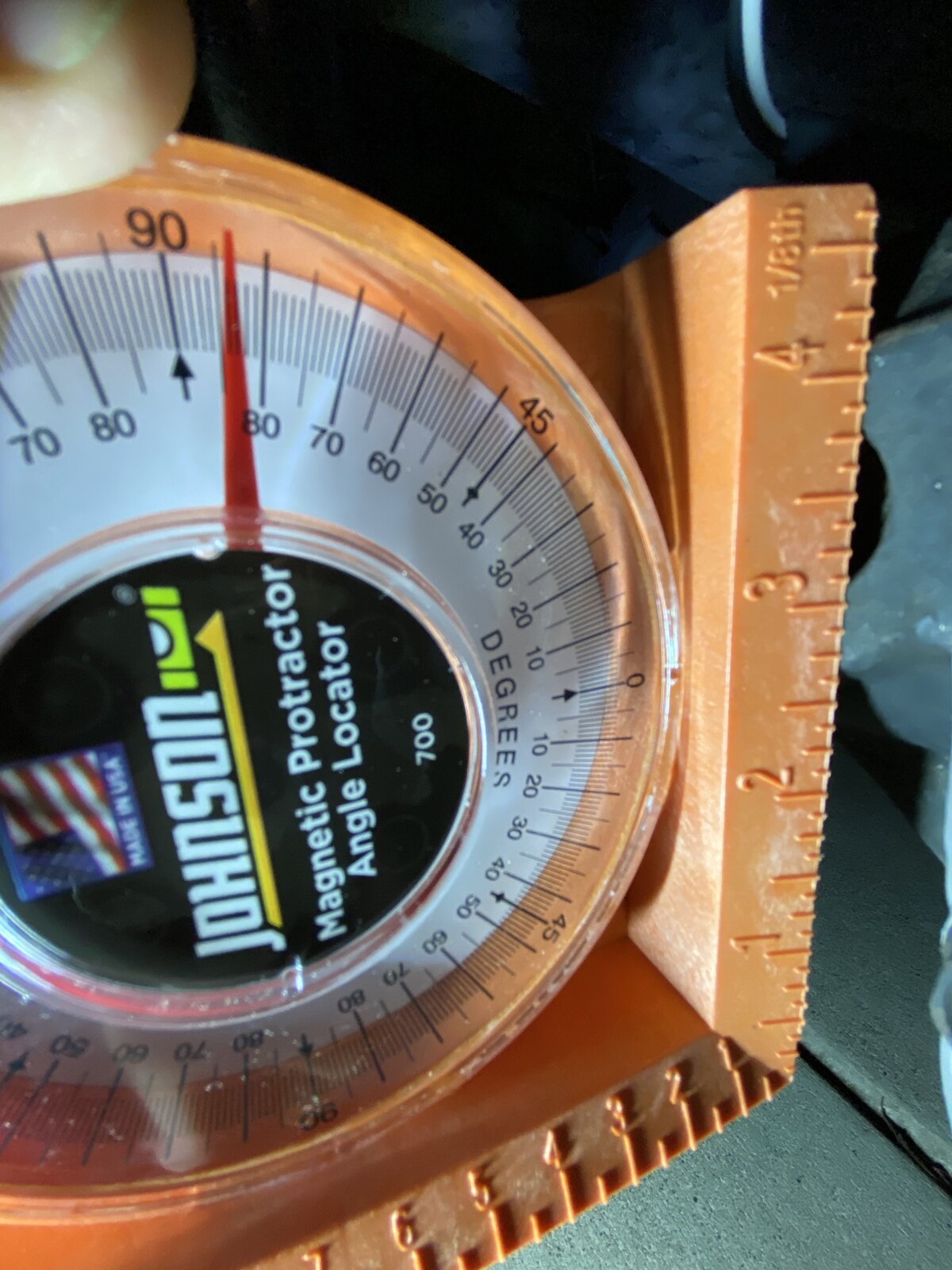

What are your shaft and pinion angles? An inexpensive angle measuring tool will work. Something like this is what I used.

The angle measuring tool arrived today, so I went out and made the measurements.
I’m seeing about 2.5 degrees on the shaft and about 6.5 on the pinion.
I would try to get those angle closer to each other. Mine are within a degree of being the same. I don't know why mine are equal with OEM non-adjustable control arms and a 3" lift. I needed adjustable upper arms in the rear to get the angles equal.

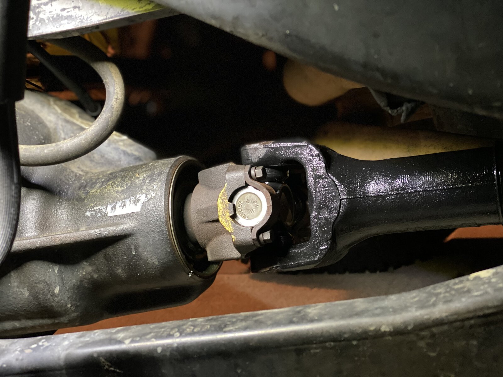

If you grab your front driveshaft while it's installed, is there any movement that can be felt if you push / pull on it? Most likely near the transfer case output yoke.
Reactions: khakitj
Yes, movement straight up and down (not sideways) at the tcase output.
That front transfer case output yoke nut was not torqued to spec. Tightened it up, now no more movement!
That may have reduced some of the subtle vibration I was seeing around 40mph but it had no effect on the heavier vibration at 70+.
