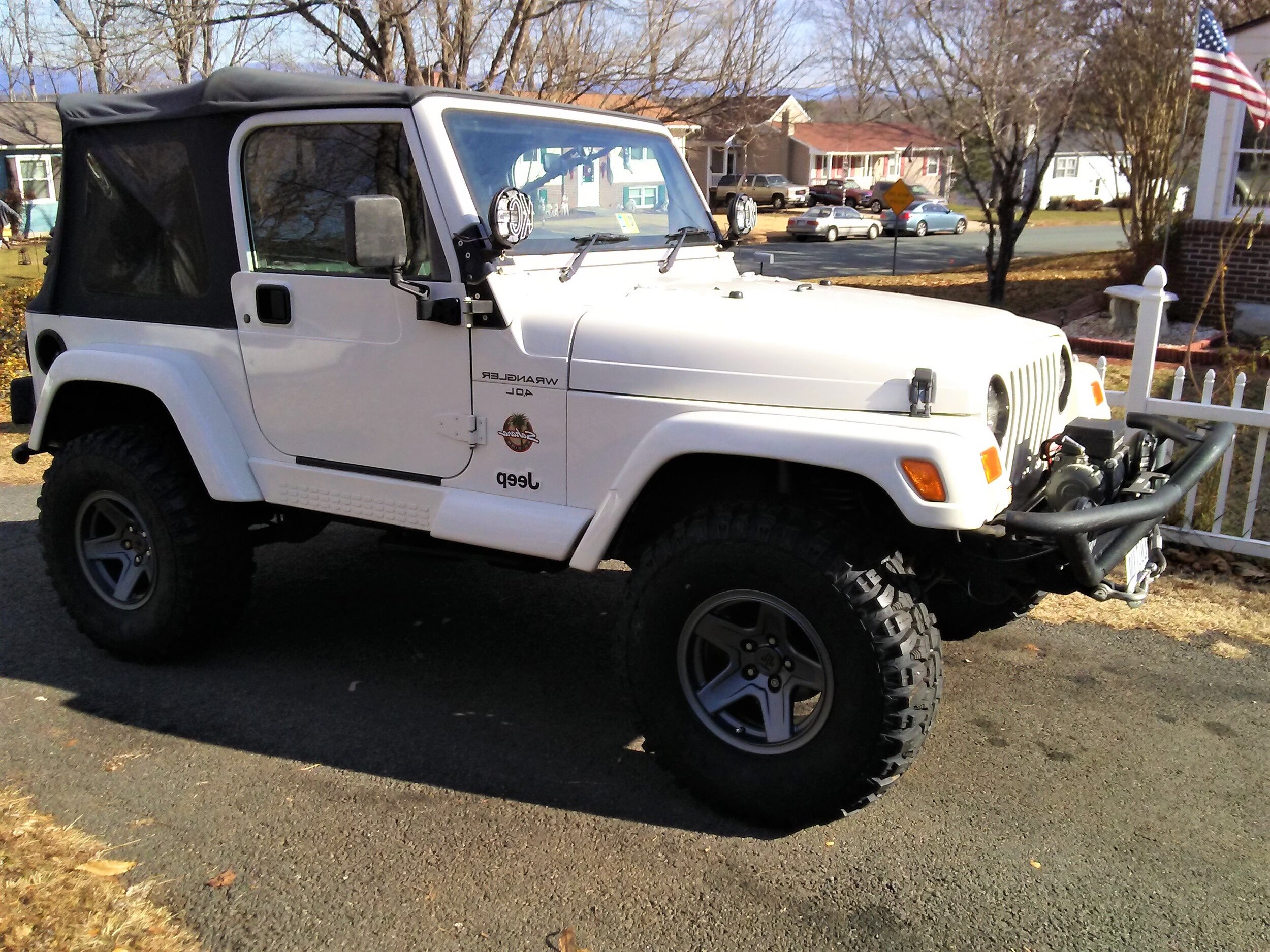

Add a BL for 33s, unless it's for the street only. 15x8" wheels with 3.75-4" backspacing is common. You can use your stock wheels if you go with 33x10.50" tires.
https://wranglertjforum.com/threads/offset-or-backspace.75885/#post-1471184

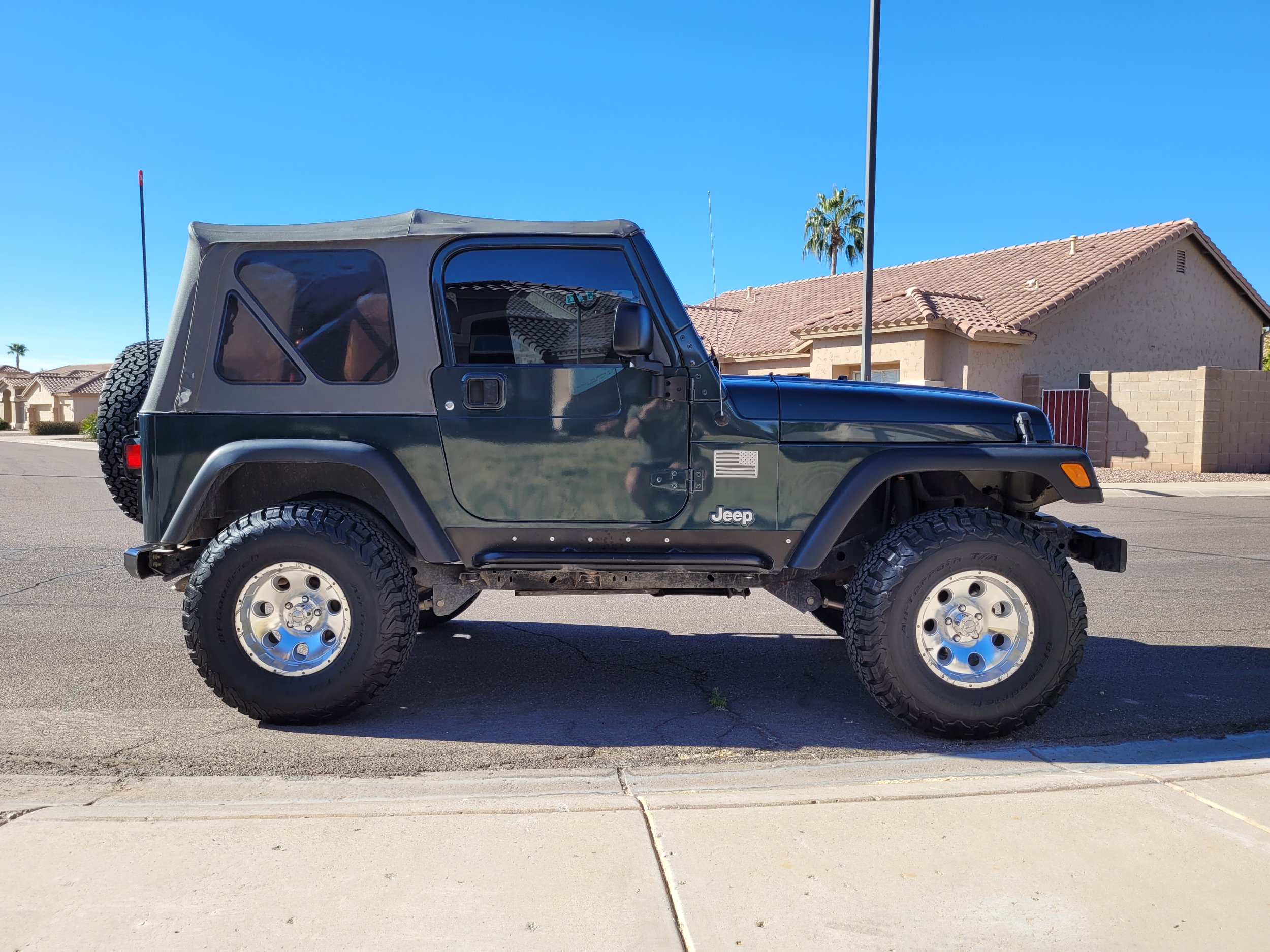

FWIW:
3" lift
rims:
existing: American Racing ATX Series Mojave AX3981 Teflon 15x8 (sadly, AR doesn't make 'em anymore)
backspace: 3.75"
bolt pattern: 5 x 4.5/5 x 114.3
hub center bore: 71.5mm
offset: - 19mm
spare rim: American Racing BAJA 15x8 — https://www.americanracing.com/amer...3AWsCpmfawv33bLA21i9CdT_KOGN4UkVmLM2PcVLKIRhz
backspace: 3.75"
offset: - 19mm
hub center bore: 83.06
tires:
existing: Mickey Thompson Baja ATZ P3 33x12.5 R15
next (because M/T doesn't make the ATZs anymore): M/T Baja Boss 33x12.5 R15 LT or M/T Baja Legend EXP 33x12.5 R15 LT
https://www.mickeythompsontires.com/light-truck-tires/baja-boss
https://www.mickeythompsontires.com/light-truck-tires/baja-legend-exp

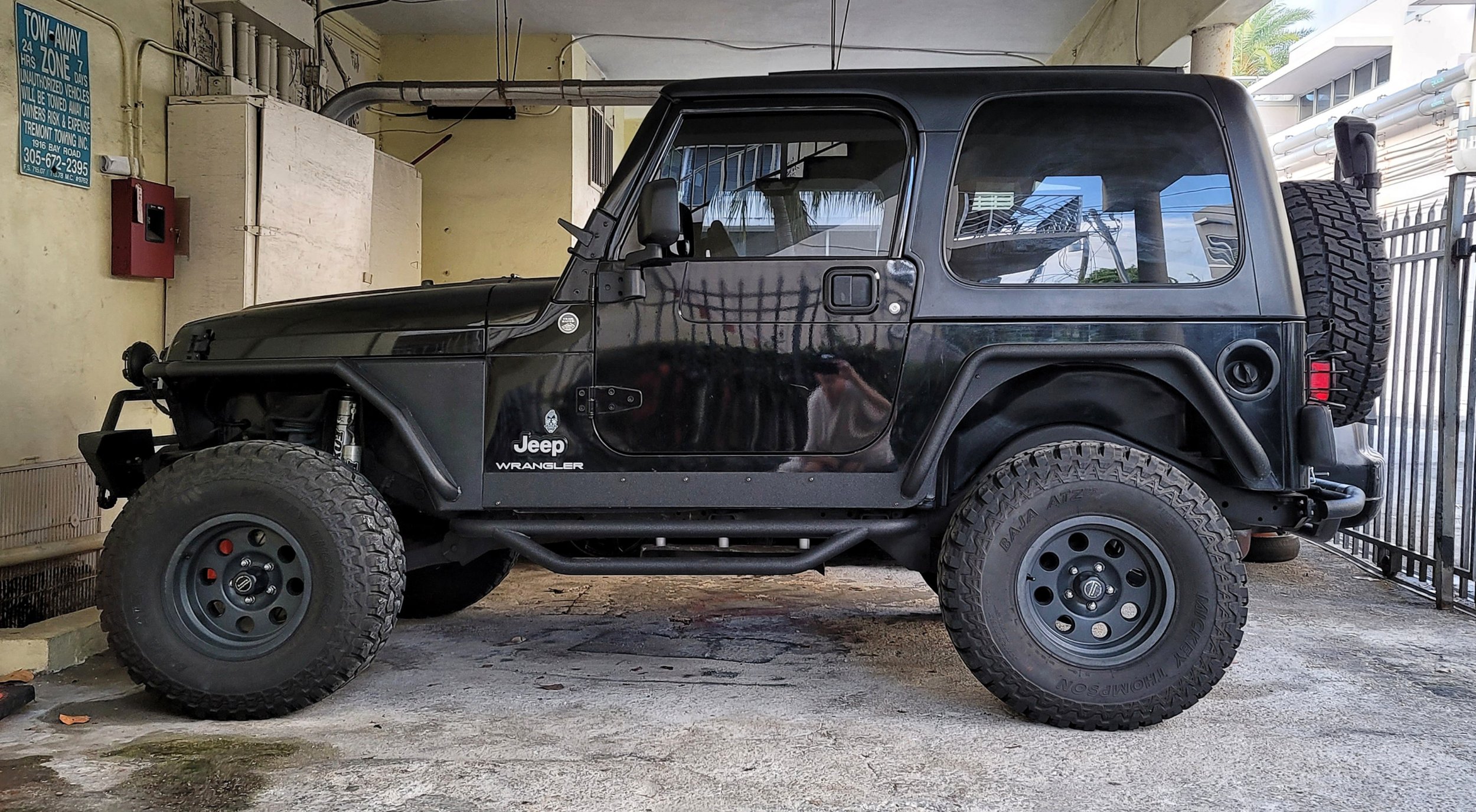

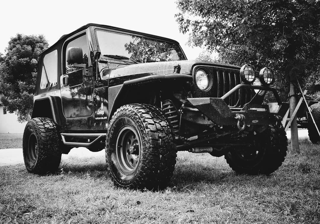

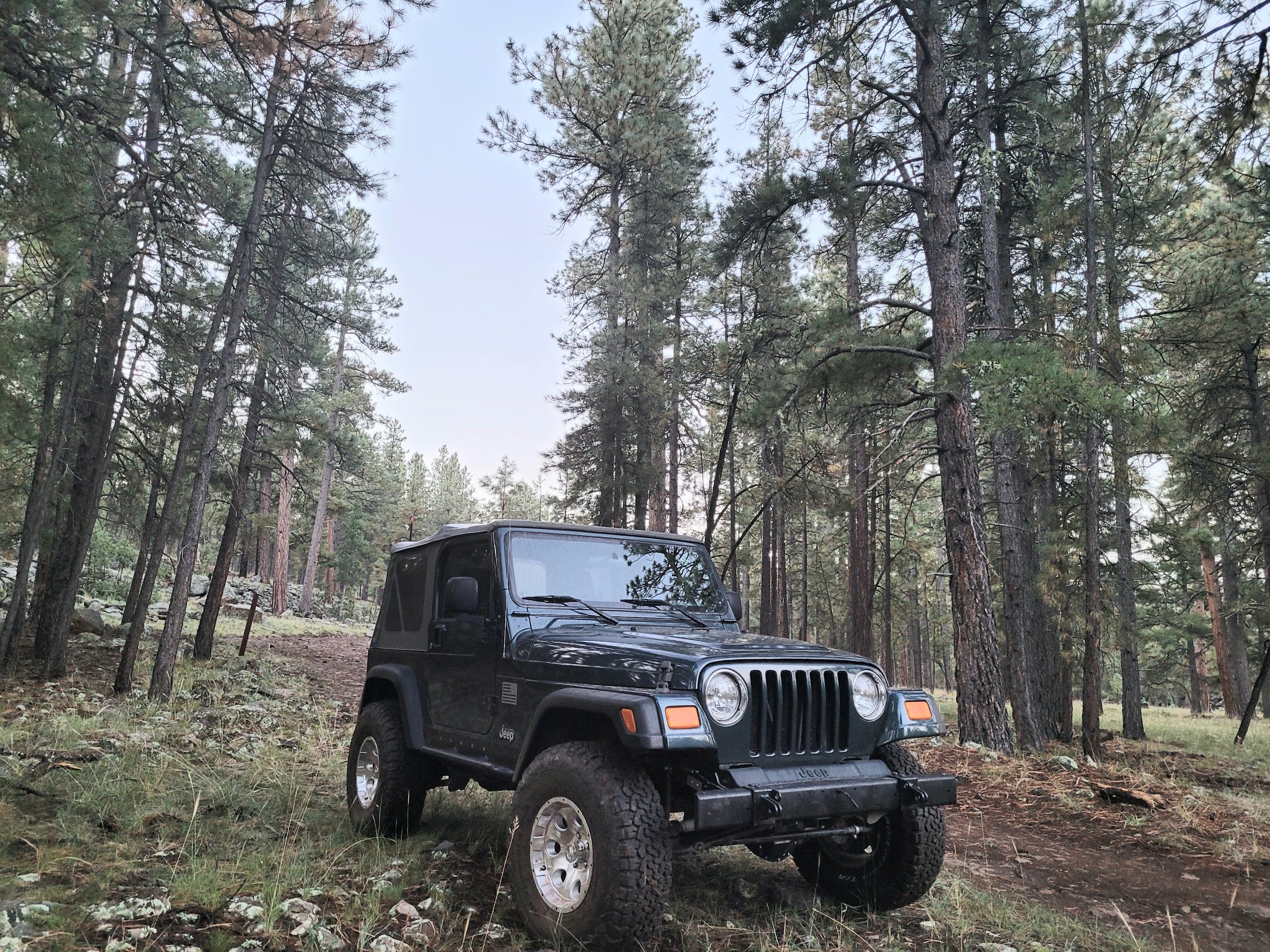

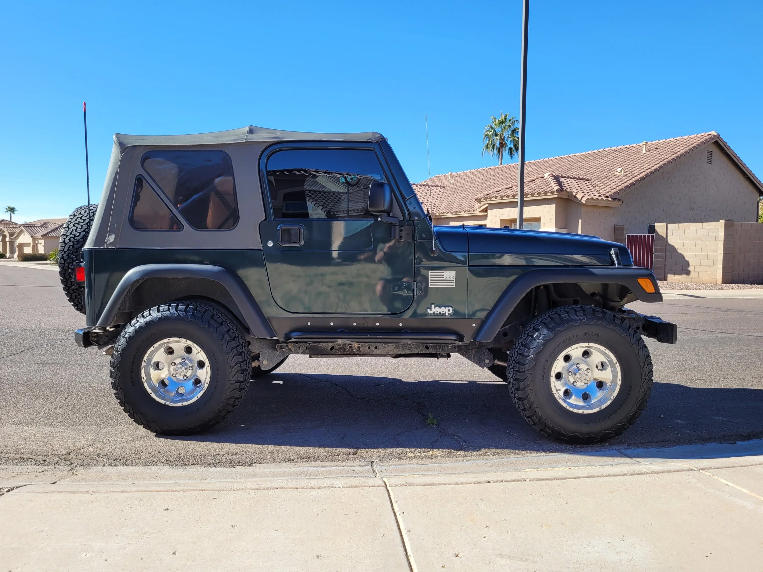

33x10.5 r15 KO2s
15x8 MB Razor wheels, 3.75" backspace
2.5" spring lift (closer to 2.7")
1.25" body lift
As others have said, if off-roading, you'd be wise to add a body lift if going to 33s.
