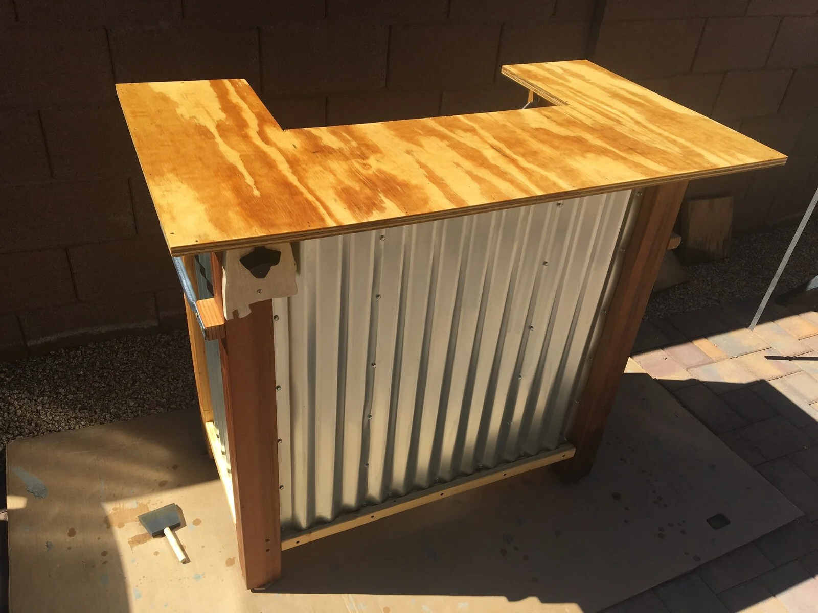

@Chris If you go looking for lumber and get disgusted by the lumber quality of the “big box” stores, try these guys in Phoenix.
https://www.heldtlumber.com/
I found great quality 4x4s when I built this portable bar for my son’s NASCAR camp.

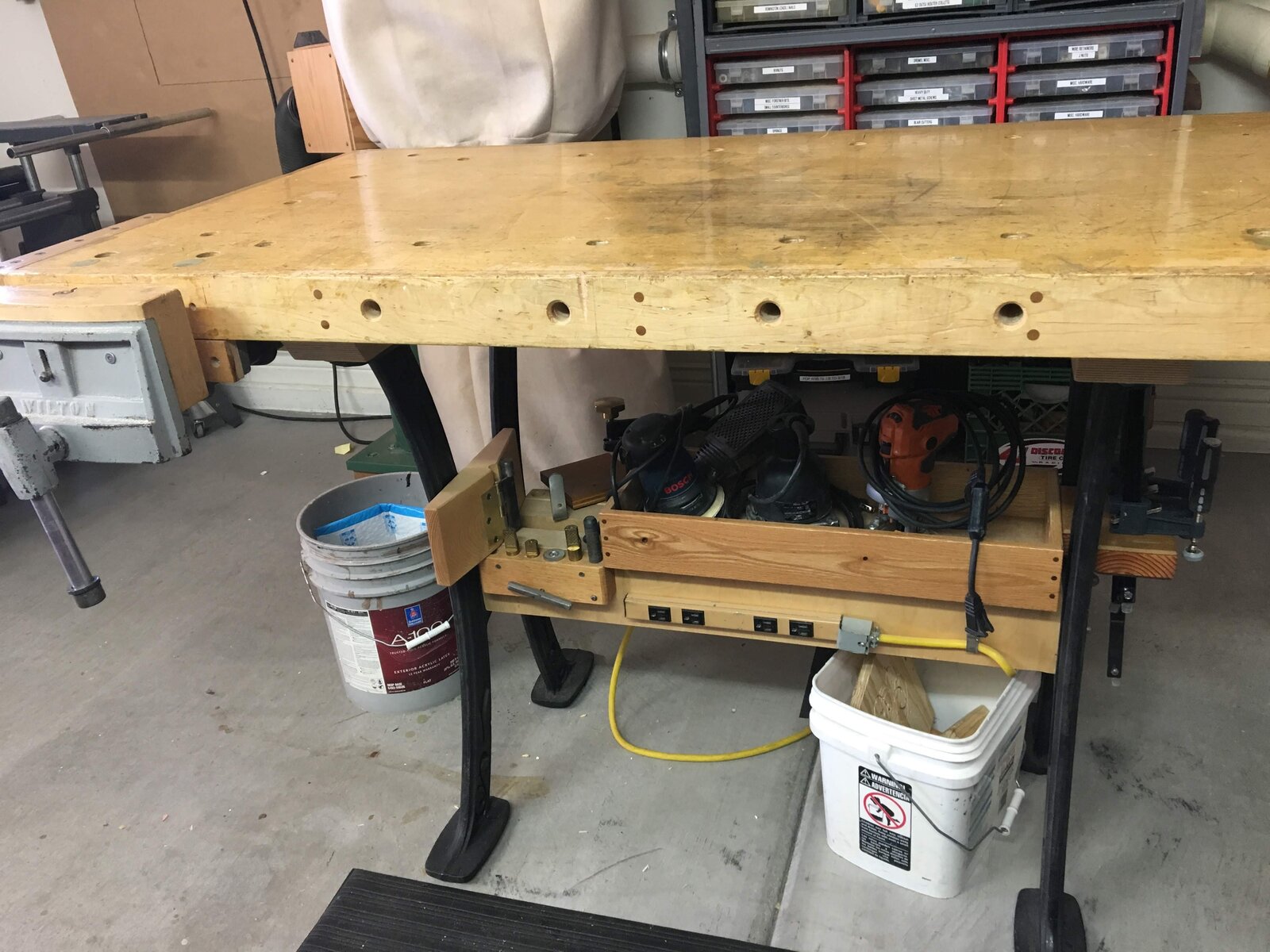

Four layers of 3/4 baltic birch plywood laminated together on some really cool (IMO) cast iron legs.
I can chop a 1/2” mortise in oak and I assure you there is no deflection.
The mass of this bench holds it in place during hand plane work as well.

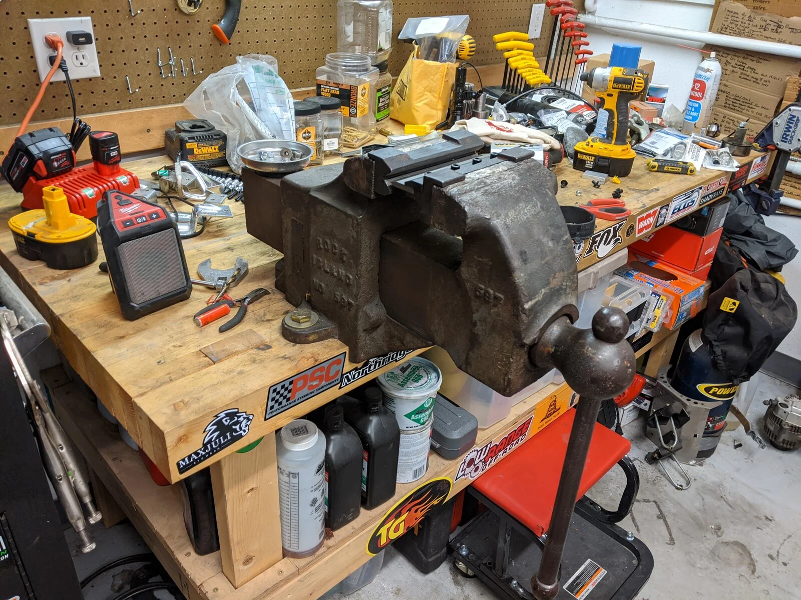

Another option is to order a piece of butcher block (HD has online) counter and some decent steel legs from Amazon. The butcher block in maple makes a real nice hard work surface and is not overly expensive, a 6 foot section ran me $249.

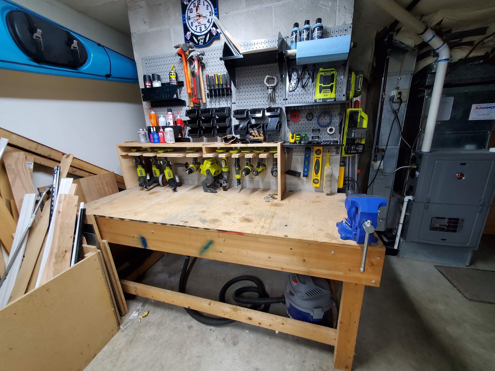

I ended up making my own with a butcher block top made out of 2x4's, then layered some mdf on top. I can sand down the mdf or replace easily and with the 2x4 constructed top, it weights a ton, doesn't move, and I can pound on it with a sledgehammer if I want. It's lasted 20 years so far.
I saved your picture from another thread you posted it in. I like that cordless tool hanger and may try to do something similar. 👍

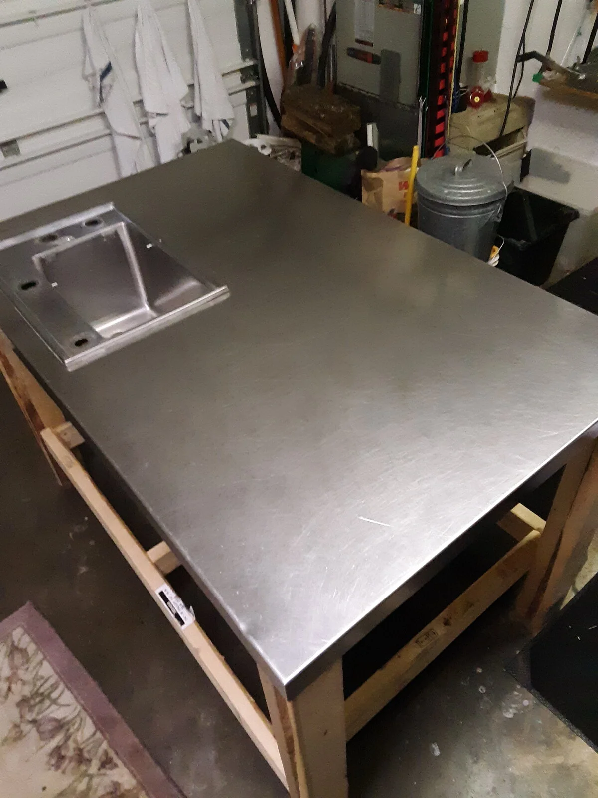

My work bench was built as a layout table for McDonnell Douglas, guessing around the 50's, 4 ft. X 12ft., 4 X 4 legs, 2 X 6 framing at the perimeter, 1" plywood on top with a one piece 1/8" plate steel top, plenty of 2 X 4 cross bracing. I've had it for close to 45 years and its going strong, beat on it, weld on it, will probably be an item in my will. Make them out of the best material you can fit into your budget, and fit into your available space, as they say, buy once and be happy forever. ( not a one person item to move )

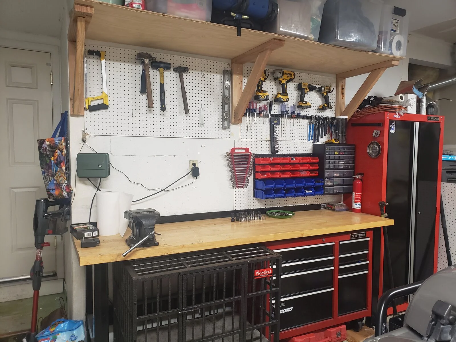

I need suggestions on a solid work bench which has some weight to it and preferably isn't made with a cheap, thin metal base.

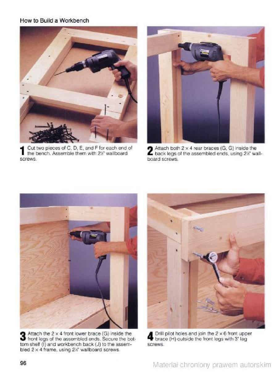

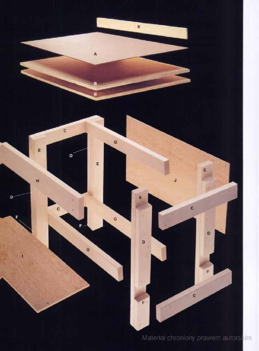

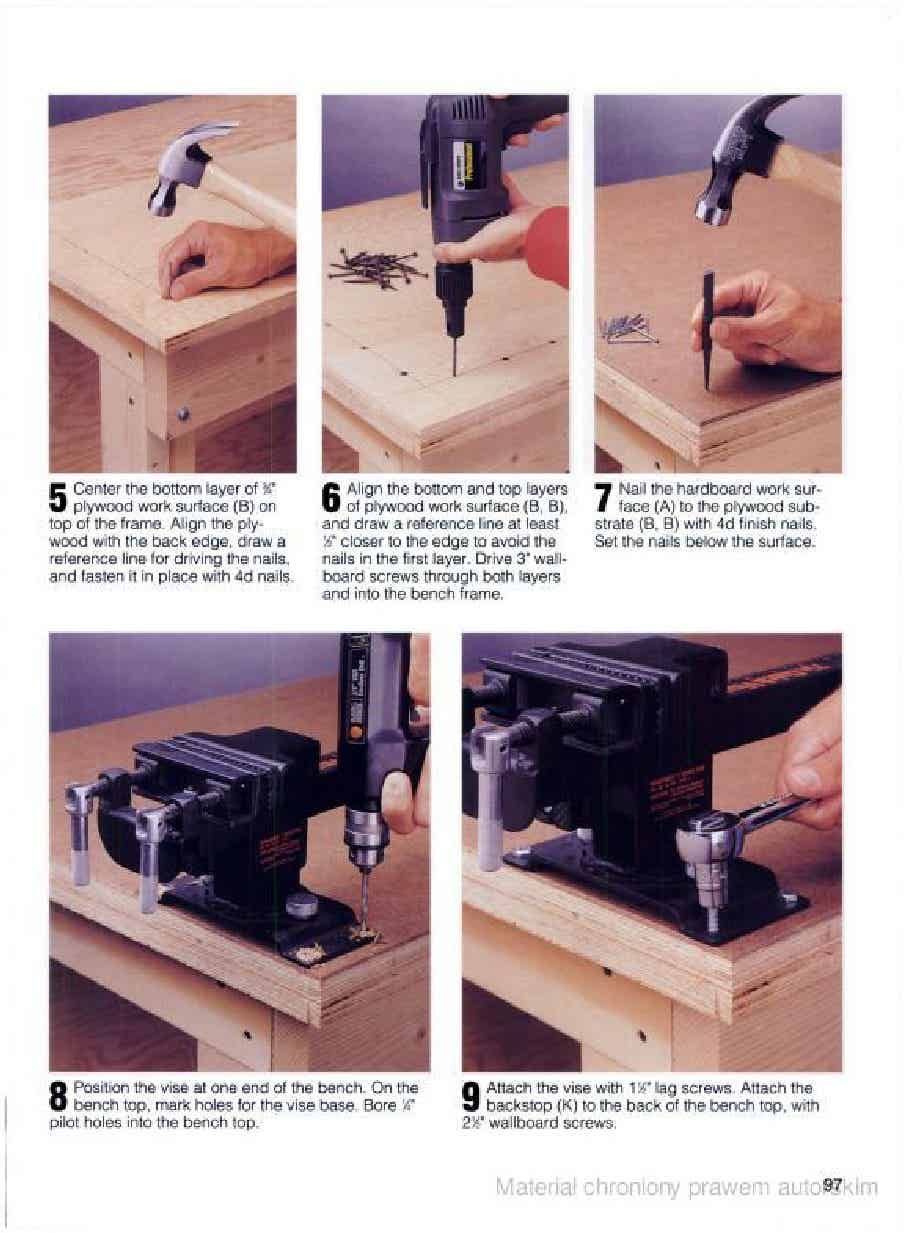

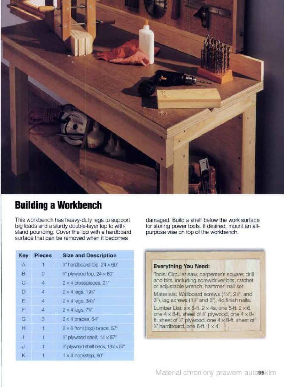

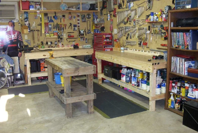

I made 2 of my own about 14 years ago using these plans. I strayed from them a little on the length. I made them 8 feet long each. Super simple to build and a sturdy/heavy as hell. They have been pounded on for years.
My son used the plans and made a 4 foot long one 5 or 6 years ago.
I wish I had made the bottom shelf about 1/4” higher though. If I had, I could slide a gallon cannot paint under them instead of putting them on the shelves.
I have some actual pictures of them that I can post when I get home from work.
View attachment 203883View attachment 203884View attachment 203885View attachment 203886
Here's a picture from 2005 when I built them. The red tool box is gone and they are slid together in an L shape. Still look the same just a little more worn and a lot more cluttered.
