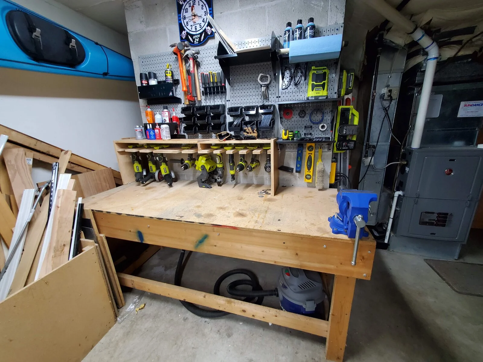

I ended up making my own with a butcher block top made out of 2x4's, then layered some mdf on top. I can sand down the mdf or replace easily and with the 2x4 constructed top, it weights a ton, doesn't move, and I can pound on it with a sledgehammer if I want. It's lasted 20 years so far.

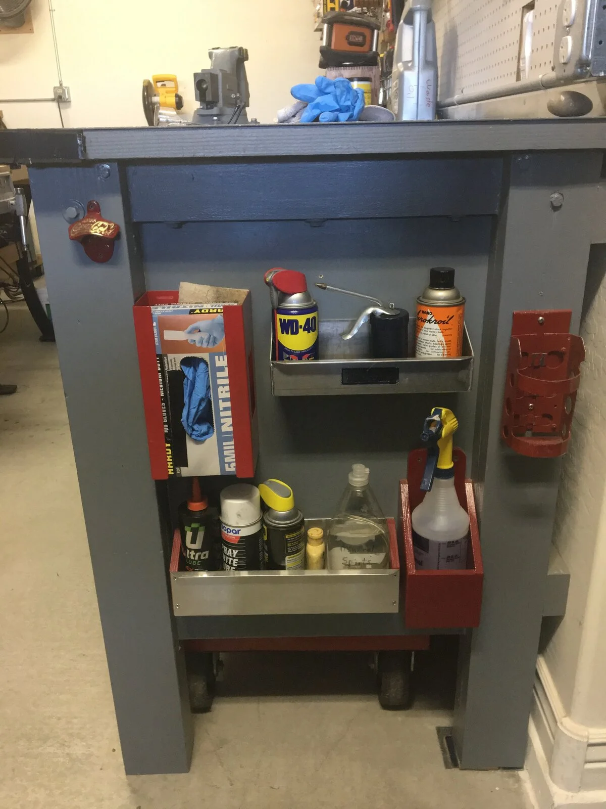

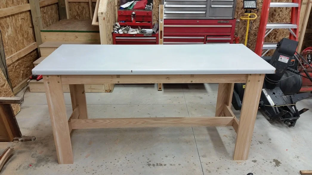

When I built the AZ house bench I knew I wanted my work box under the bench. I also wanted the bench top height to match the cabinets to it’s left. These criteria meant I’d have to build my own.
I couldn’t find decent quality (straight) 4x4 at the time I was building so I laminated my legs out of 3 Douglas Fir 2 x 4s. Two glued face to face and the third 2x4 face glued and screwed to the doubled edge.
I ran the legs thru the table saw to clean up the edges during lamination.
The metal top was ordered thru HD. Under most of the top is a layer of 2x6 and plywood.
You can see the edge of the 2x6 frame in this pic as well as the 1/2” plywood shear panel that is rabbeted in to the legs. This feature really helps kept the bench from racking.
Even with all the mass in this bench I could still move the bench if I really reefed on something in the vise.
I couldn’t drill into the floor to secure the bench because the house was constructed with a post tension slab. I added the two 2x4s to space the bench away from the Stem Wall and lag screwed the whole thing to the wall framing.
Now it’s solid!

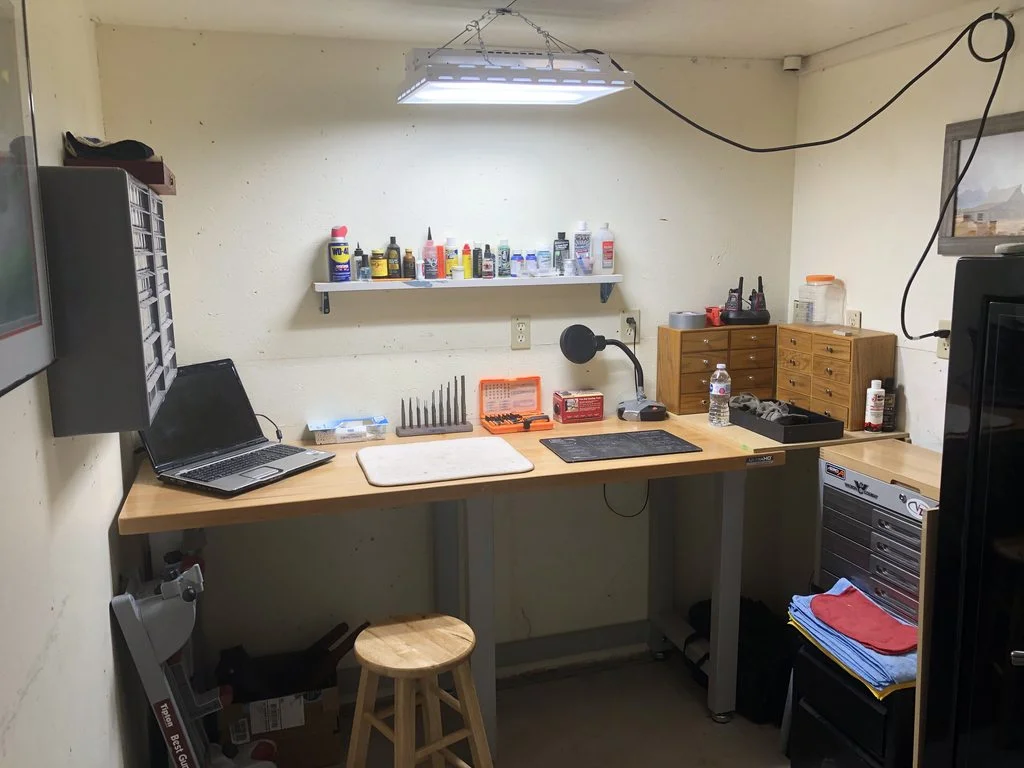

This is the one I have in my gun room. It is a real sturdy metal base with a 1.5 inch thick butcher block top. This thing weighs a ton and is a solid as can be. I bought 2 of them at Sam's club. My wife has the other one in her craft studio. The brand is Seville Classics. You can also get a rolling stogare cabinet with drawers the will fit under one side of it.

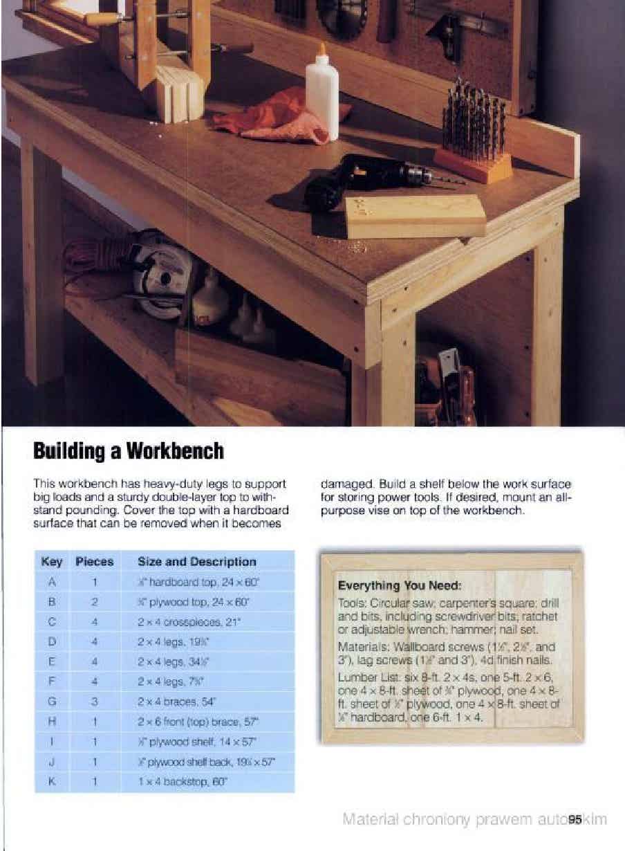

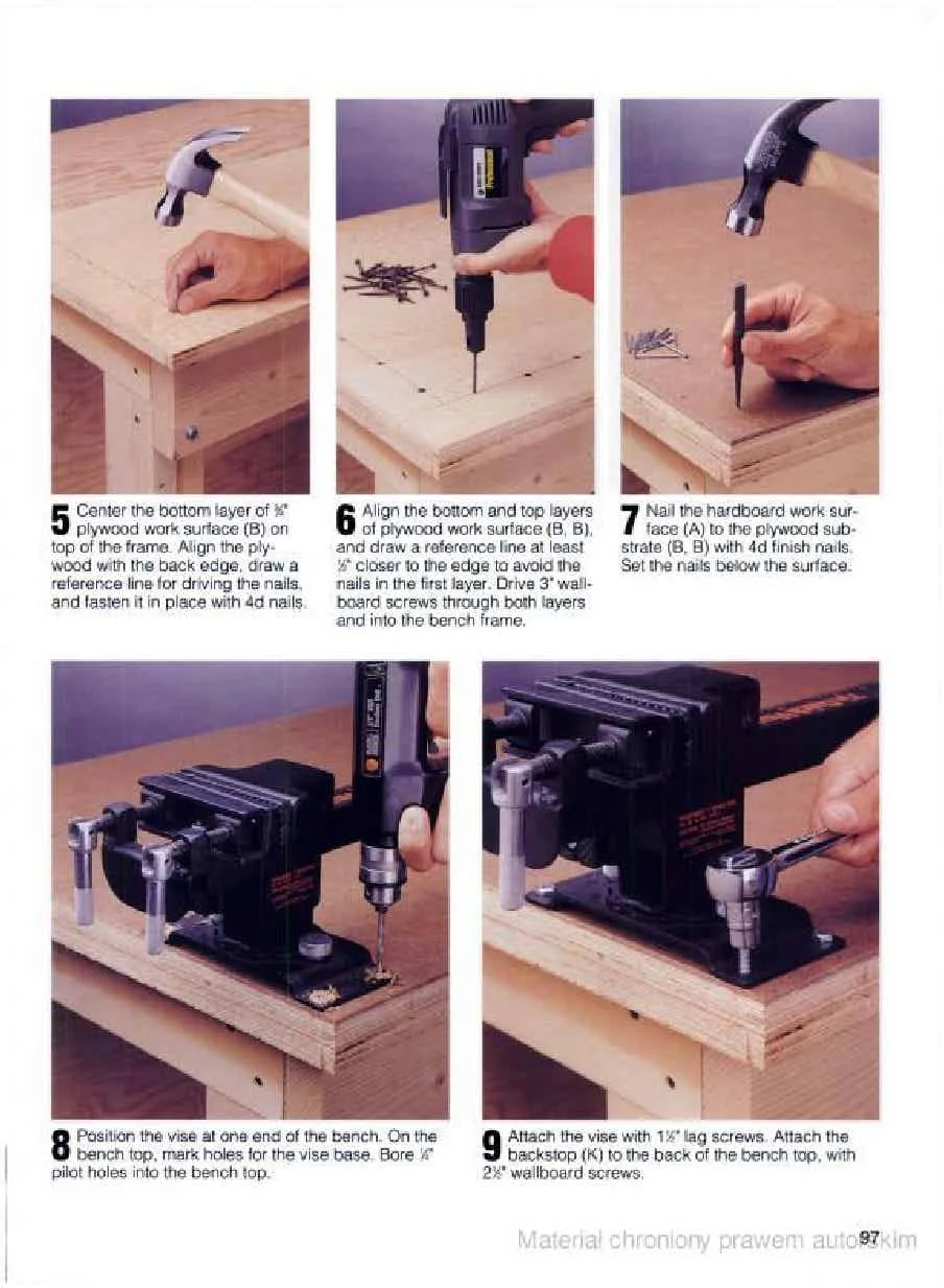

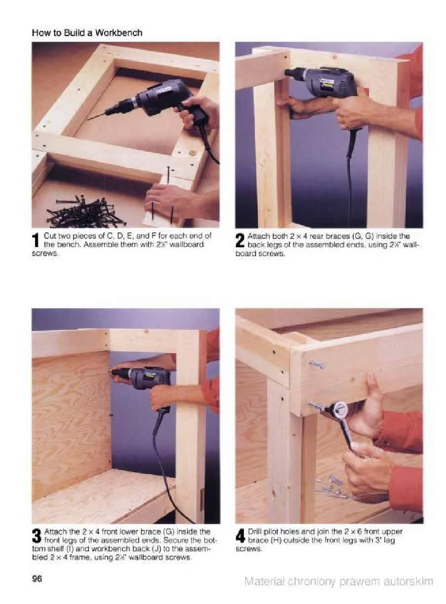

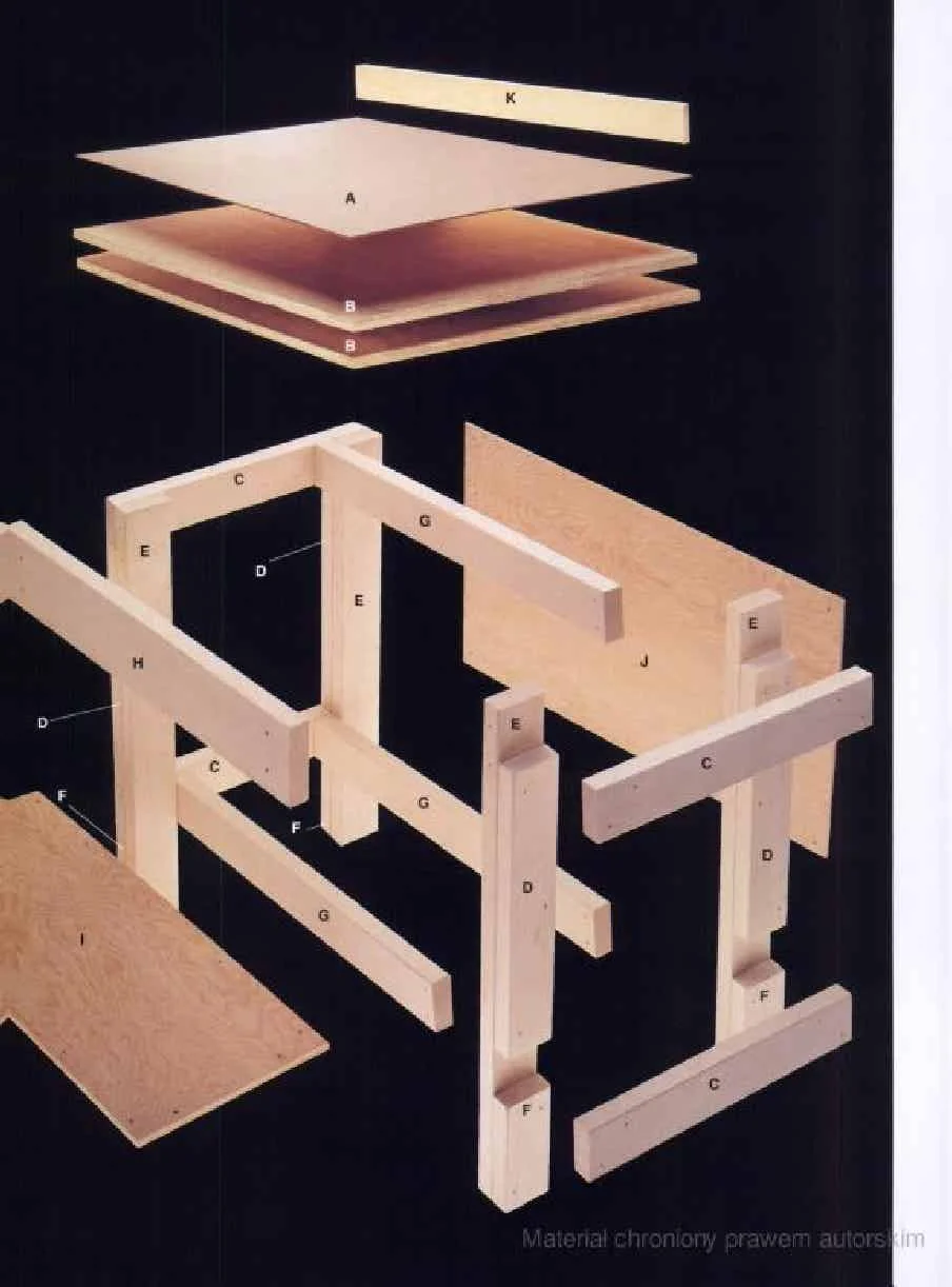

I made 2 of my own about 14 years ago using these plans. I strayed from them a little on the length. I made them 8 feet long each. Super simple to build and are sturdy/heavy as hell. They have been pounded on for years.
My son used the plans and made a 4 foot long one 5 or 6 years ago.
I wish I had made the bottom shelf about 1/4” higher though. If I had, I could slide a gallon of paint under them instead of putting them on the shelves.
I have some actual pictures of them that I can post when I get home from work.
