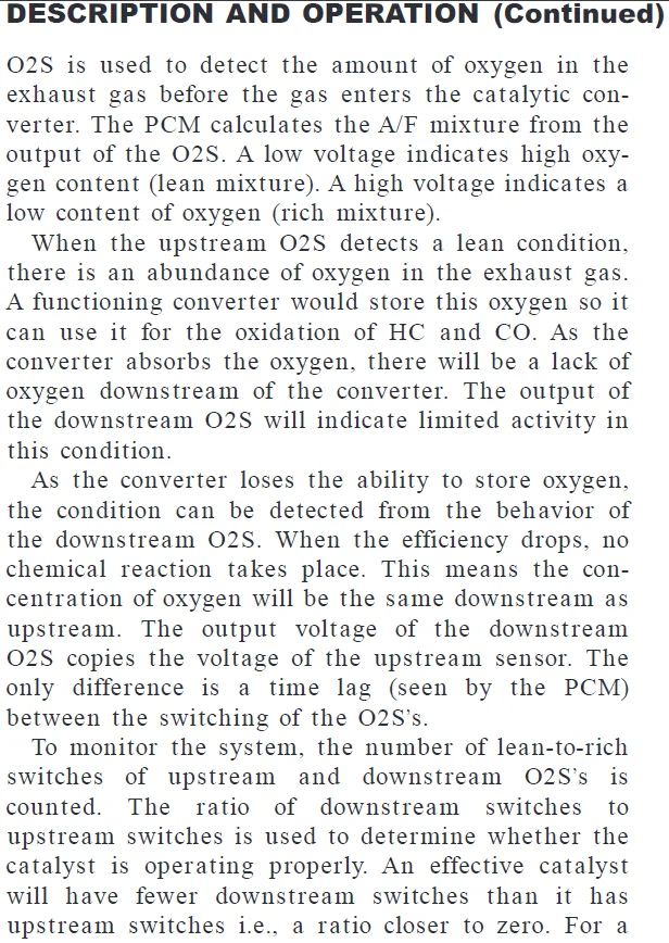

From my 98 manual...
What stands out to me:
It can take up to 2 Failures in a row to turn on the
MIL. After the MIL is ON, it takes 3 Good Trips to
turn the MIL OFF. After the MIL is OFF, the PCM
will self-erase the DTC after 40 Warm-up cycles
. A
Warm-up cycle is counted when the ECT (Engine
Coolant Temperature Sensor) has crossed 160°F and
has risen by at least 40°F
since the engine has been
started.
