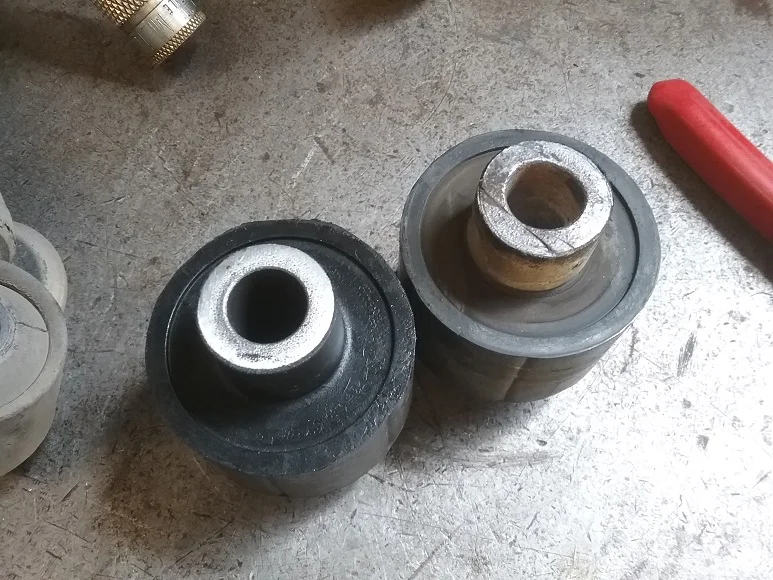

I have no complaints with my MC arms. 40K miles and they look fine to me. There is virtually no difference in ride quality between them and JJ's. I've run both. MC's are easier to service, and they are somewhat local to me, so no magical reason why I run them. Pay no attention to the misalignment bullshit. You won't go anywhere near the misalignment angles they all claim they can achieve. If you go the JJ route, don't bother trying to grease them with the provided zerk fittings. It's hit or miss for them actually receiving grease thru them, and if you get lucky, you'll probably over grease them and blow out a bushing half in the process, so it's best to take them apart to service them.
