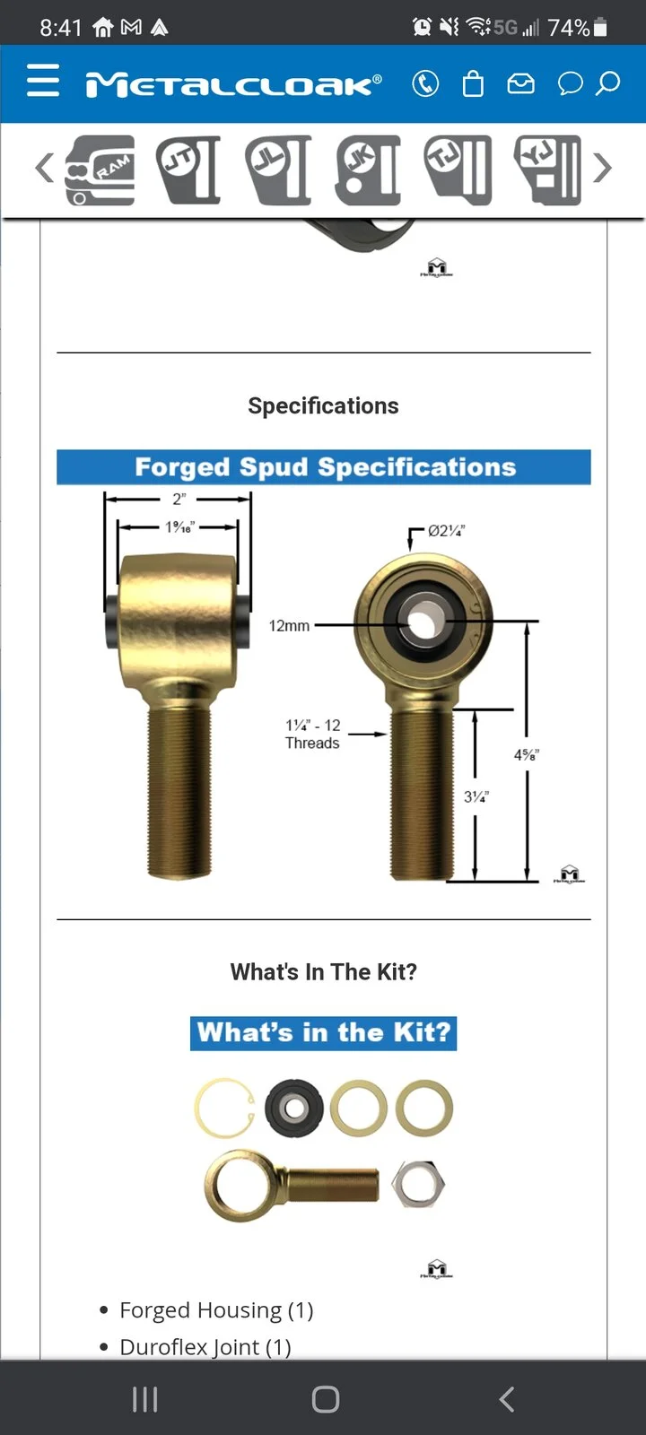

Why are all the measurements on the MC joint imperial, except the hole being metric randomly?

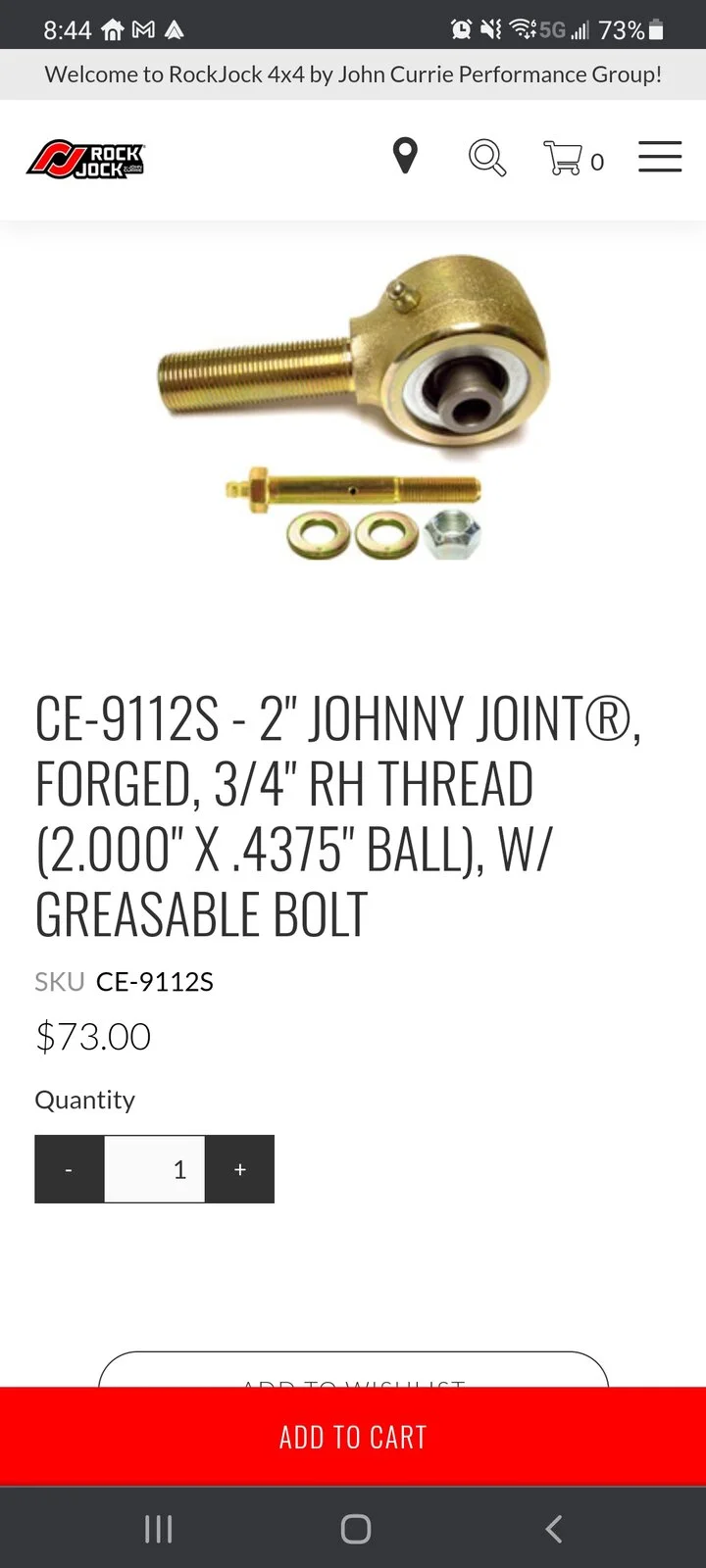

i just looked at rock jock the other day and joints are 60$ ea.

I’m gonna assume here and say that hole is made to factory specs to match existing 🤷🏼‍♂️
Yeah, I think you’re right after reading a bit today. Currie’s instructions also say that the bolts they include are 7/16” and the hole is metric and will need to be drilled out.
