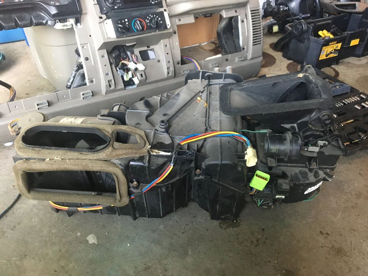

Not sure how 'easy' the blower motor is to replace. At least on my '05 I had to remove the entire dash to get to the box with the motor and heater core. I should say, it's not hard, just really involved. And actually kind of fun. You know all that crap you lost behind the dash?
Ah weird, all the vids I've watched show it being replaced through the engine bay. Remove that aluminum panel top passenger side, and it's below that. Seems simple enough, if a little time consuming? But that was on at '01, and mine's a '00
I seem to recall that all changed in the '02 model year.
Here's a video of a guy replacing the heater core:
this is the assembly that houses the motor, heater core, and AC core. The motor is to the right and below that green plug.
In that case thank god I bought a 2000 because that is absolutely not something I'd want to tackle or enjoy tackling. geez.
Some of this stuff you have to take a zen approach. It was actually 'easy'. Only one nut was a serious PITA. But since all the stuff you're working on is inside, there's no rust fighting to do. Plus I did a lot of 'while you've got the dash out' stuff.
That said, I hope I don't have to do it again any time soon.
