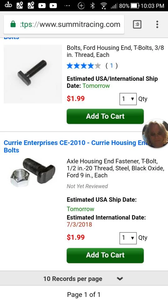

So funny thing, I didn't know what a t bolt was and figured I'd google it to find out. First result comes back with this.
Lol apparently summit didn't get the memo on it not being such a great idea.
@04LJ that's the kind of nut we are talking about.

So funny thing, I didn't know what a t bolt was and figured I'd google it to find out. First result comes back with this. View attachment 45398

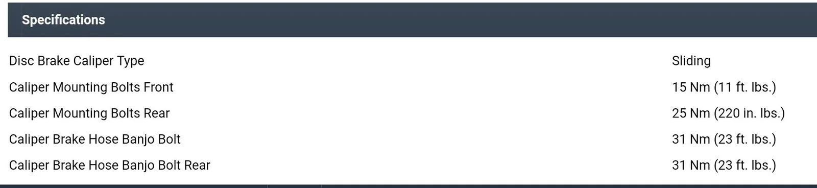

Where are those specs from? Reason I ask is the bolts, bolt sleeves, and the material they are threaded into and the depth of the material for all intents and purposes are identical. The front caliper is easily twice as heavy as the rear one so it strikes me as very odd that the rear bolt torque is nearly twice what the front one is.
Alldatadiy.com off an 06 TJ account.

Agreed, I scratched my head and looked twice to make sure I wasn't missing something. I more looked it up to confirm that the front was 11 ft/lbs, it sounded right but it's been a while, so I figured I'd double check.
