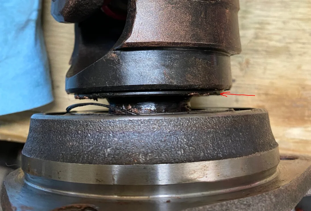

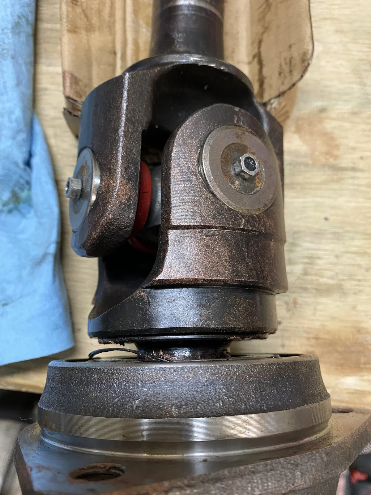

See if the spacer comes off. That should allow you to run the 30 spline stuff until you need to replace the UBs.
It’s refit a spacer. It’s milled step.
However, I decided if I may have to replace the stub and UB anyway why not get creative. I tried it on upside down. With a light hammering it seared all the way.
The slight gap is because I pulled it back off. It won’t go in the correct way, yet. I’m hoping with some on and off I’ll get it to go on. Maybe it will still bind in the middle. Maybe I can get it there.
its 35* in the garage. Maybe cooling will help
I’ll work on it more tomorrow.
Maybe...
Since they don't fit together properly; I would have returned the parts and requested a refund.
Even if you get them to fit together; all the tapping and smacking of these NEW parts will have decreased their life expectancy.
I'll send a pic tomorrow. It really is how they milled it. Its a step. It flows into the splines. The only thing I'm trying to show is that the UB fully slides onto the splines of the axle, in the reverse direction.
More to follow tomorrow.

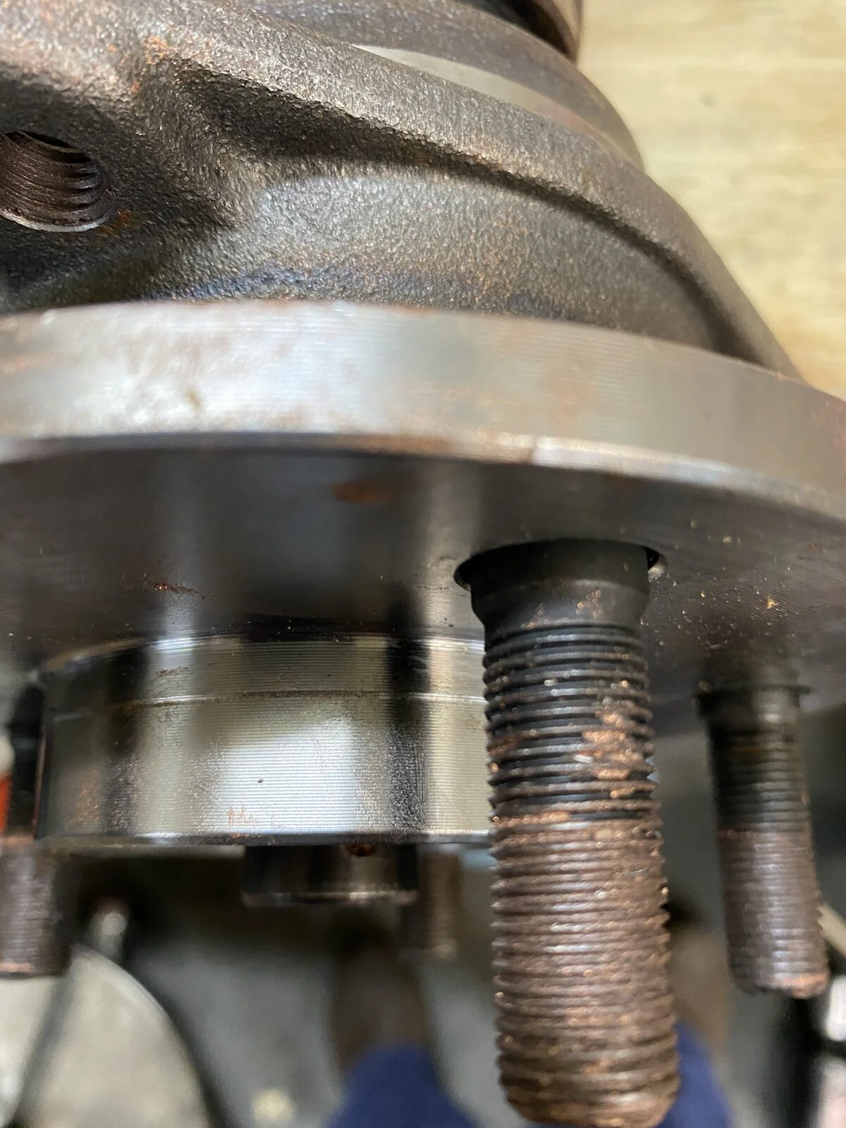

make sure the outer stub slides fully inside of the unit bearing
