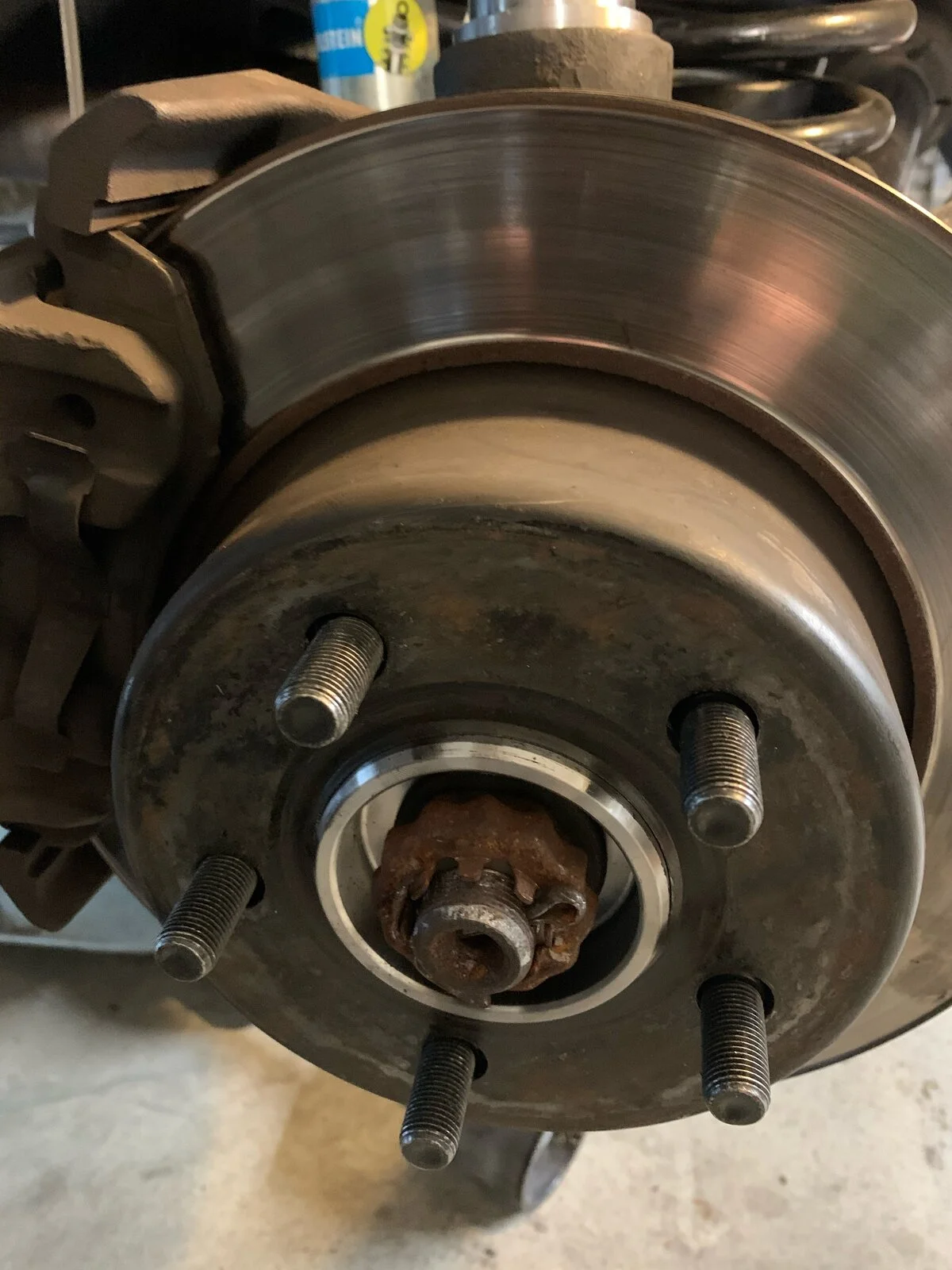

Having said that odds are you'll ruin them removing to replace the u joint because you'll have to beat the shit out of it to get it off. Even if its not that old odds are someone didn't use wheel bearing grease or anti seize around it...or..😯 they're original.
Caliper off, rotor off, axle nut,
(3) 12 point fasteners...pending how long its been on there you'll need to beat the shit out of it to remove.
This thing makes life a deam removing the that WB.
Its like 3 minutes to get to the WB removing part and it's hammer time. (Odds are high)

There's no need to ruin anything getting the wheel bearings out. Put a 2.5 inch wide tube, a big bolt, whatever behind the outer stub axle and the inner C and use the steering wheel to push the bearing out.
Yep...or you can beat on the 12 point bolts with 12 point socket too and drive it out
But those littke tricks don't always work. At least not in my rust belt neck of the woods.

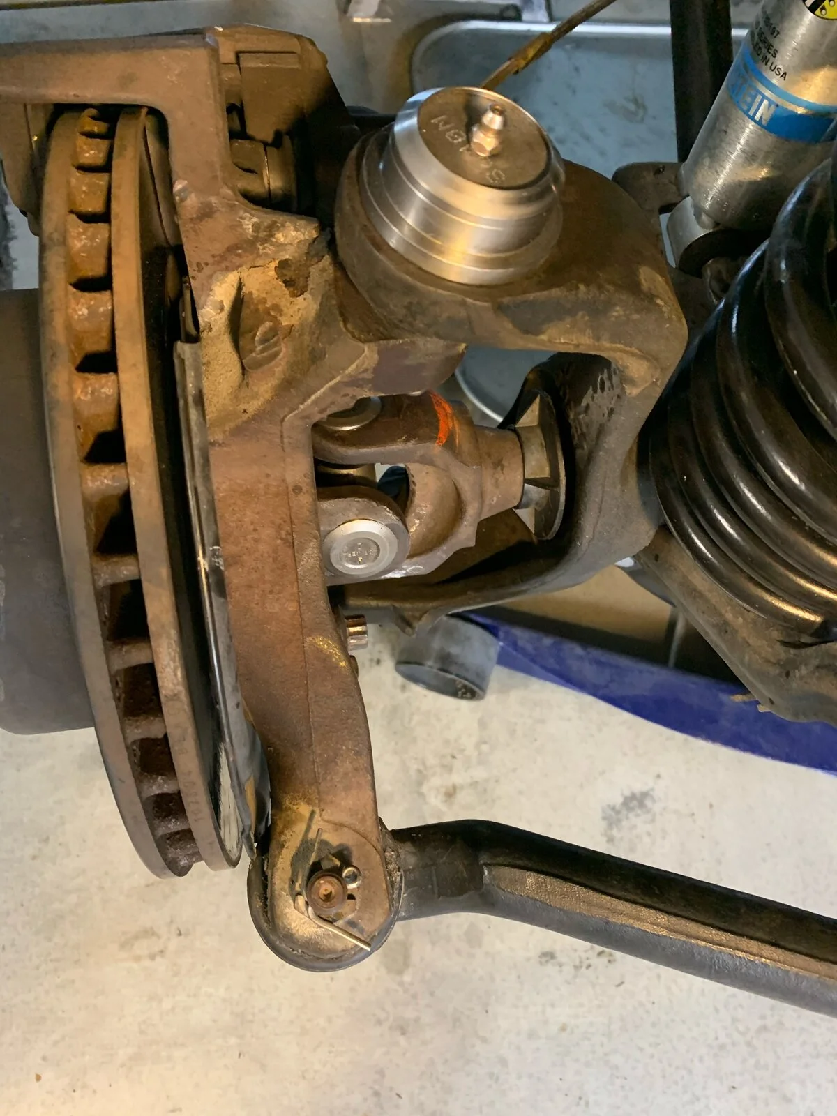

Changing the ball joints really isn't that bad, especially with the OTC 7249 tool set. Worked perfectly, I started around 8am & was completely done by around 11am.

The key is to push only one cap out at a time with the u joint body. There are specialized pullers to do this but a BFH works wonderful. Pressing one u joint cap to press out the other side is a bad idea.
Hah maybe but it more or less kicked my ass when I did mine 6-7 years ago when I was still a young man still in only my 60's. 🤣 Mine were so tight that I had add a 4' jack handle onto the end of my 3' breaker bar to gain enough leverage to get the old ball joints out.

Lol really? I guess I lucked out, I didn't need a cheater for any of them & I'm built like a 14 year old.
Update: All done. Wasn't too bad of a job. I did PB Blast everything I could a few days before starting since everything has been there for 23 years. Getting the knuckles off was the worst part. Had to smack the crap out of them to get them off. The trick for the u-joints is the Harbor Freight ball joint press - just presses them in/out (just watch your alignment). The trick for the ball joints is the 7894 adapter kit (amazon) used with the Harbor Freight ball joint press. Best $30 you will spend. Kit has two pieces for removal, and two (one is wedge shaped) for perfect install. Took just a little over 5 hours for both sides. New axle u-joints, ball joints, unit bearings (hubs). Spent just over $250 in parts (Spicer and Timken), probably 10% of what a shop would charge. Go to Stu-Offroad.com for tutorials. Good for another 100K miles!

This is important - watch the press and make sure you leave part of the following cap in the yoke. That way it is properly aligned to be pressed out when you flip it over to do that cap. I used hand tools, no impact. I think you can use impact for removal, but I would recommend hand tools for installation.
