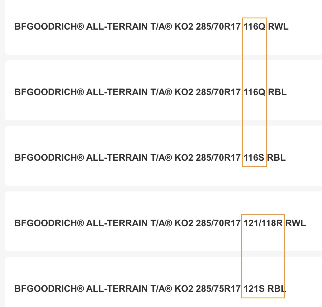

Looks like they don't label these as "C", "E".... They offer 2 different tires in this size with a max inflation of 50 PSI??

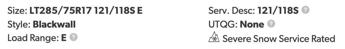

From the descriptions on BFG's website (screenshot), I believe the 116 models are C rated and the 121 models are E rated. Vendor sites like Tire Rack, Costco, etc. typically indicate the load range in their listing (second screenshot is from Tire Rack). Others will know more, but looking at the C-rated KO2s in your size, it's hard to imagine speed rating Q vs. S mattering much in a TJ.
I believe that usually when there's something minor different between two tires of the same load range and size other than the option of white letters, it's because one was specified a certain way for use by an OEM. I believe the 285/70R17 KO2 is available on the JL, so it's likely that either that was the 116 Q or 116 S.

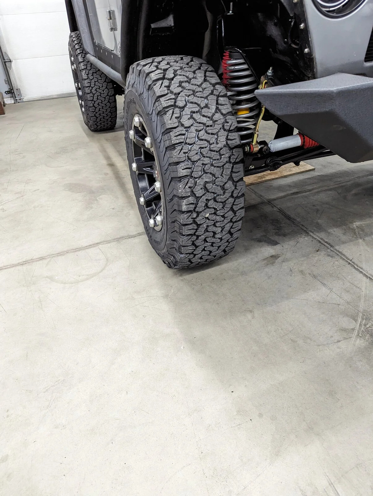

So they ended up putting the load E on my rig by mistake and said drive them until Tuesday and we can put the C's on when they come in..
I'm not sure about the 285/70 on this 9" rim, maybe just go back to 33x12.5...? They drive so good though and they are 13 lbs lighter that the M/T's were.
