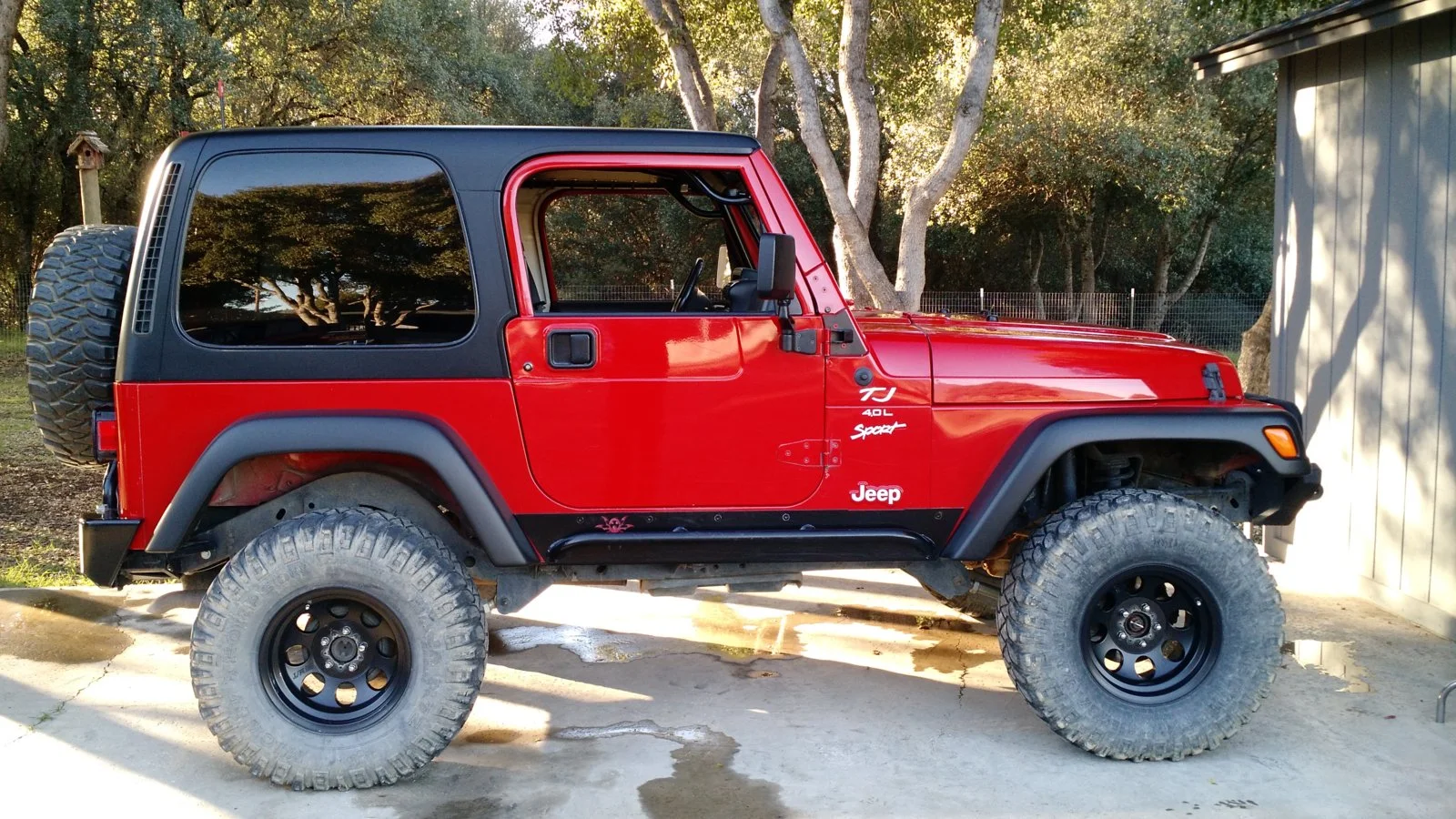

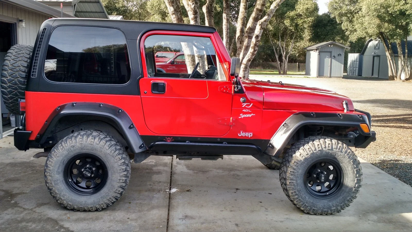

Here is a better picture of the wheels, just before I put the new tires on and just before I took the Bushwhacker fender flares off.View attachment 17859
I've never been a big fan of black wheels, but on your rig, they look great with all the other black accents! Nice TJ. It'd be very helpful if you wouldn't mind filling out your profile, that way folks could see what you have, and it would be very informative...

Are those just plain Rubicon flares? The color looks awesome.....
I'm used to my '02 factory flares that have a texture and aren't as rich in color as yours.
I sent the wrong picture this the better one showing the wheels better and just before I took of the Bushwhacker flares. Found some flares of a Sahara (same as the Rubicon) flares, an inch wider then stock. The flares weren't that pretty when I got them. Bobtj03 painted them for me :).

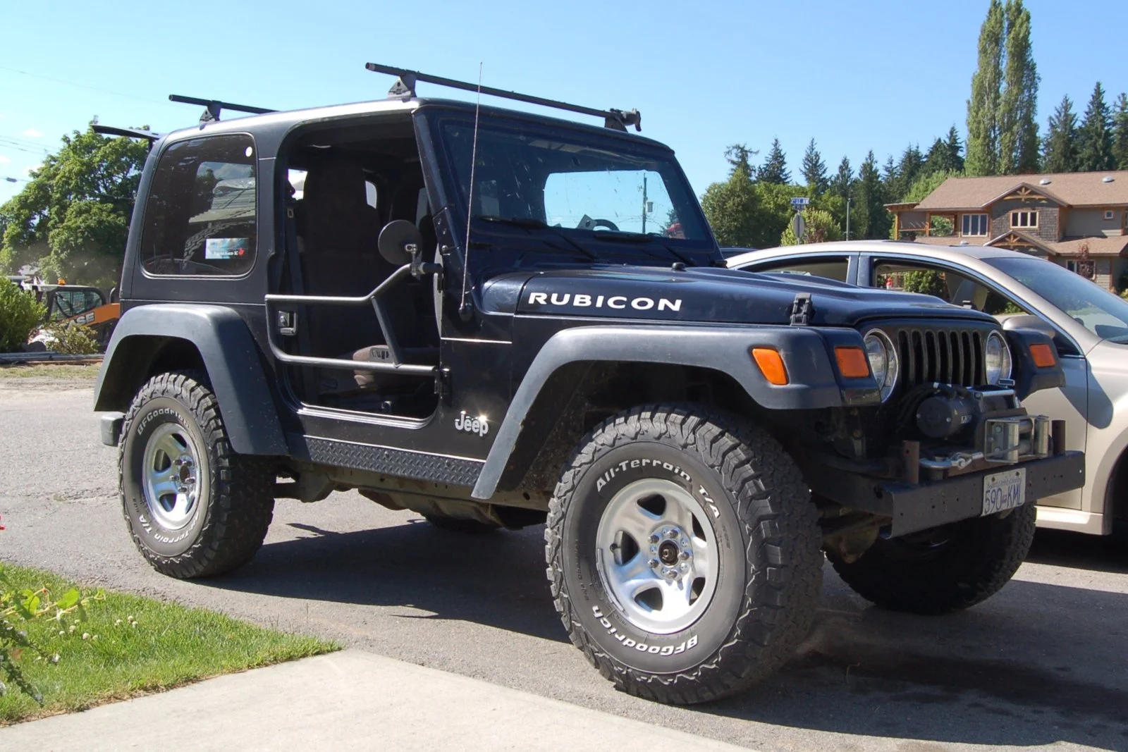

New 33x10.50R15s TODAY !!! On stock 15x7 Wrangler Steel Spokers. With a STOCK Rubi suspension, NO lift but an AEV HighLine which gives massive wheel wells. They do rub on the lower control arm so will adjust the steering stops AND maybe look for some after market offset lower control arms.
Next job will be to narrow the AEV flares from 6" to 3".

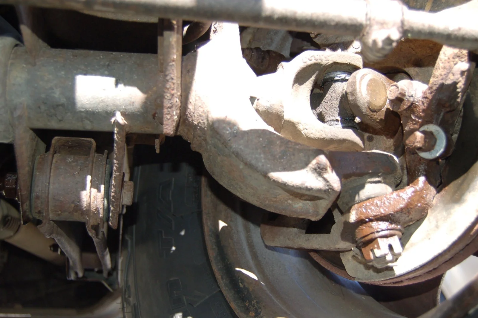

This is a completely stock Rubi suspension zero lift. 33x10.50x15 KOs. On 15x7 stock Jeep rims with 5.5" backspace.
Went out to do some articulation and have ended up with 2 washers per side.
If you don't want to trim the AEV fenders I'd glad buy them from you ;)
You are missing all the cracks.... one is visible on the front right but the front left is worse. But no, I want them, just that I prefer a "narrow" TJ for my wheelin'.
