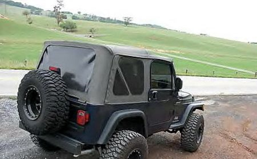

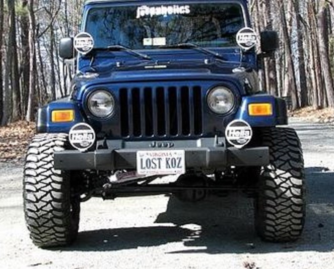

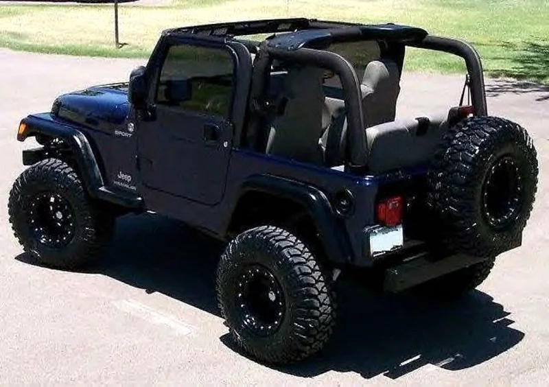

Patriot Blue looks so friggin good on these.
I never liked mine. It showed every scratch from the tires throwing up rocks. Not sure why. ;)

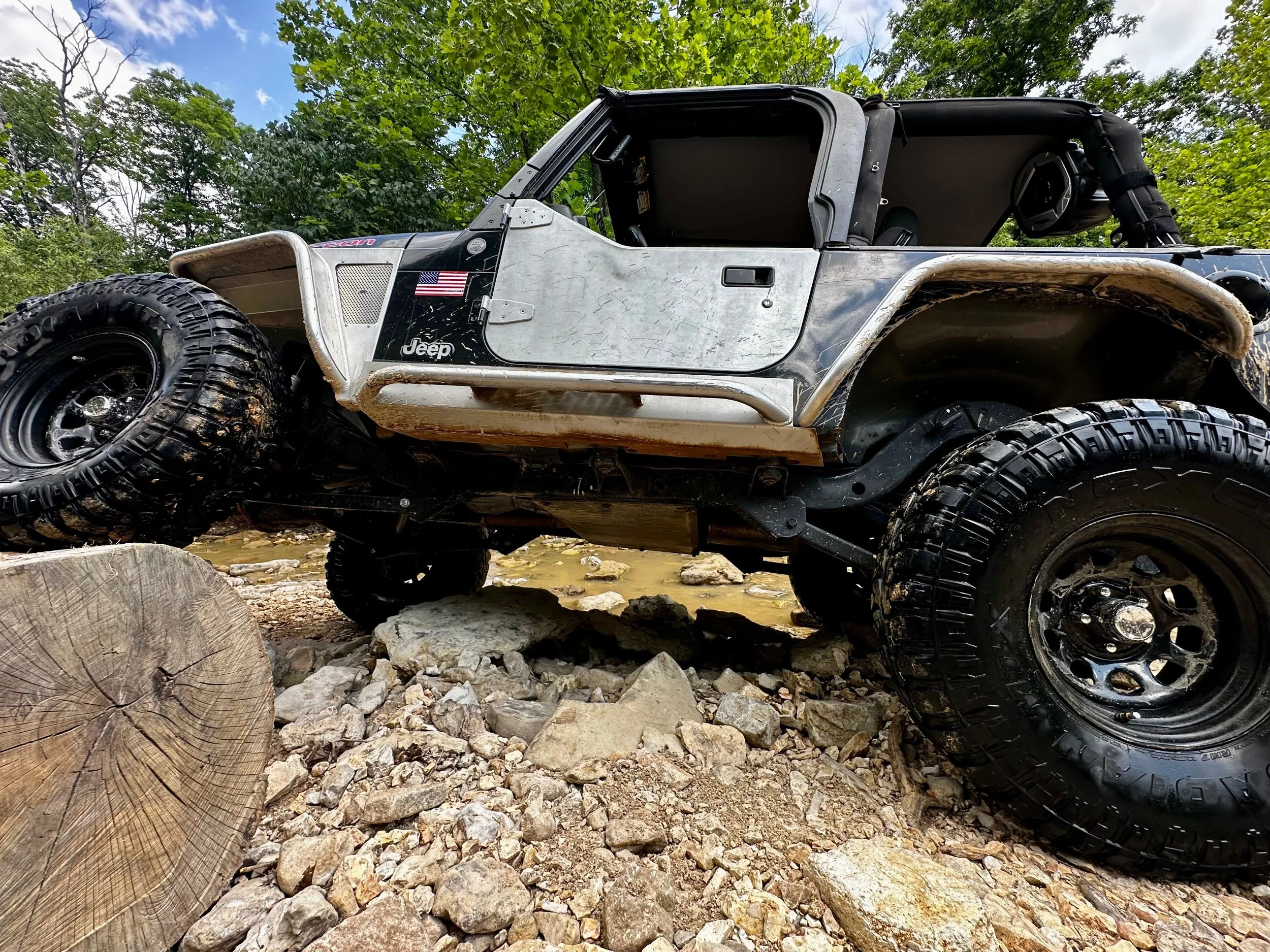

Priorities for me if starting over:
1) Steel, solid, actual rock sliders to protect my sides.
2) Stubby steel bumper with solid recovery points, and a good winch.
3) High clearance rear bumper with solid recovery points.
4) Tummy Tuck (get rid of the shovel), with SYE, and transfer case shift cable, and either Adams or Woods drive shafts.
5) Oil tank skid, steer box skid.
6) High clearance / high capacity gas tank / with solid skid.
7) JL control arm swap (or Savvy mid arm if you have the $$$)
8) WJ knuckle swap
Lockers, lights and other luxuries would be way down the line, after lots of wheeling.
... How it started vs how it's going...
Reactions: John Cooper

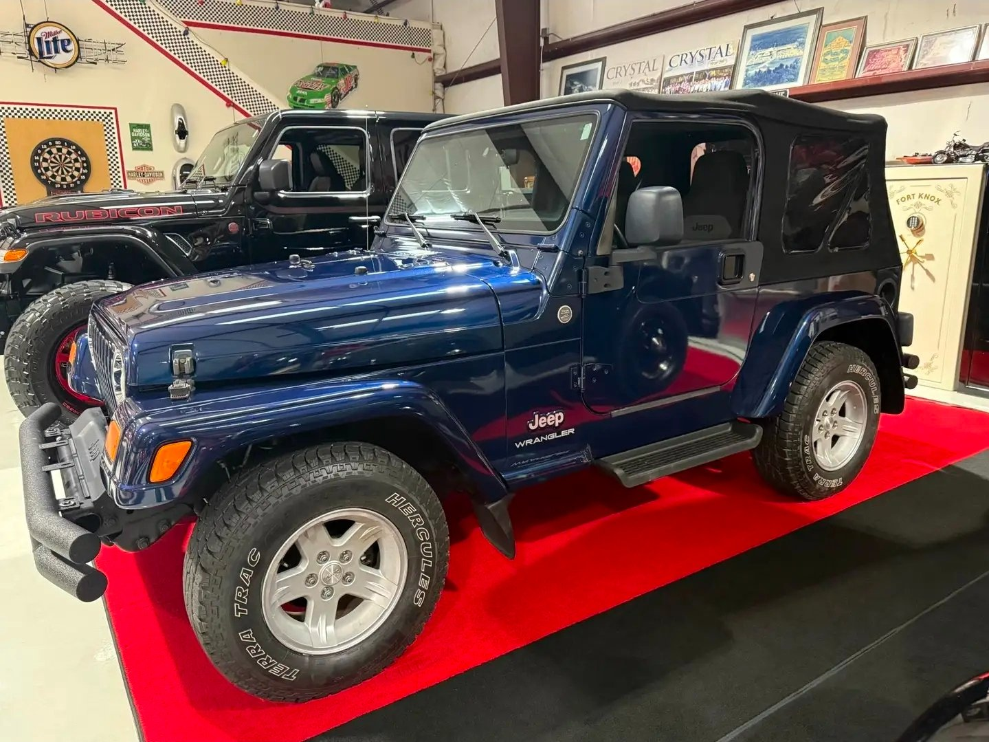

Beautiful rig. Looks really good. I can see a little bigger tire and some lift for looks - if desired.
Thank you, we share the same thoughts. I thin I found a really clean Tj and do Intend to put a 2.5 lift, going to run some 1.5 spacers on the stock wheel set up until I can find wheels with -19mm offset and & Tires with 32" height and 11-12" width.
