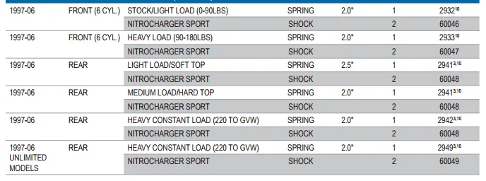

@ac_ I may have missed this detail in this thread, but since you are wanting information in here that would help anyone searching in the future on this issue, can you verify that you ended up in your current suspension setup with 2933 front springs & 2941 rear springs? After initially installing 2942 rear springs?
The reason I ask is, we tend to toss HD & LD around when it comes to OME suspension, when websites can really vary on what that means. Some sites even throw in a 'medium duty' OME variance. I have yet to figure out what that means. Maybe it's what you ended up with ultimately. I did a ton of research prior to ordering my kit with 2932 & 2941 springs (which had no trim spacers included), and probably PM'd @Chris to death on the issue before I could decide. It ended up being those springs & 3/4" spacers front & rear for me that gave me room for 32" tires, no vibrations, and a great ride.

I believe the medium duty is heavy front and light rears. I think there are actually two lifts
One for TJ's and LJ's and one that is for the TJ only.
I believe the medium option is only offered on the TJ only lift.
The differences are for the TJ lift and the LJ lift is nothing with the springs it is what comes with the lift. like steering stabilizer and such. If you order a medium lift i believe you get slightly different options but the same heavy springs up front and light rears.
I see your point so here is a parts list that fixed me up:
2 Old Man Emu Part #: 2933 Front springs Heavy
2 Old Man Emu Part #: 2941 Rear springs Light duty
2 Old Man Emu Part #: OMEJGF10 10MM front spacers
Old Man Emu Part #: FKWTJ02 Rear trackbar bracket
2 Old Man Emu Part #: 60048 Rear shocks
2 Old Man Emu Part #: 60047 Front shocks Heavy load
Old Man Emu Part #: FK16 Rear bump stops

I just looked up the ARB application guide and noticed that there is really only 1 (2941) spring for both medium and light loads in the rear. They make the lift height different. @ac_ are you running a hard or soft top? If its a soft top, that might account for the wackiness you saw, or at least part of it.
I am running soft top no back seat 31 in tires and a dirtworx bumper with Hilift jack
I am now running the 2941 2.5 lift in the rear. the softop one according to your matrix abox
