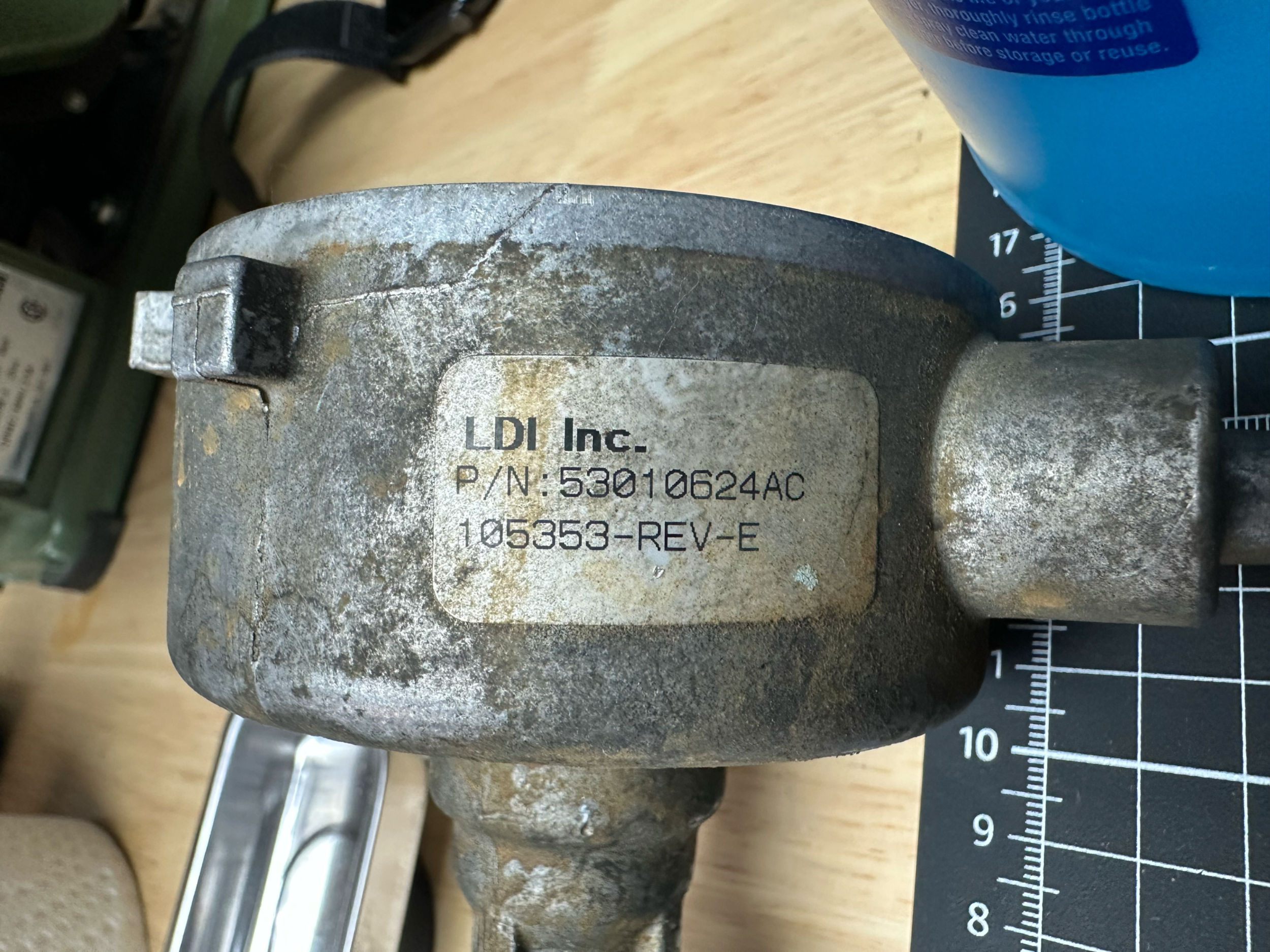

Hello! Long time lurker who finally joined after encountering a noise today on one of our LJs and my search kungfu is failing me. We have two 2006 unlimiteds (1 manual, 1 auto 4.0L) that are DD for our kids. The 4.0 automatic was emitting a strong fuel odor from the front of the vehicle so I pulled & cleaned the injectors and replaced the o-rings. This seemed to have cleared up the fuel smell, but then I noticed a loud tick from the passenger side. It's not my DD, and my kids are not terribly observant, so I'm not sure when the tick started; it could have been happening before I pulled the injectors, or it could have been something I did. I did shut off the engine, wait 10 seconds, and restart, but the tick is persistent. When I put my finger on the top of the OPDA I can feel a tick that is synced to the sound. It increases in frequency as you apply throttle.
I do have a spare ODPA I purchased and have been working up the courage to change out (I'm new to wrenching and we're using these Jeeps to learn). I bought one to keep on hand in case I had an issue. Anyhow, I wanted to get your opinions on if there is something else at play here that could be the source of the tick that I should be looking at. Here's a recording of the tick:

Thanks everyone for your help and the warm welcome! Oil level was good. Swapped the OPDA out (followed the how to and the video) and the ticking is gone ... for now :) It looks like it might have been the original pump?
