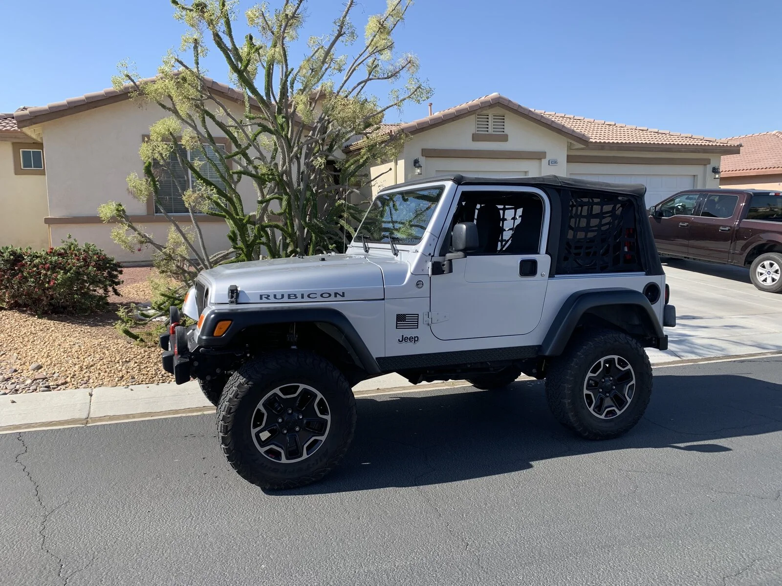

Here's how it sits as of today, after just installing coils and adjustable control arms. I went against the grain on the control arms, I know. Got them new at a good price, so figured might as well give them a go. Here is what I've done to it and could use a little guidance on what to tackle next. The end goal is to run 35's in the near future, and eventually a tummy tuck, so whatever I'm missing to get to that point, please let me know.
2006 Rubicon, 6 speed manual, with the 4.0
Rock Jock 4" coils
Rock Krawler adjustable control arms
Rock Krawler adjustable front track bar
Rock Krawler bump stops
Rear track bar relocation bracket
Terra Flex sway bar end links
ZJ steering upgrade
Power Stop brakes
285-70-17 KO2's
Rancho 5000 Shocks
Transfer Case drop
Couple questions I have for moving forward-
-I'd really like to get the transfer case drop removed. With that being said, If I do the motor mount lift, along with a small body lift, would I be able to remove the TC drop and not have any vibrations? Or would I still need a new/longer driveshaft?
- Being that I have the 6 speed manual, what would be the recommended gears be to run 35's?
