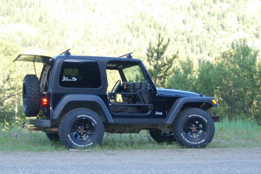

Actually before a lift I'd do a HighLine... Actually I did.
2" AEV HighLine and 33s on a TJ.... no lift. no clearance issues.
I have since added a 2" lift.... probably ego.
Reactions: Sasquatchewan
AEVs was straight bolt on... fabulous kit. Not sure about the rest but I think there is more work relocating the underhood items mounting to the inner fenders. AEV just modifies the stock inner fender, adding a strip of metal just under the flat top to raise the flat top. And they cut away a triangle at the rear of the wheel opening. All pretty easy to do in a driveway. AEV still sell a fibreglass HighLine hood. The hard part will be new plastic? flares.
