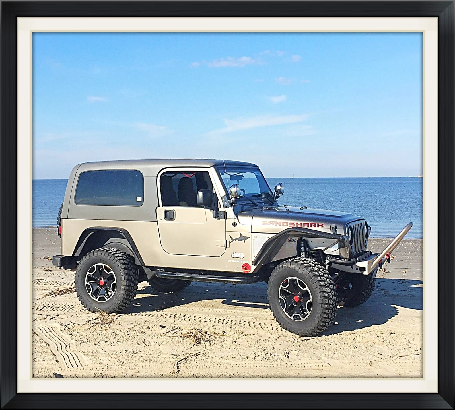

Ok this is my 1st post on here , I have the Zone 4" & Metal Cloak hi arched fenders with a 6" flare & the ride is really good I'm very happy
It looks fantastic! I've heard lots of good things about the Zone lift so I'm glad you like it.
Sasquatchewan! Good to see you man. Except now since you're here, i have at best, the 2nd coolest TJ on here.
2nd on those flares. Badass.
Reactions: Sasquatchewan
Hey mine isn't any better than yours lol, you got the best build parts .I installed my winch that came with the jeep when I bought it I just painted it , it works fine it's a Elcheepo so we'll see
