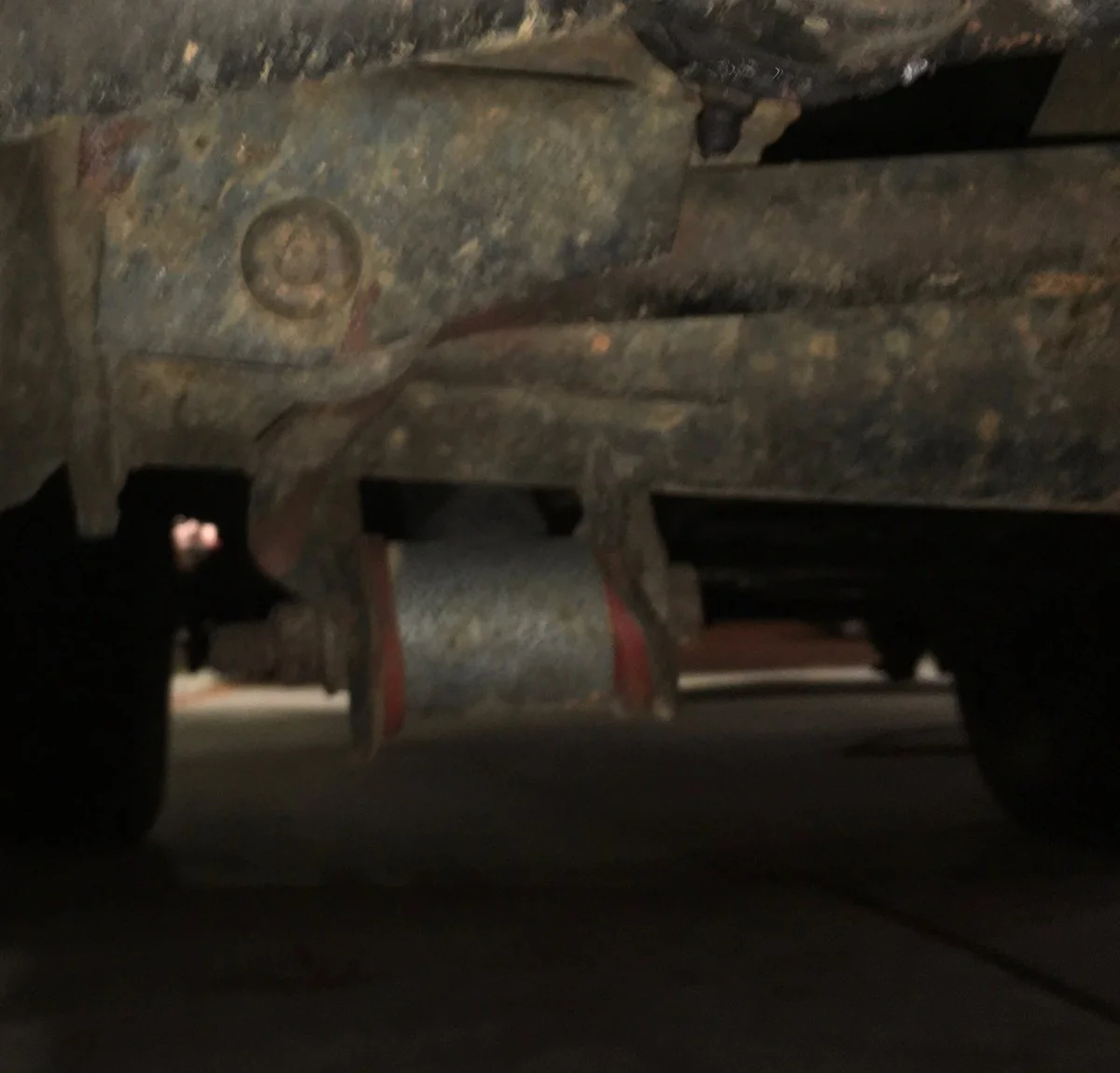

It looks like there is a lot of rust under there. Pull your skidplate to check for the bad stuff. You'll need to support the trans with a Jack before you drop the skid. If you can send some pics of the whole underside and frame we can give you some more help of other problems you might have under there.
Is just the lower control arms being bent the problem? If so, that is a pretty easy fix.
X2. Artec sells lower control arm mounts for $50. Though I would verify that your tube is or is not bent first. It hasn't been mentioned yet, but make sure whatever you gear the front to matches the rear.

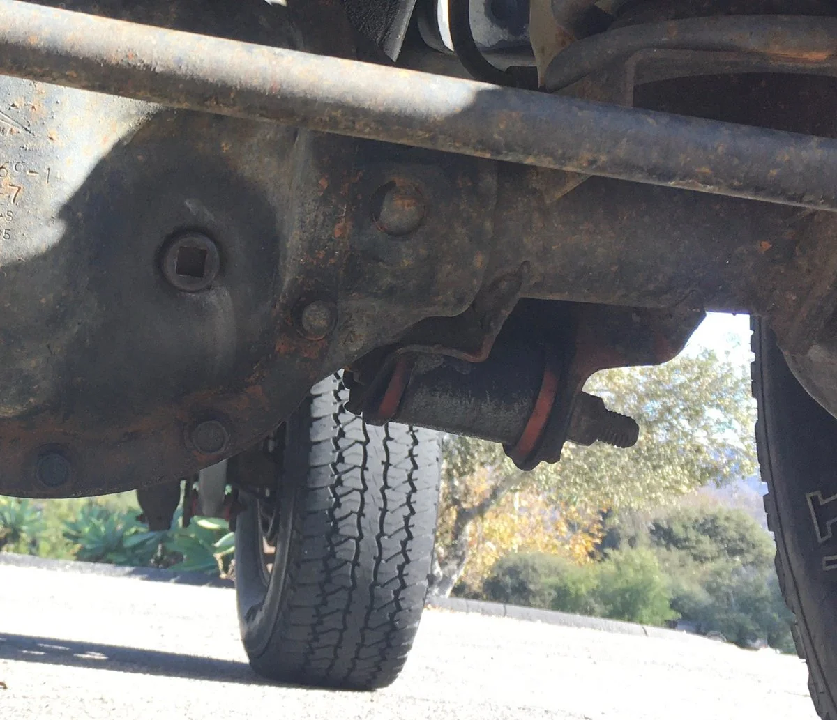

Looking at the pic tater tot , all you need is a control arm mount welded on ..a good welder can weld it inside and out, it's only welded outside at the factory ..so it will be even stronger.
