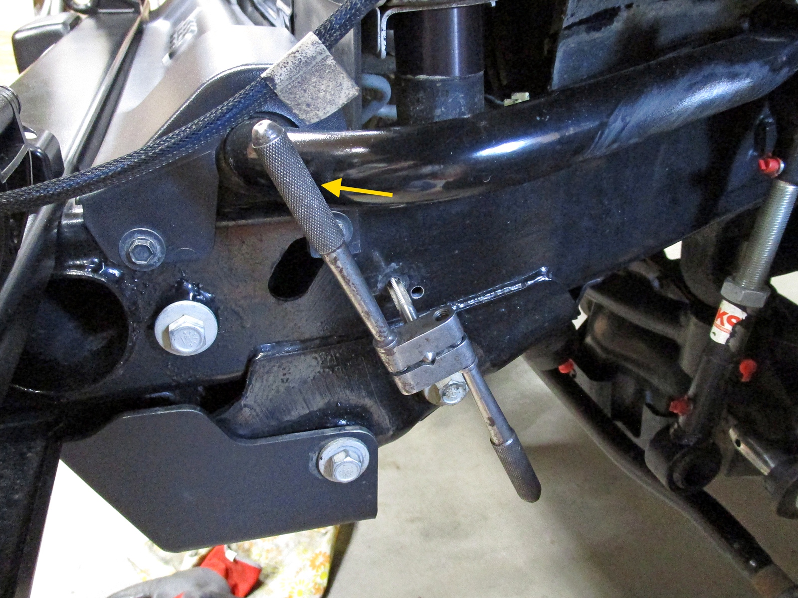

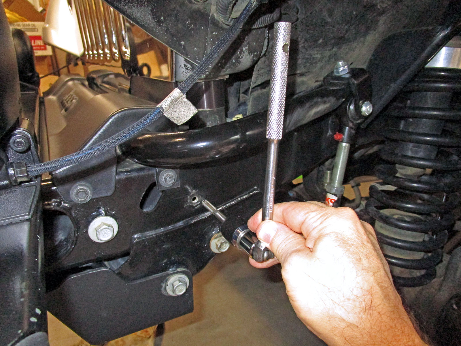

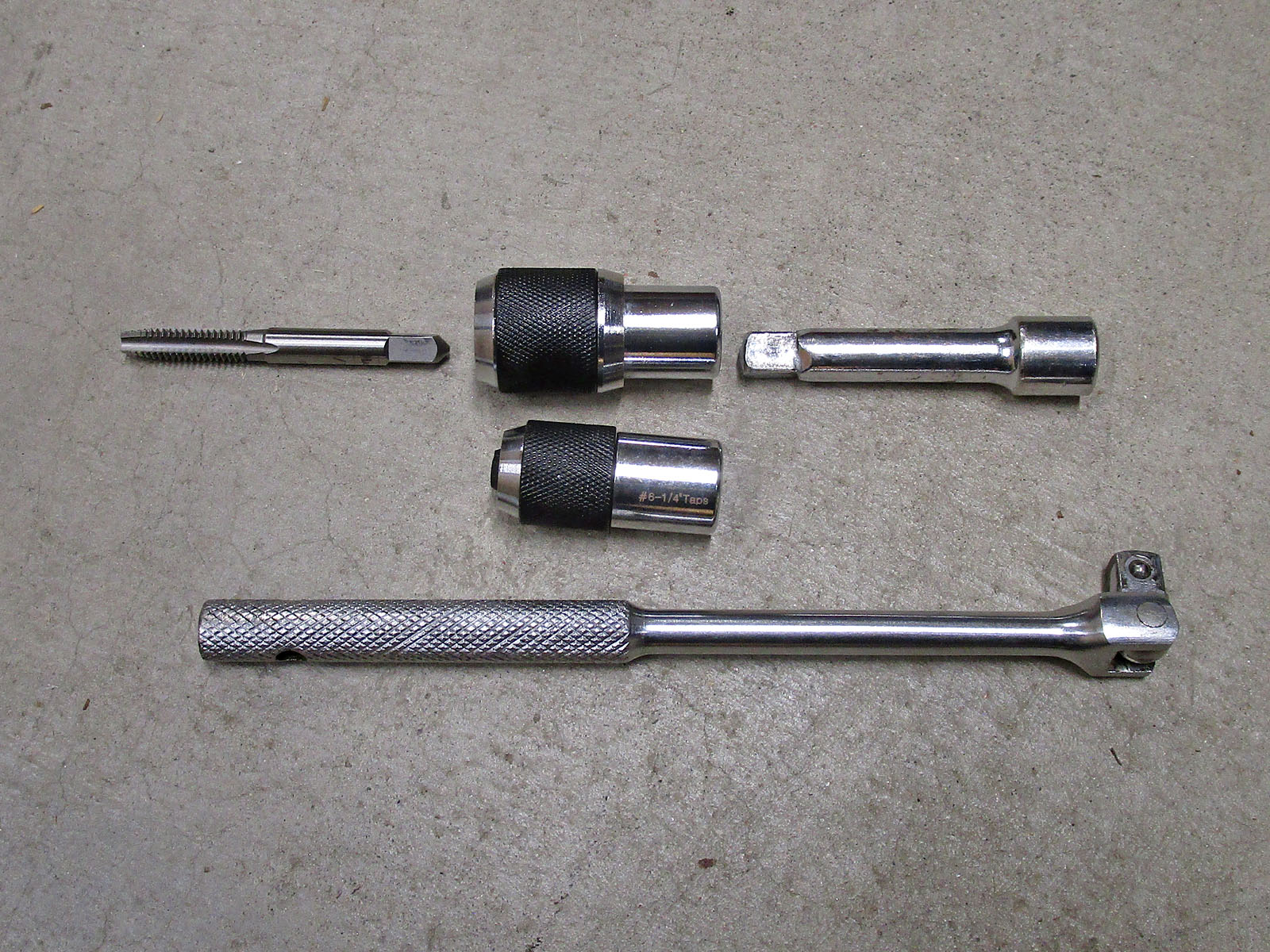

Needed to tap a hole, but the sway bar was in the way of the tap handle. Found these Tap Chucks on Amazon for $14 per set of two.

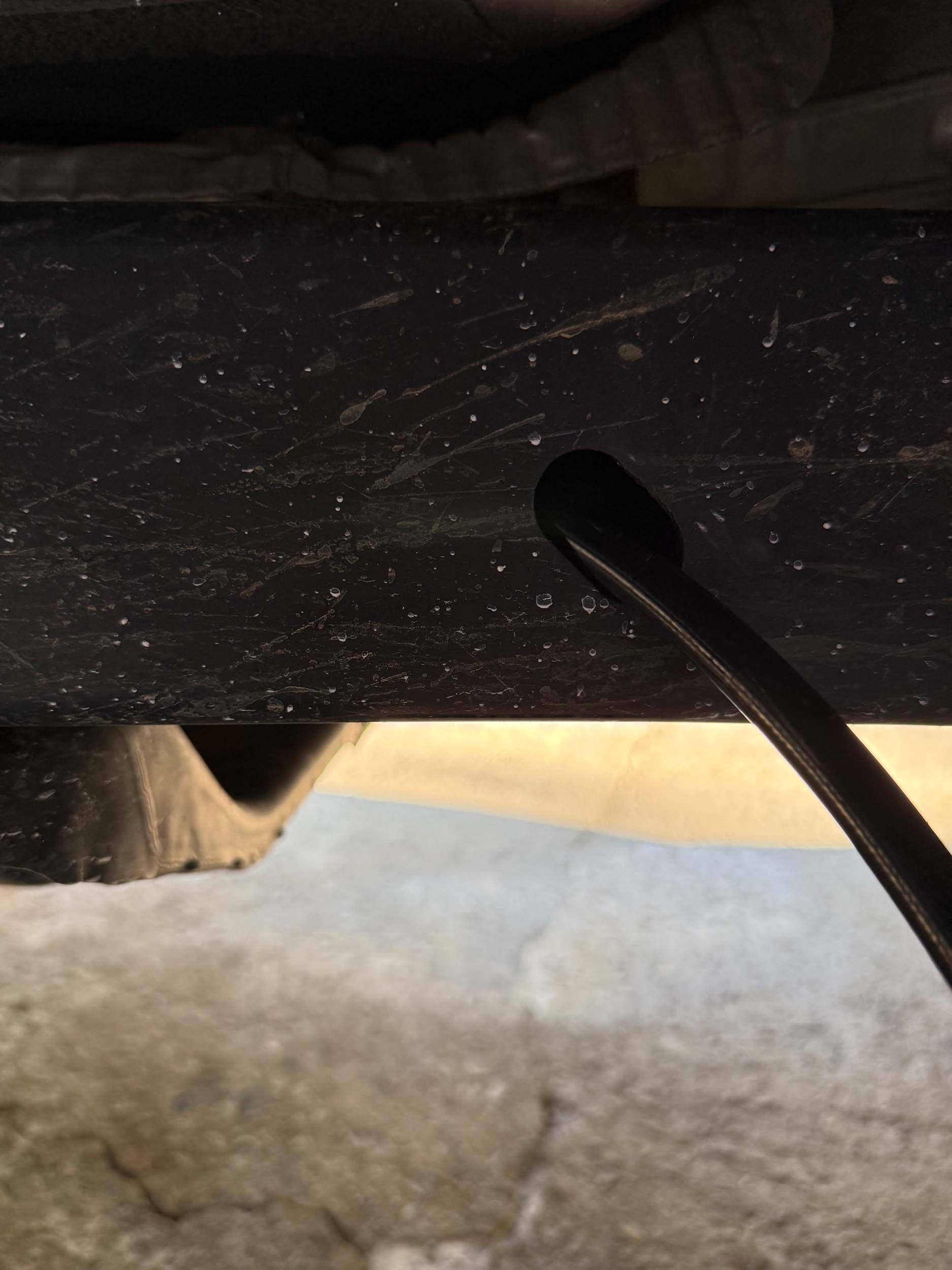

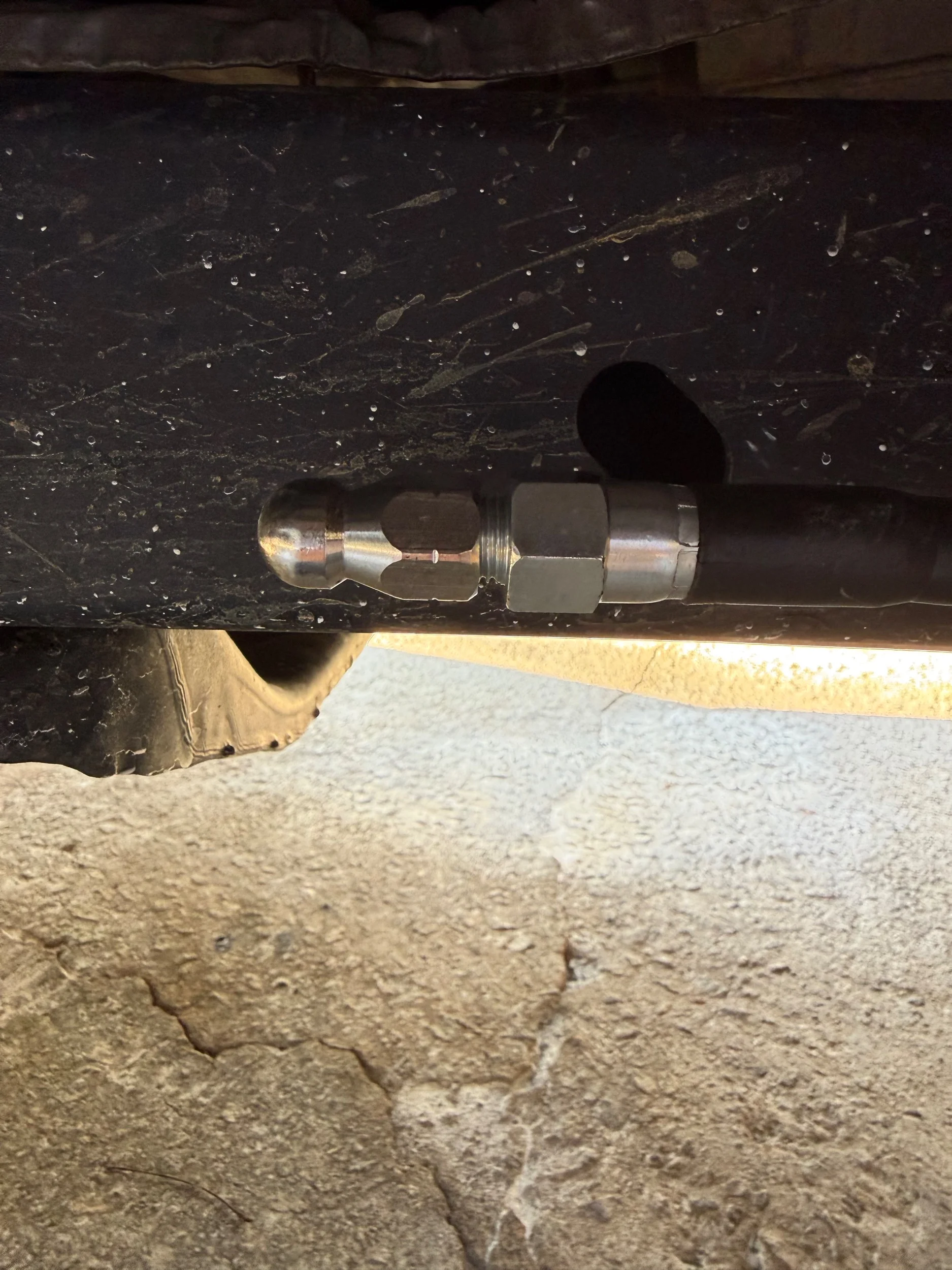

Will test out after Jeepfest this weekend.
