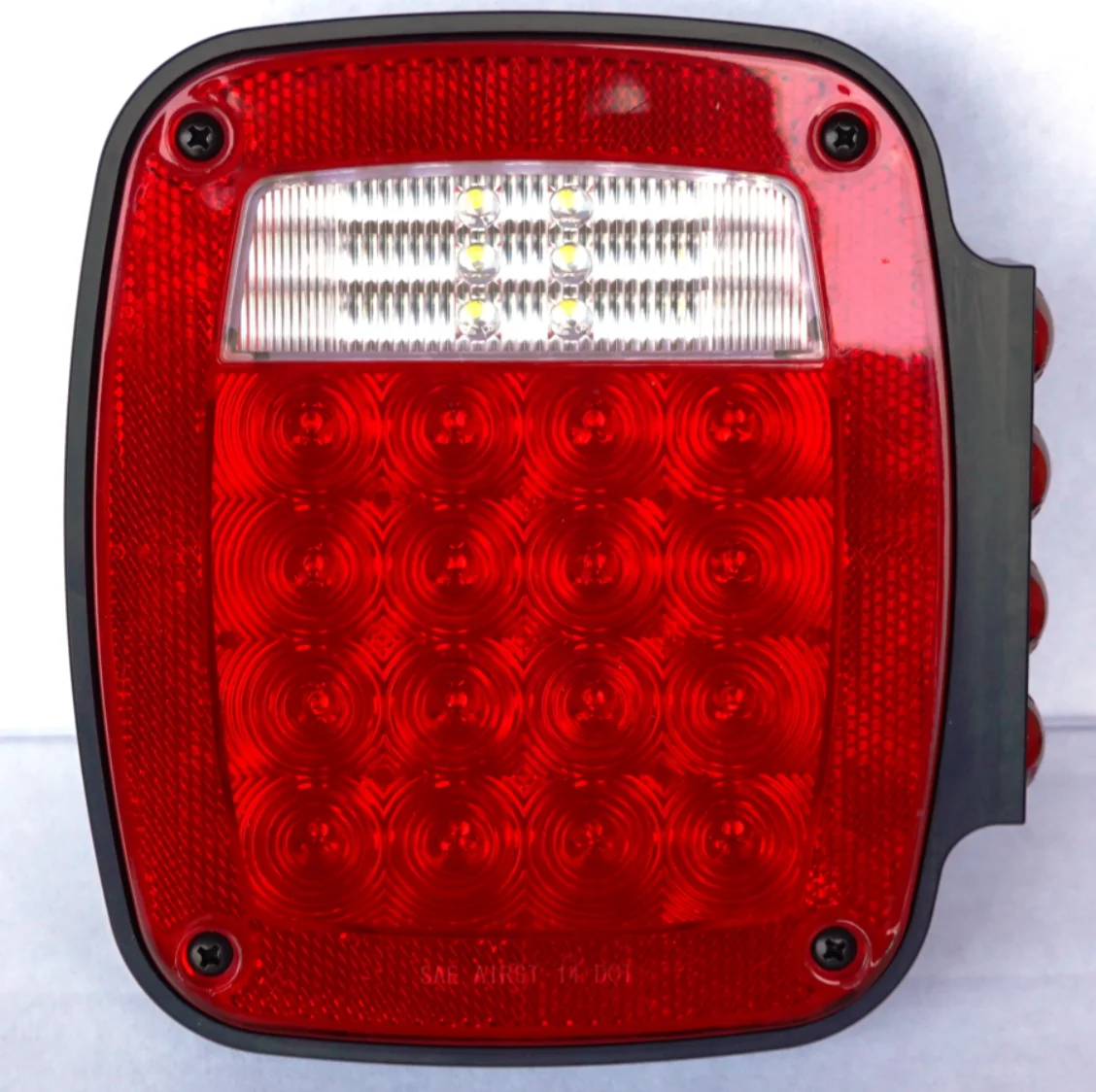

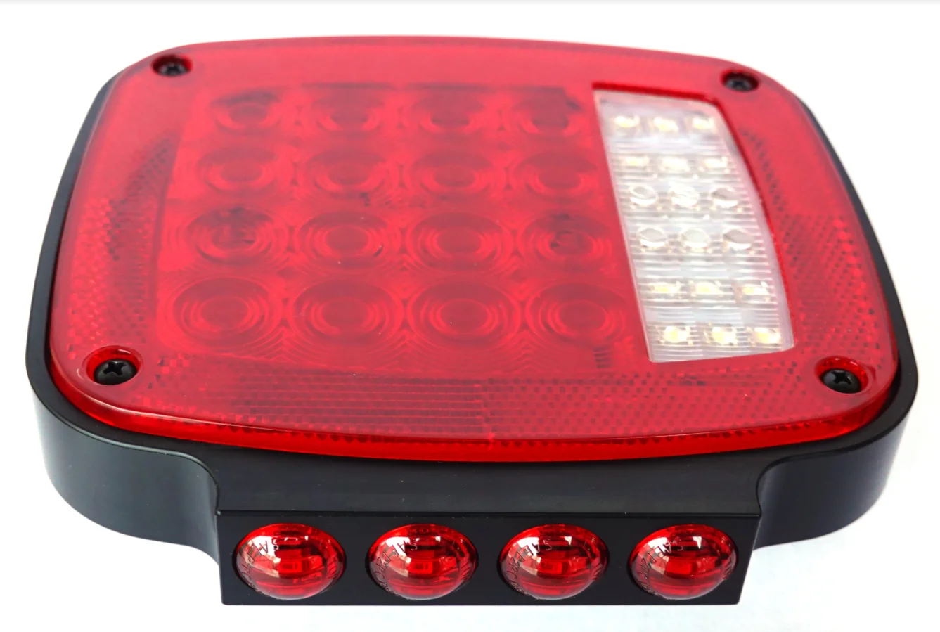

I was contemplating getting the Delrin one for my CJ-3B eventually and I wanted to see a higher res photo of these. Blaine sent me this pic.
Still think Delrin/Acetal is a really great choice for these. Anyone else planning to get a set after they are released?

The housing is slightly less than 1" tall off the back of the tub. So no, it is not less easy to hit than a flush mount. The difference though can be extrapolated by looking at a few other things. If you raise the stock gas tank skid 1", that slows down the amount of times it gets smacked on the same trails by a very large margin. The same is true for the frame side body mounts. Once we move to something like the raised Genright versions, even though they are the same shape and size as stock but just raised a bit, contact on the trails almost stops. Small changes make big improvements.
I designed the Savvy lights due to seeing a ripped off or blown up stock tail light housing on almost every trail run in JV. Once the Savvy lights went on, I never saw one damaged or hit. That was good enough for me.
To derail this a bit. I hear what it not there can't be hit. Are these lights, like your Savvy design, less easy to being hit than say to a 4" flush light and grommet?
Am I answering my own question by asking this?
To add to Blaine’s post. His new lights, in either aluminum or acetal, protect the lens from breakage by nature of sinking the light module into a box. That box is going to protect the lens. So, just like your flush mount lights being sunk into the tub, his lights are sunk into the housing. The only way you’re breaking that lens is to back it directly into a pointy rock or stick or some such truck. It will take a direct hit to the lens to break it.
I have the aluminum version, and I am pretty sure you could support the weight of the Jeep on the side of the housing and you might scratch the anodizing. Honestly, I’d be more concerned that the housing would deform the tub than damage the light itself.
