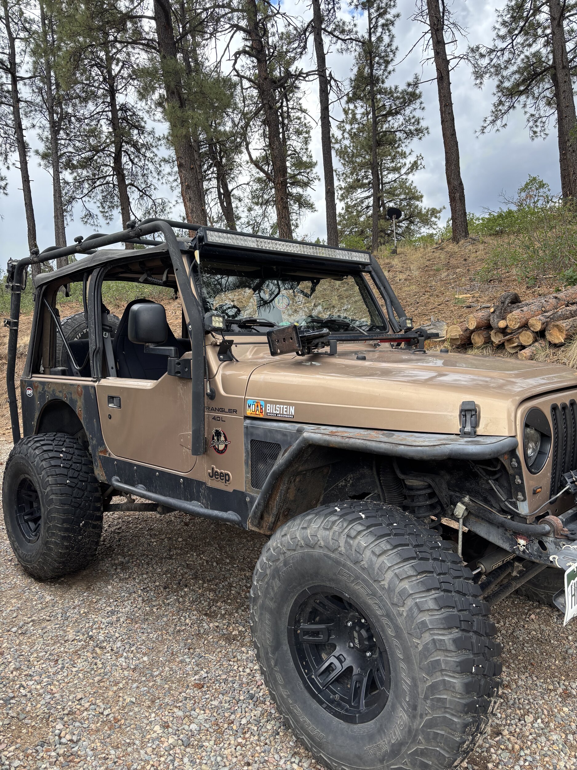

Help me going into winter, please! I have 3 big problems going into winter, first the door latches just don't work anymore. It started locking by itself, so I bought new handles which did not work (one broke the first time I used it, cheap plastic I guess) because the locking mechanism is so tight it jams up. Right now I have a wrench on it and have to leave part of the window unzipped so I can pull it down to open the door and the passenger door locks by itself, even after I replaced the new handle. I've tried a few different websites and tried to just purchase a new door, but those are very hard to find and very expensive. I did see a post on this forum about replacing the plastic clip, which I will have to give to my husband to see if he understands it. The second problem is almost zero visibilty out of the tinted plastic windows. I'm not sure if I should get a different top or just zip in clear windows. The third problem I have is the back tires don't have a mud protector over them so my windows get sprayed with mud, then it's extremely dangerous. I won't even get into the death wobble at 15 miles per hour by hitting a little bump or sewer cover or the fact that I can't put my groceries in the car without breaking my back to get them in the back seat because lack of trunk space, haha. I absolutely love my Jeep. It's just not practical for a stay at home mom buying groceries lol I guess I could've thought that through a little bit better, but here we are. and I'm ready to solve these problems going into (what I think is going to be a terrible winter with lots of snow). Any solutions would be greatly appreciated. Also suggestions for different websites or links to parts would be amazing. I have checked out several websites, but things start getting very confusing very quick. Thank you so much for your help!!

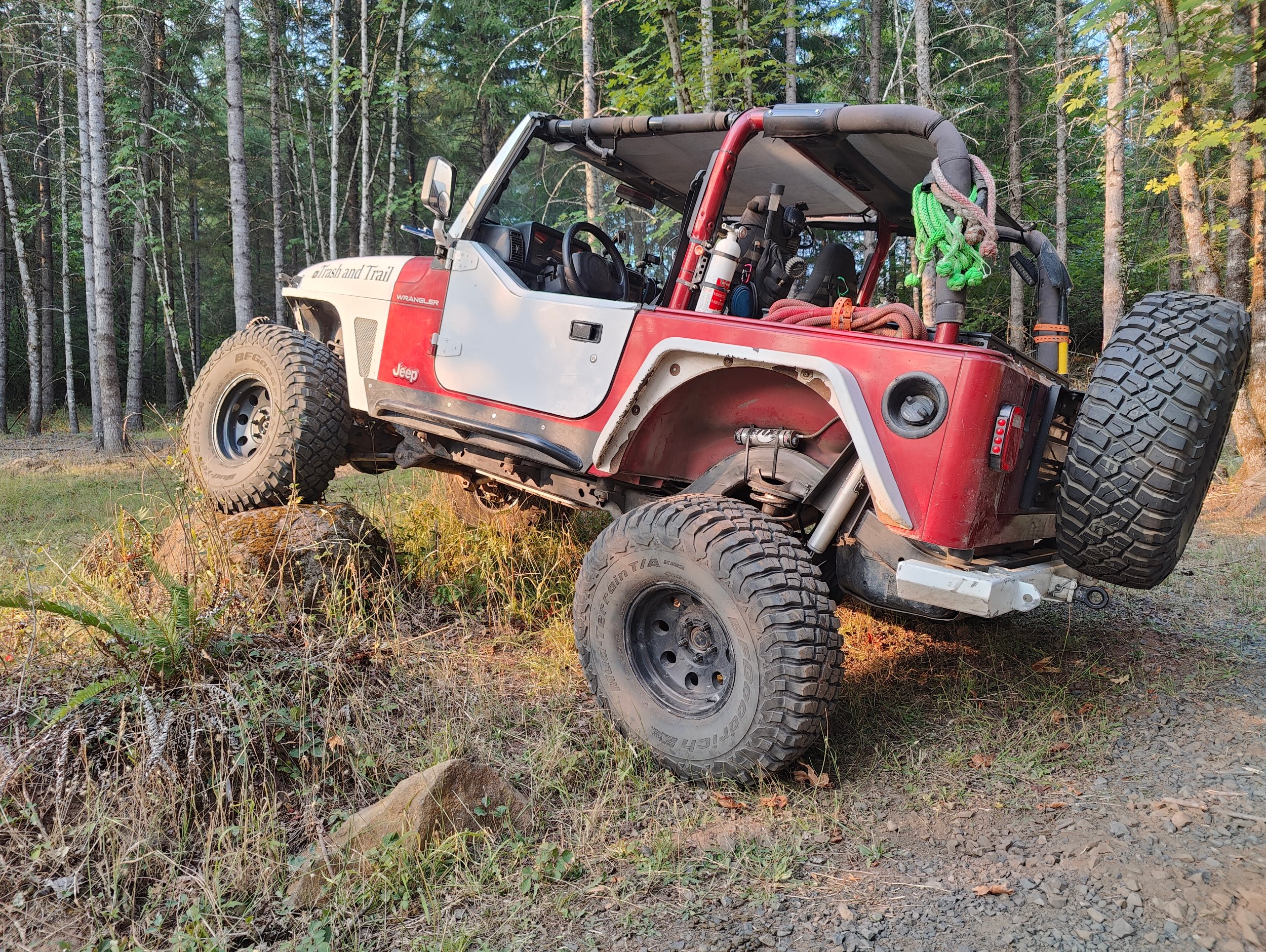

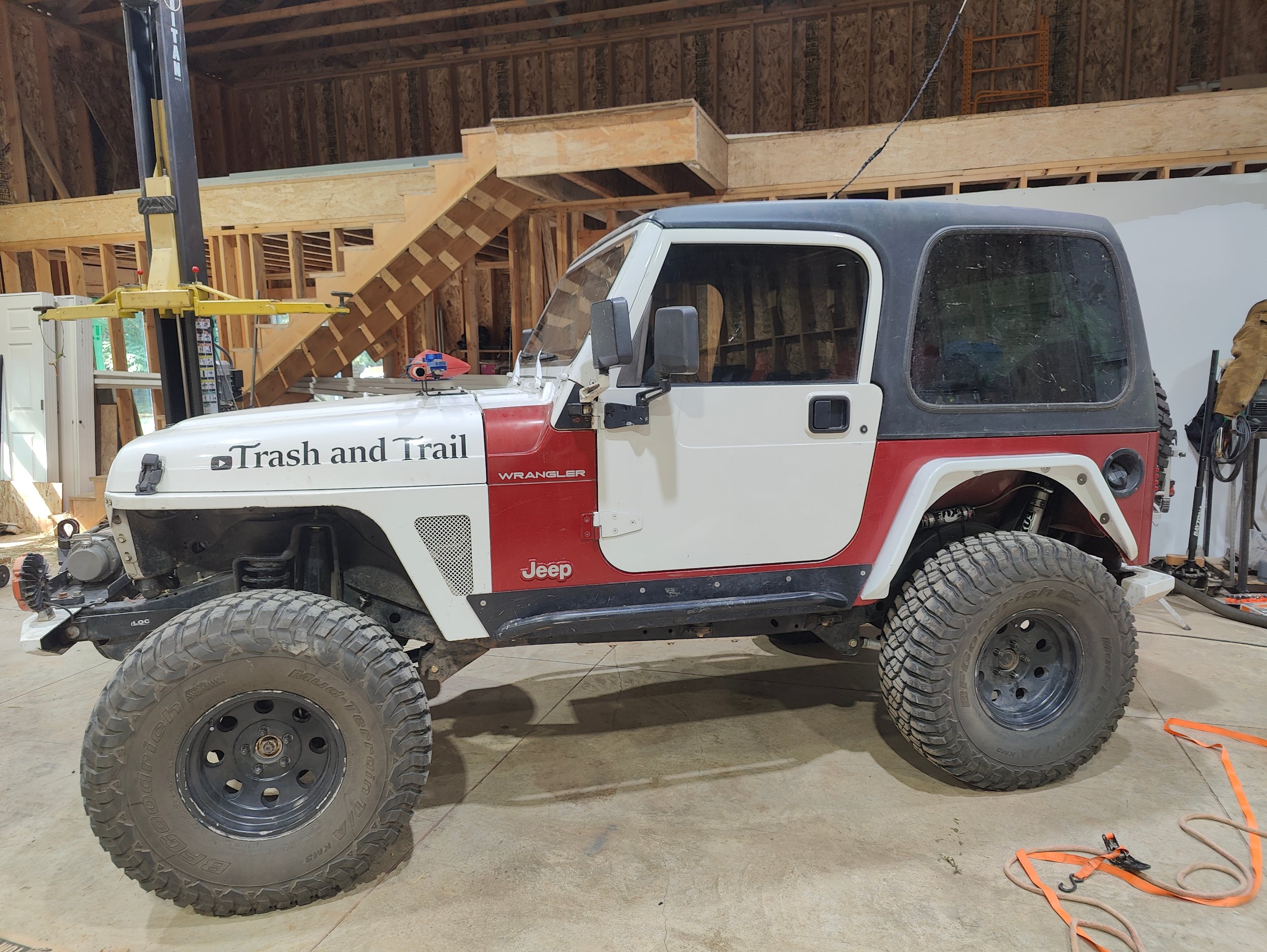

My winter mode (I live in Oregon and it rains...)
Summer mode...
