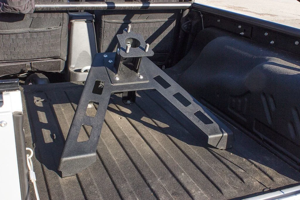

There are a couple... some of options I've found...
JCR:
TNT:
Gatekeeper:

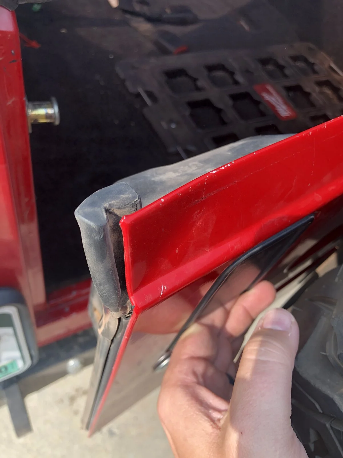

My thought for this (and maybe I am wrong) is that in watching videos of wheeling, it almost seems as if having the spare mounted on the tailgate behind the rear axle adds a lot of leverage to the rear that may not be as good as if the weight from the spare was mounted over the rear axle in the trunk of the TJ.
Generally my issue is climbing steep things (or descending them) and the tire getting hung up. I've dragged the tire a bit and even bent the tailgate a little. The weight distribution doesn't tend to bug me much, if at all (though once I move it inside for the harder trails I'll find out more).

The TNT version places the spare flat on the floor and unless I am mistaken uses the back seat & seat belt mounting points. You could likely place the carrier on the floor place the seat and seat belt mounting brackets on top, bolt everything down and be good to go. Seat or spare you would be set.
That's what kept me from using a body mounted spare tire carrier (specifically those which incorporate the even more flimsy JK tailgate).
Edit: I've heard of folks completely deflating the spare to soften the impact...

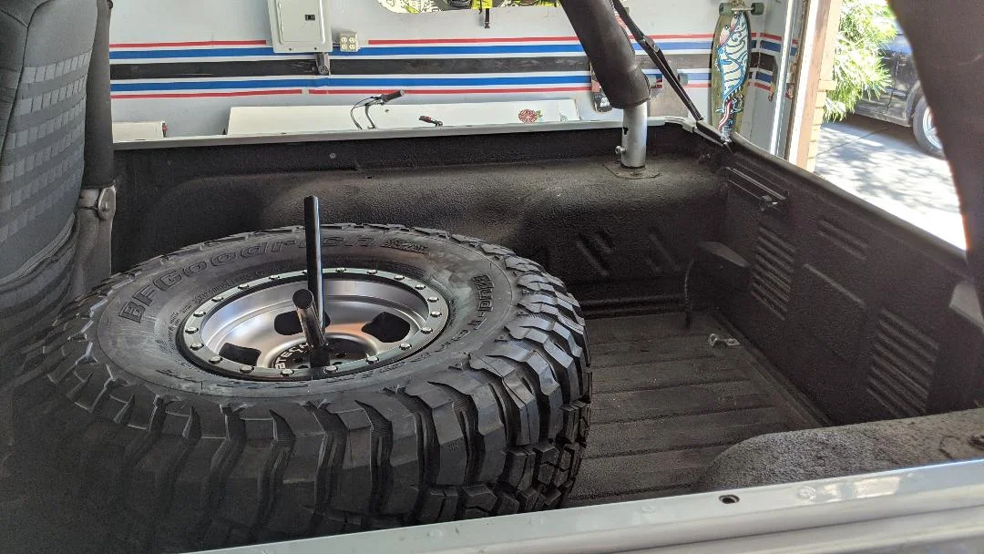

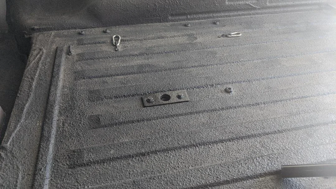

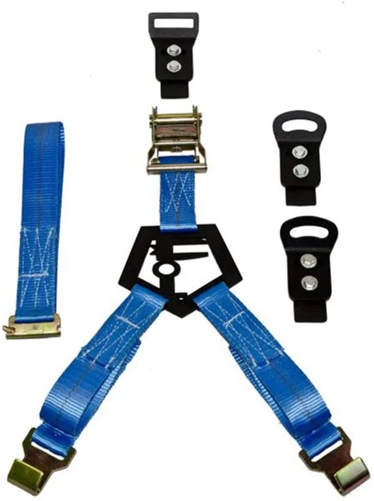

I use this. I documented the install in more detail on pg 5 of my build thread.
https://www.amazon.com/dp/B000CEQD5K/?tag=wranglerorg-20
I mounted it to the tub. It holds the tire in very securely.
When I remove the tire, this is all that shows. I could reinstall the seat and You'd never know it was there.

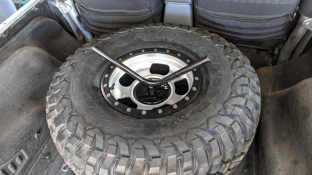

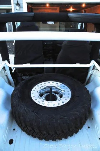

I ran kine in the tub for awhile last year.
I drilled a 5/8” hole in the tub forward if the centre seatbelt mount. Used a piece of 1/4” x 1-/2” flat stock about 2” long, drilled a 5/8” hole through the centre and welded a jut to the underside. Drilled 2 more holes at the end of the piece and bolted it to the underside of the tub. Laid the tire in position and used a piece of 1/2” ready-rod with a “tee” welded to the top. Took about 15 seconds tops to get the tire out without tools.
