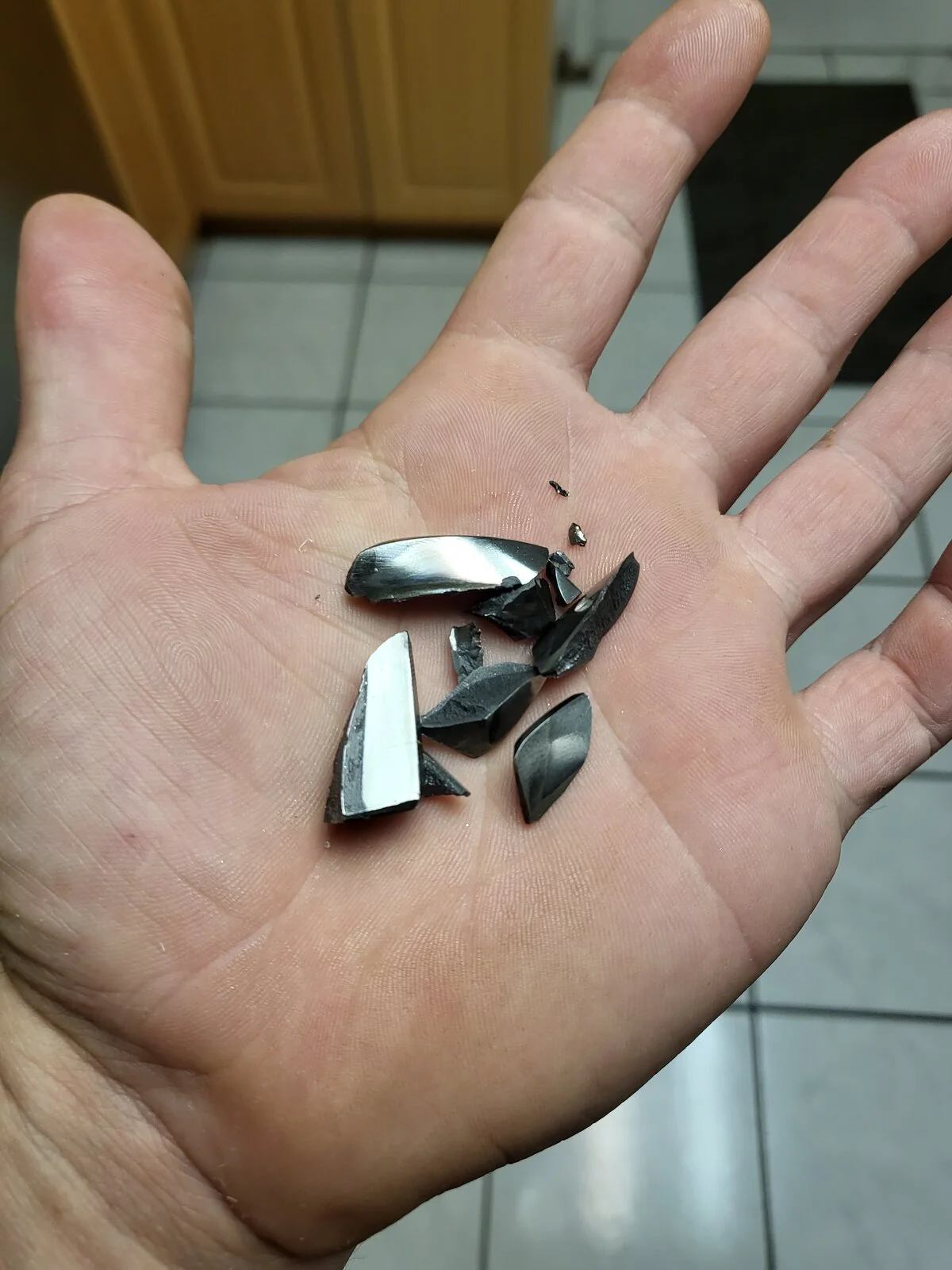

I think it started on the Dusy and then I finished it off at Hollister. The front axle would pop occasionally after I got back from the Dusy and I checked everything in the front end without finding the source. Then I took it out to Hollister and it started to pop more often just on the main trails and by the time I was done it sounded like a box of rocks..
I had already "regeared" to a 4.10 and definitely wouldn't put something taller in there as that would just make it weaker. Also 4.10 gives me about 2850rpm at 70mph which feels pretty good to me.
Sucks to hear.
I finally got around to repairing the couple Dusy issues this last weekend myself. One thing I didn't notice until I was crawling around under there, my front drive shaft was rubbing on the transmission pan.:confused:
All those worn out bushings and loose bolt let the axle shift a lot. Might have to drop the pan and bend the lip back flat if it keeps leaking.
