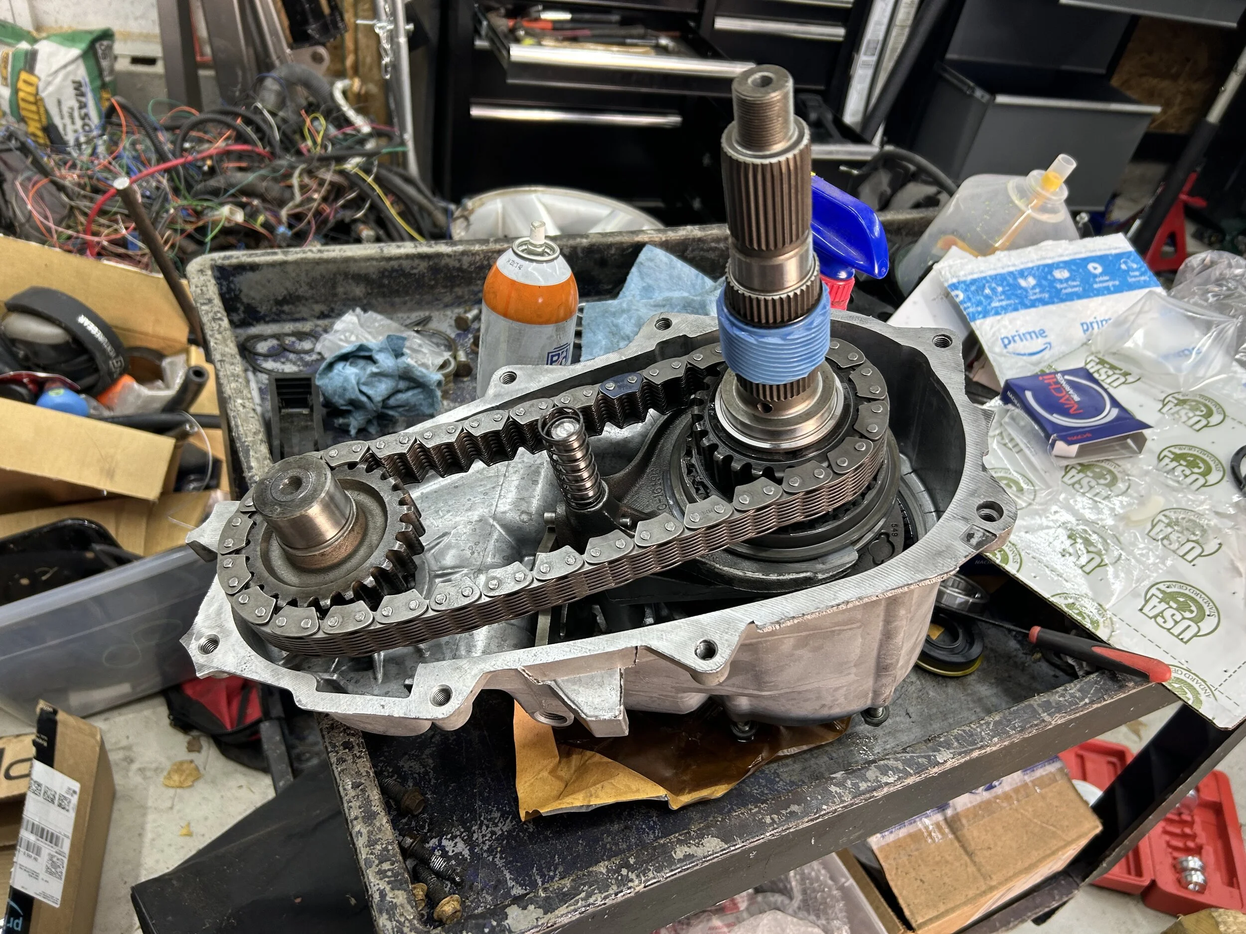

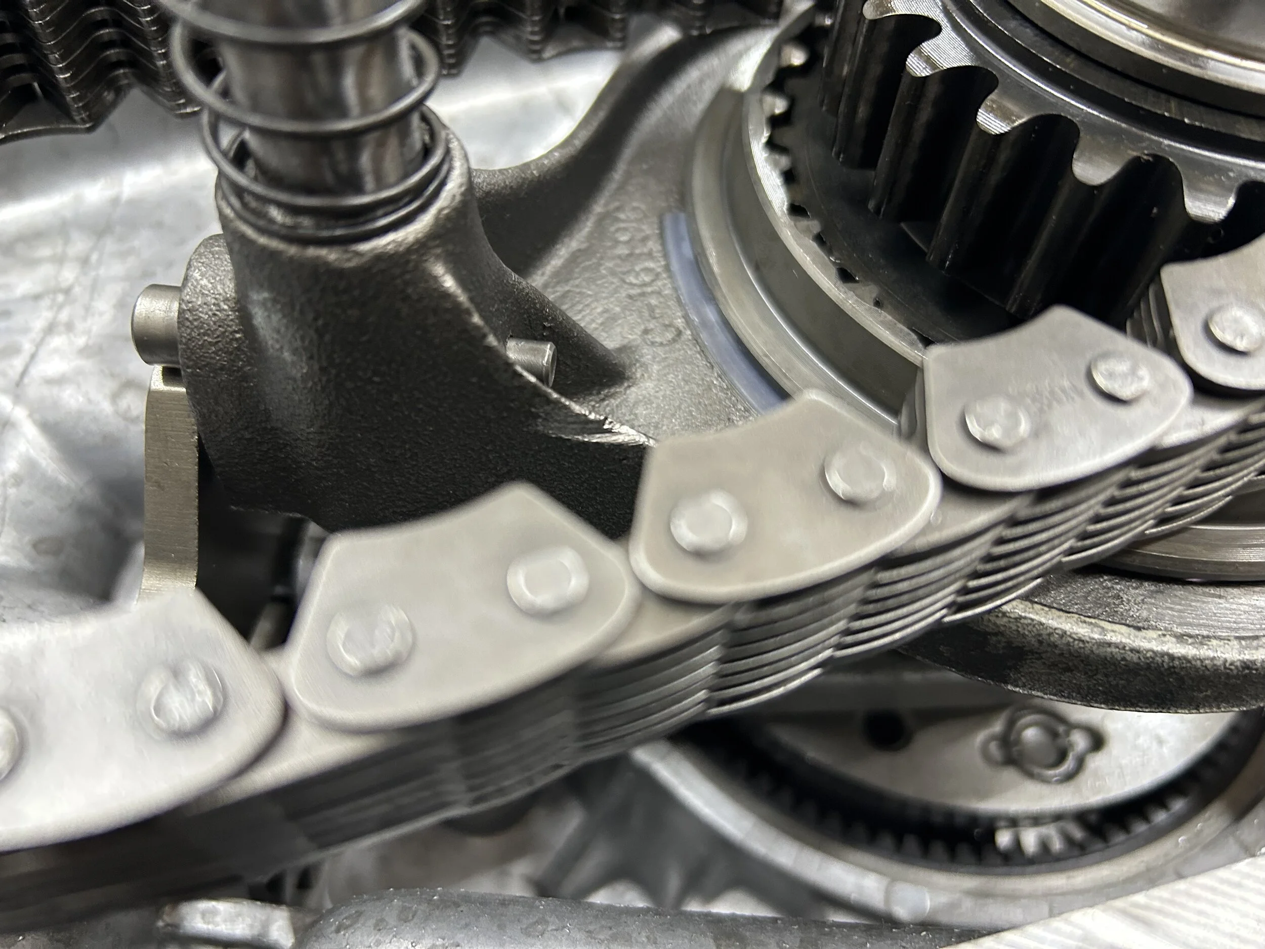

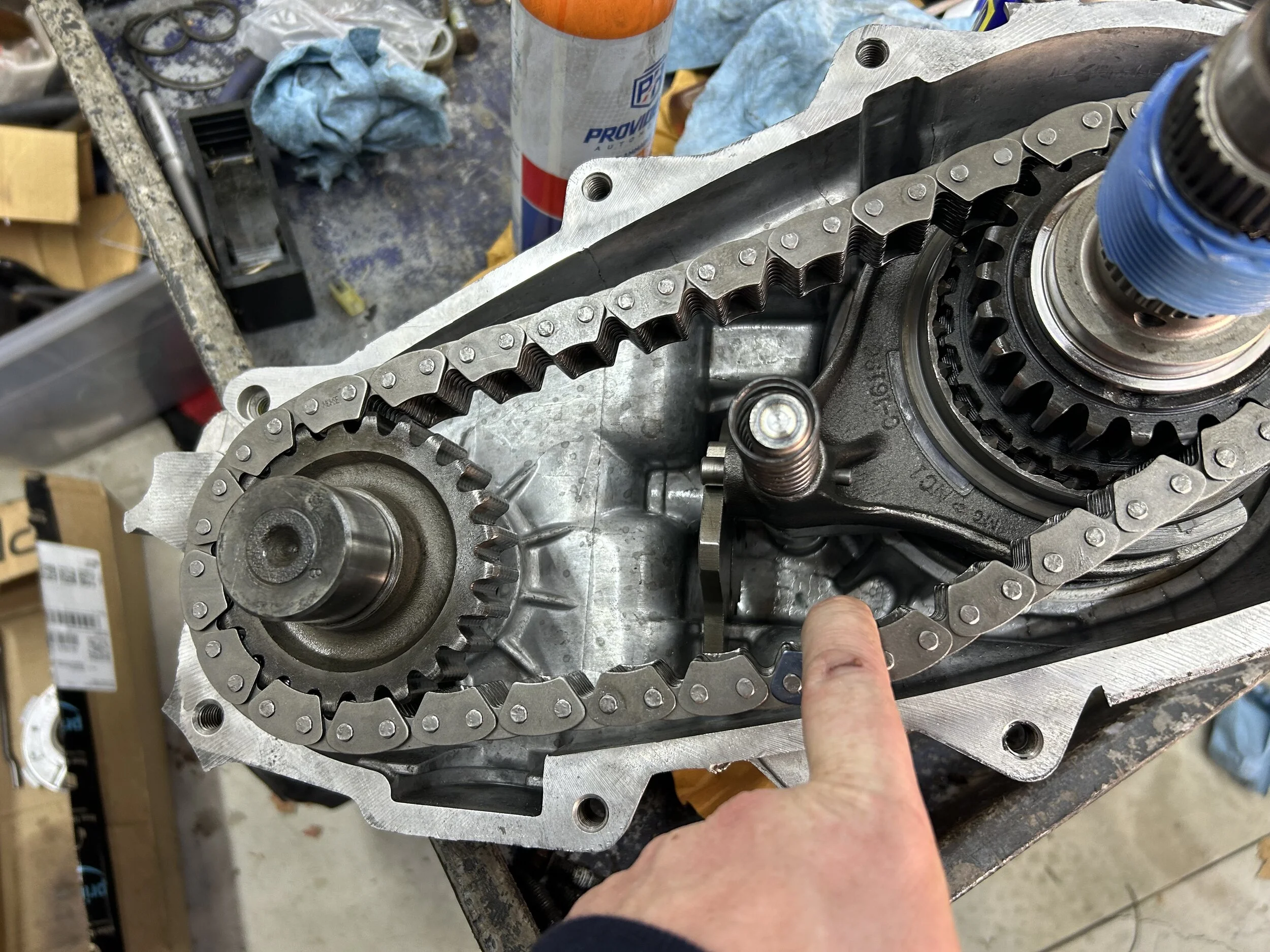

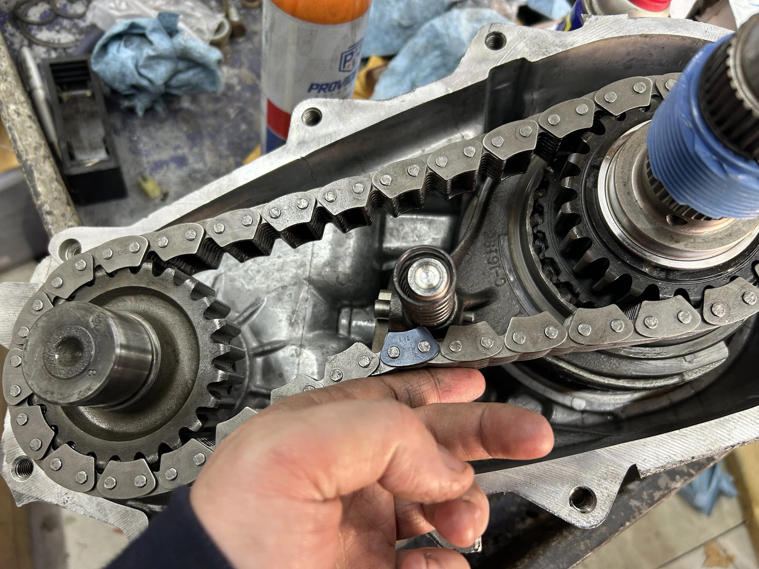

Does these seem like too much chain slack? When pulled up it hits the shift fork tower, when pulled down it does not hit case. I looked up a few videos about chain slack, they said if the input shaft was locked in place and you can turn the front output 1/4 turn while in 4wd its too loose but I dont even get an 1/8th of a turn on output.
It's going to be loose without the other half of the case attached. You are most likely fine
