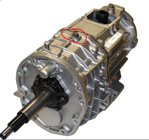

I spoke to midwesttrans.com the other day and they say confirmed that there is two vertion of the NV3550. As I explained; rockauto have two different kits for rebuilding the NV with two different sizes for the countershaft bearings...
1.18 inch counter shaft bearings
1.30 inch counter shaft bearings
they went on to say Jeep knew for sometime that there was an issue but continued to fit them with the 1.18 inch counter shaft bearings for a while. The cool part was that they showed me how to id the difference;
the vertion with the 1.18 inch counter shaft bearings has a countersunk bolt with a allen key head
the 1.30 inch has a hex bolt that's not countersunk
