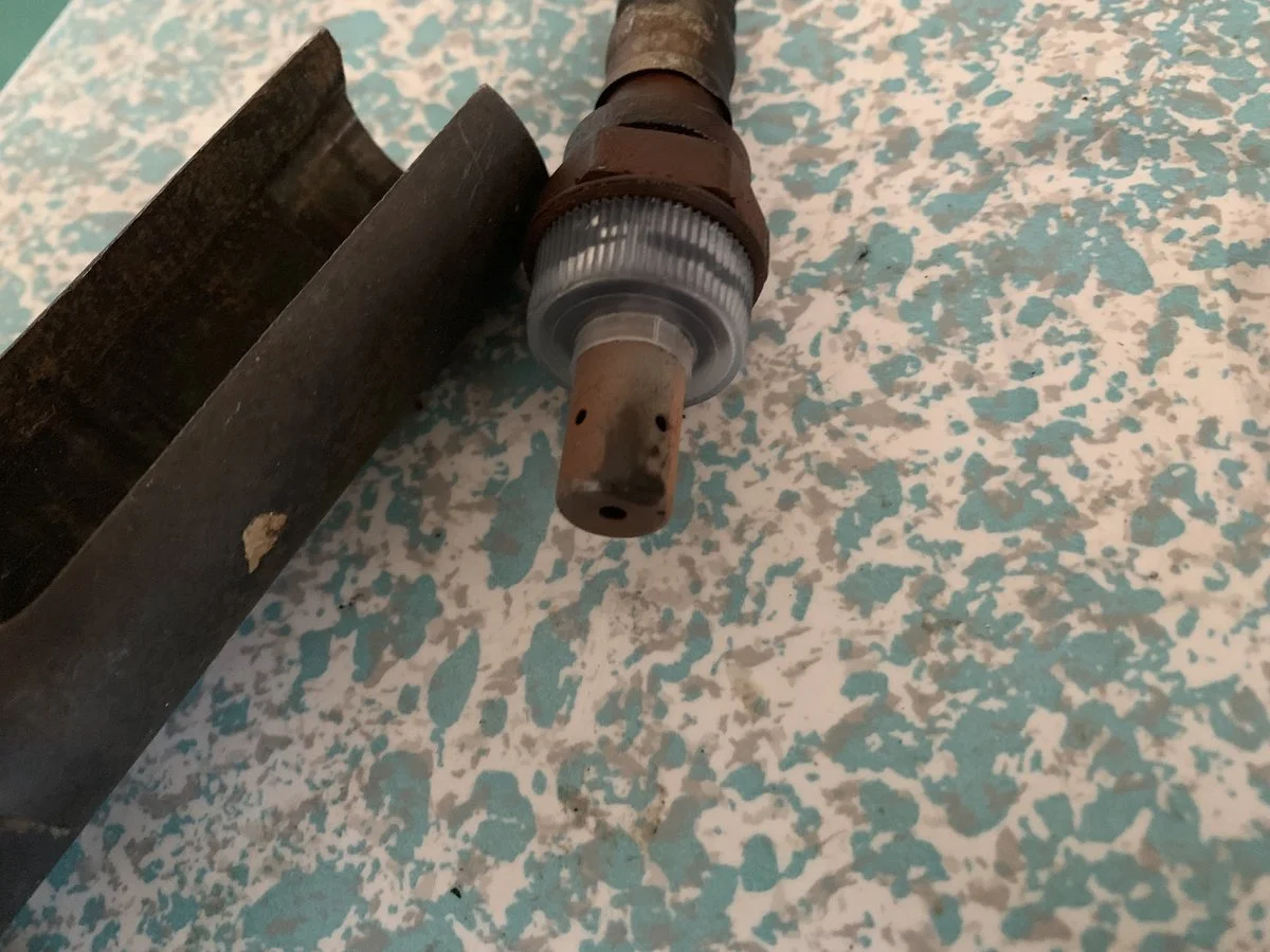

Ok, I changed the upstream sensor today. Took it for a drive down the street and back and it seemed to be more peppy then before, but I honestly can't say if it was the sensor that made it feel that way, or the fact that I have been driving my heavy 4 cyl PT cruiser for the last 2 days. LOL I will have to wait till I actually drive it around town to see how much of a change there is or isn't.
Here is the old one.
