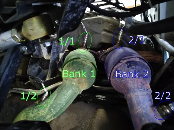

The FSM diagrams are only so good and they don't show where the plugs are. Fortunately, the wiring harnesses are short. Unfortunately, one of the plugs is hard to get to. Here's where the O2 sensors are:

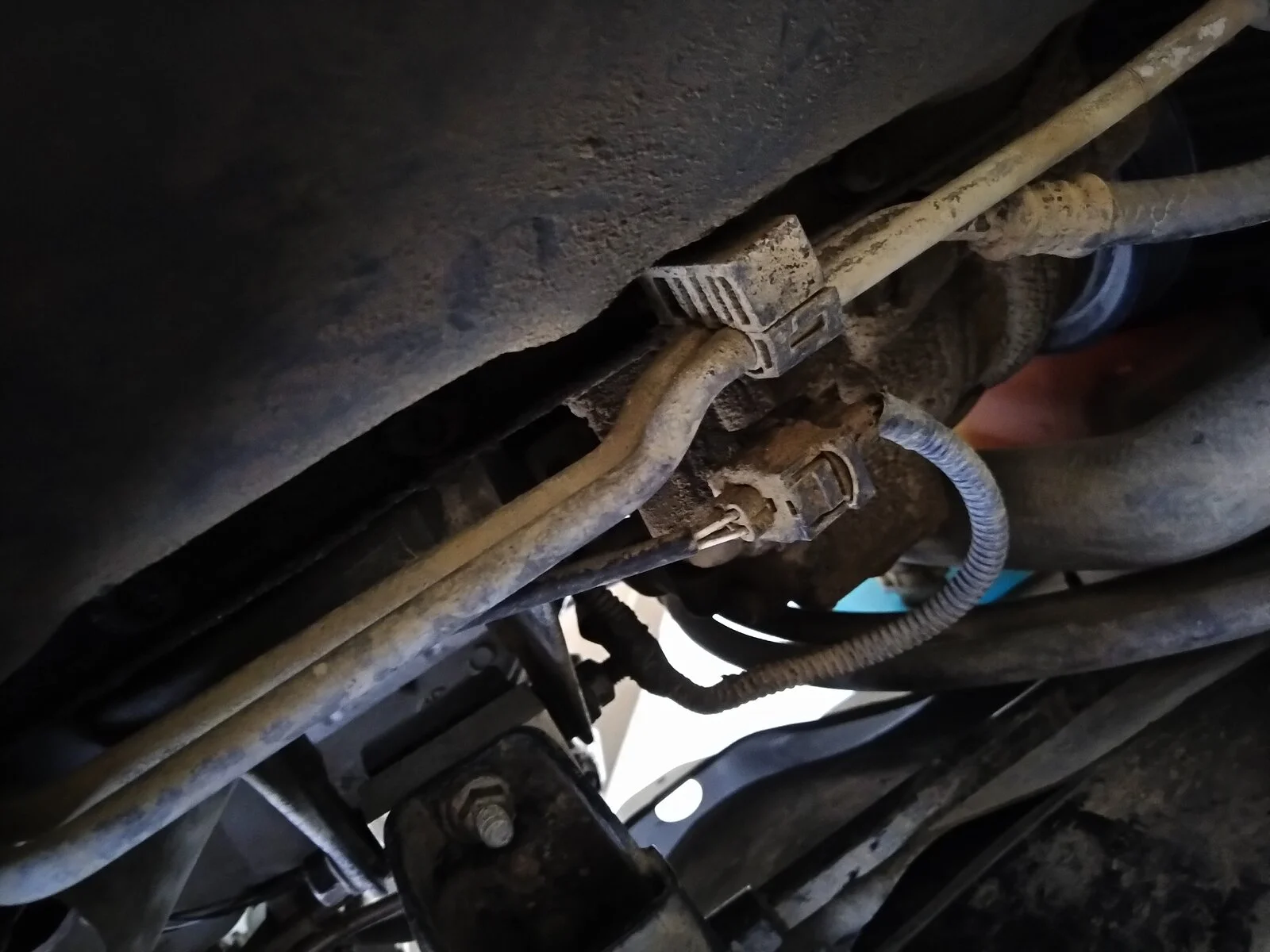

The 1/1 and 2/1 plugs are on the plastic rail that runs along the intake manifold, with 1/1 at the front and 2/1 at the rear.
The 1/2 plug is below the driver's side motor mount. And the 2/2 plug is mounted right on top of the forward end of the transmission — which makes it really hard to reach.

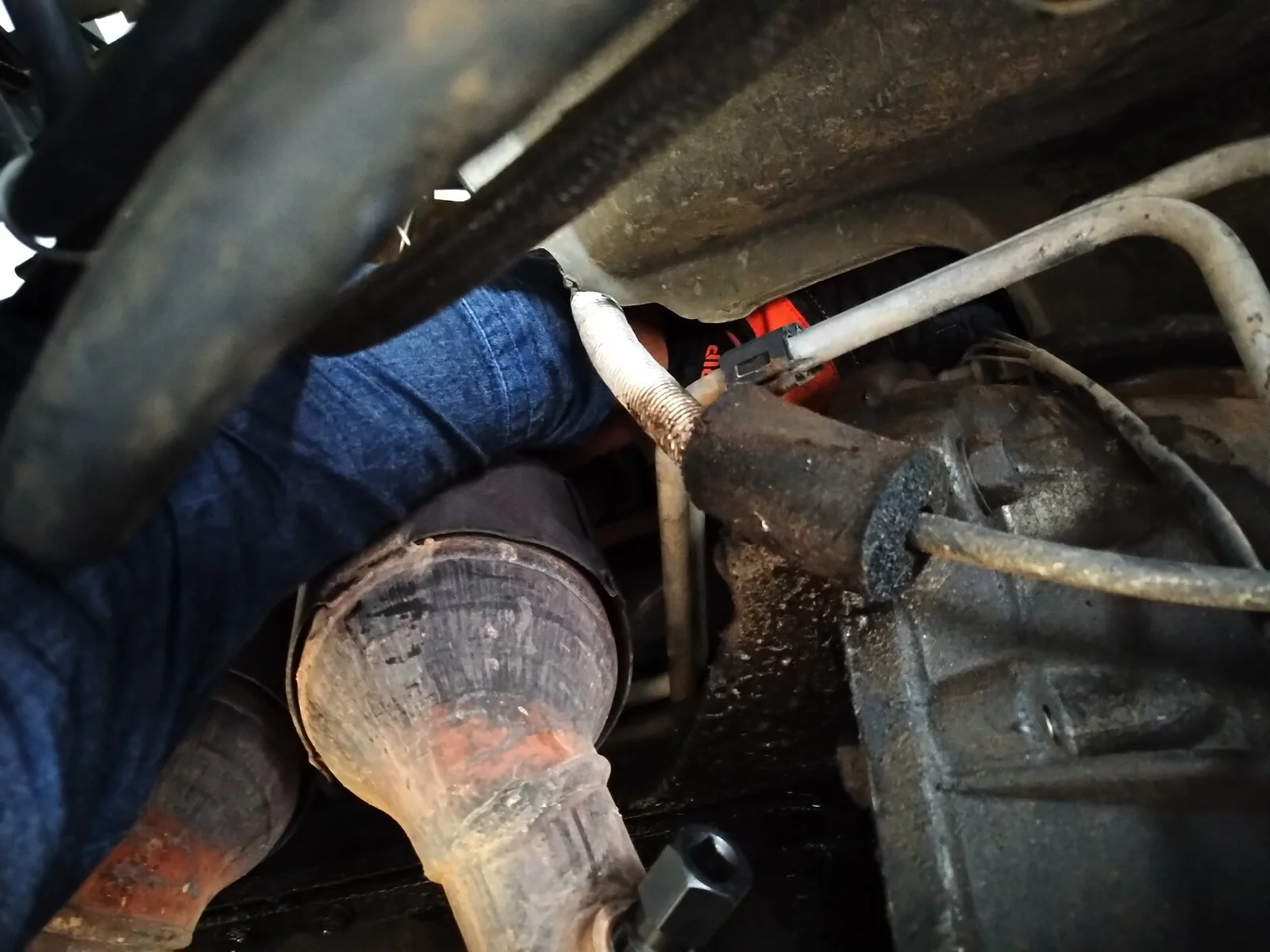

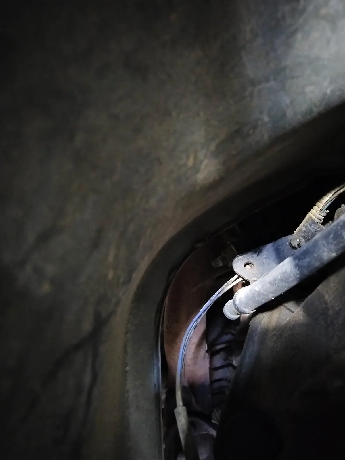

Unhooking the plugs takes two hands, one to release the catch and another to pull the plug apart. The only plug that's tricky is the 2/2 plug on top of the transmission. If you get right under the Jeep, you can snake one hand up next to the Bank 2 cat to release the catch and get another hand up over the transmission to pull the plug.
I'm using a glove in this picture, but I recommend doing this with bare hands so you can tell what you're working with.

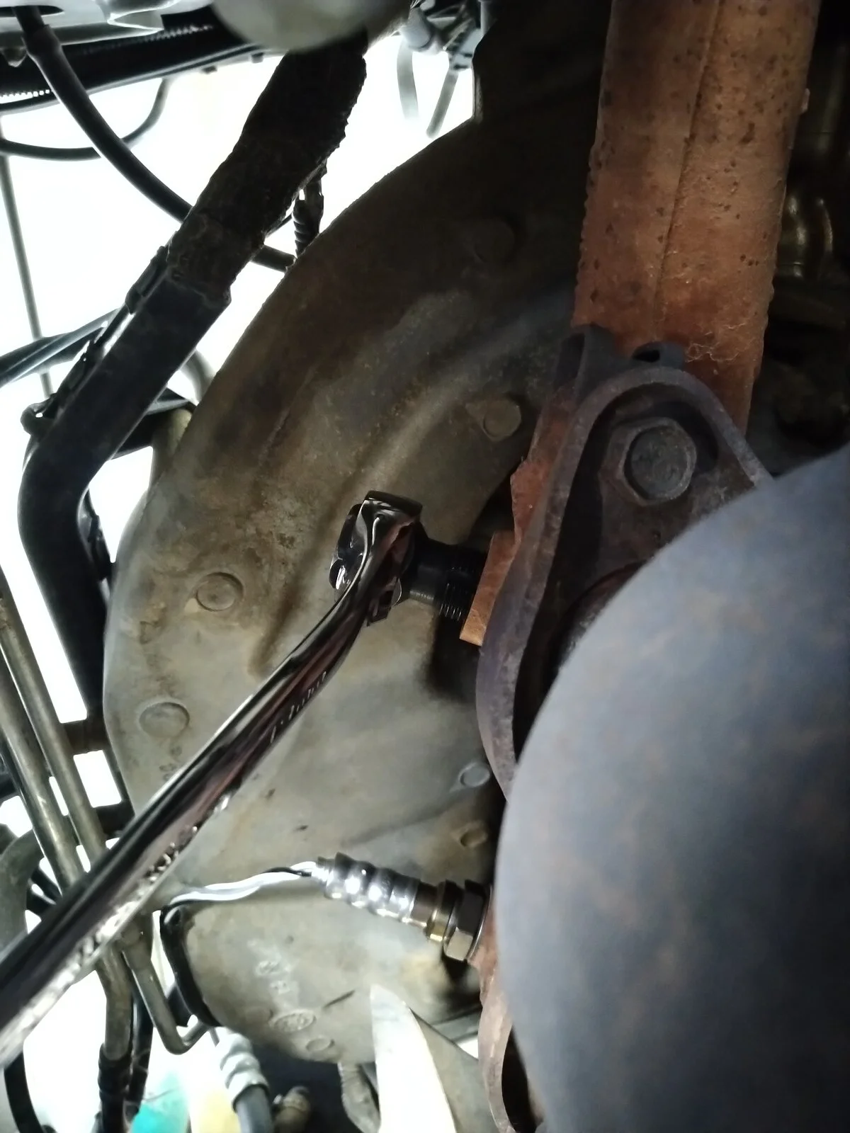

Step 4: Chase the threads.
It's easier to do this with a box end wrench so you can work the tool back and forth without having the wrench slip off.

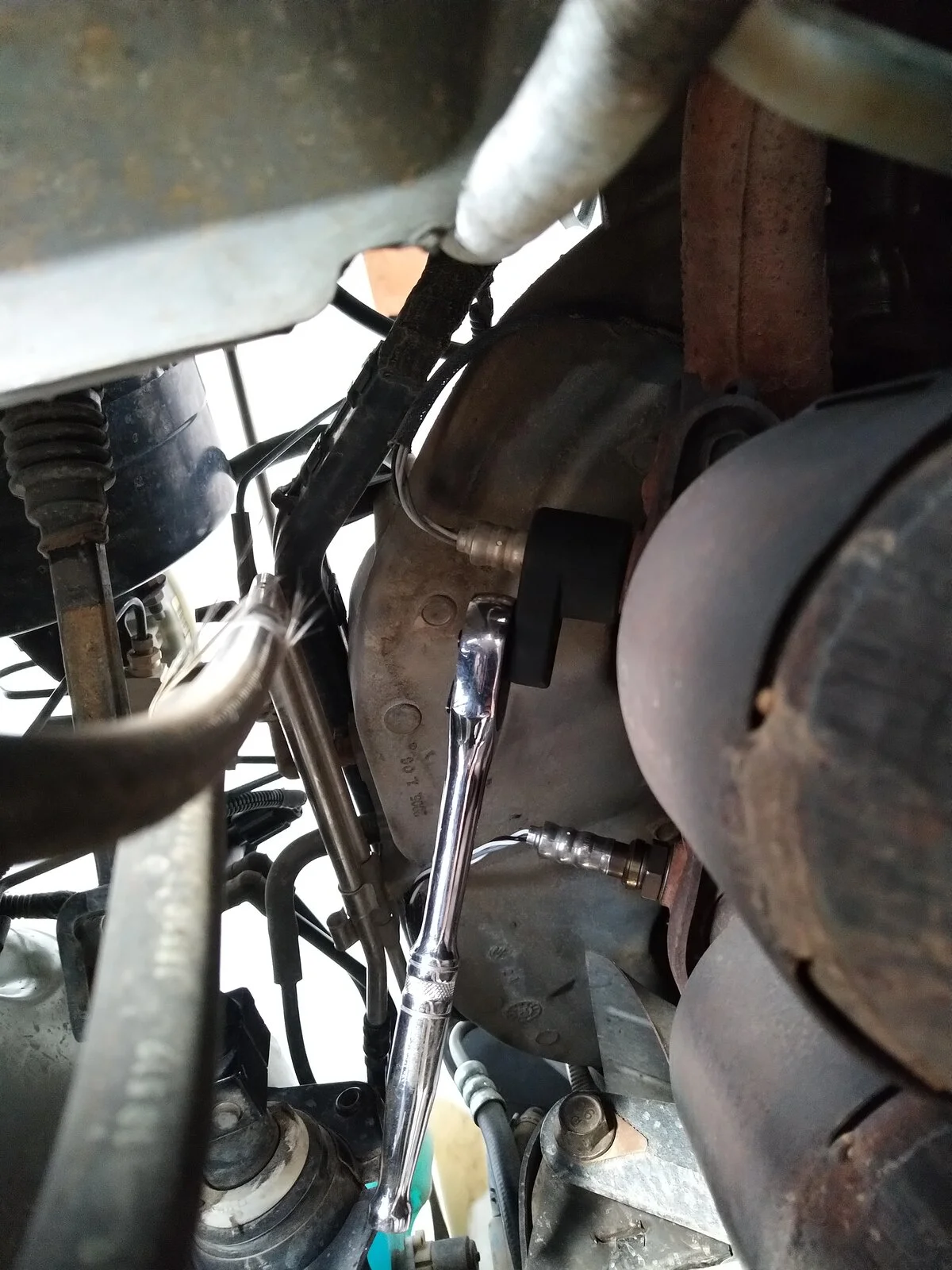

Step 5: Install a new O2 sensor.
Make sure you have the right O2 sensor for the position it's being installed in. The plugs are keyed, so you can compare the old and new plugs. Also check to make sure the harness is the right length.
The instructions in the NGK/NTK box say to hand tighten then add 1/2 turn with the wrench. FSM says tighten to 22 ft. lbs., which is probably about the same.
I know some people suggest adding anti-seize to the O2 sensor threads, but both the FSM and NGK/NTK instructions advise against this. The O2 sensors should already have anti-seize already on them from the factory.

Removing the plug on the 2/2 sensor is a PITA. Is there a trick to it? I have a stock 06, slid under the jeep with a creeper and don't seem to snake both my hands to unplug the connector
Yeah, that one is a pain. Do it with bare hands so you can tell what you're doing. And if you get in just the right spot with your feet toward the passenger side you can get one hand up next to the Bank 2 cat and another hand up over the transmission. That way you can release the catch with one hand and pull the plug with the other hand.
Reactions: bobcat
Yup, no fun. All I can say is to keep at it. I had one hand coming in from a different passage than the other.
Approaching the beast with the feet on the passenger side was the the turning point. Thank you for that tip @fuse .
