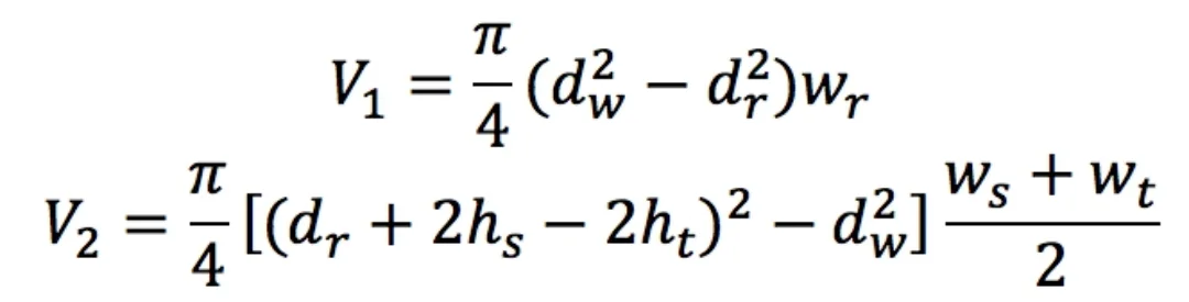

What is the volume of a 35" tire on a 15" rim?
https://www.quora.com/How-do-I-calc...share=046ff39d&srid=YooY&target_type=question
