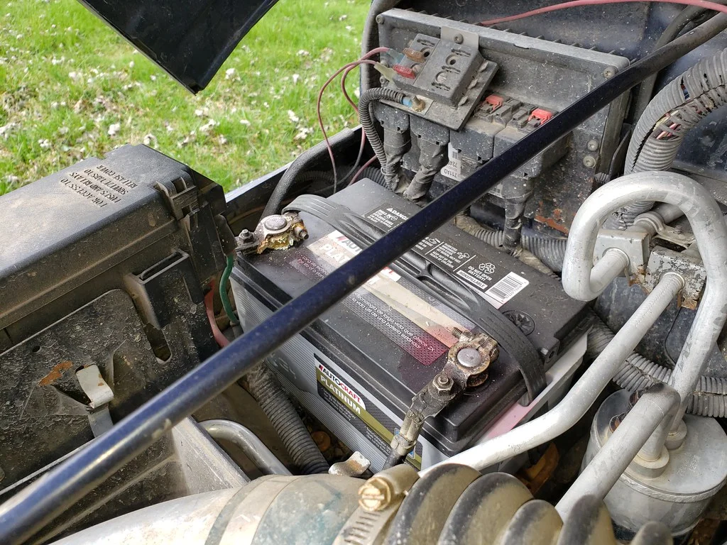

Sounds like a ground issue - (not sure about the bubbling sound). Your Negative terminal looks pretty corroded. Take it off clean it up and secure it nice and tight then see if it happens again.

So, I went out and took a look and some pics for ya.

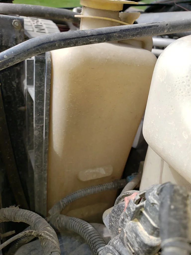

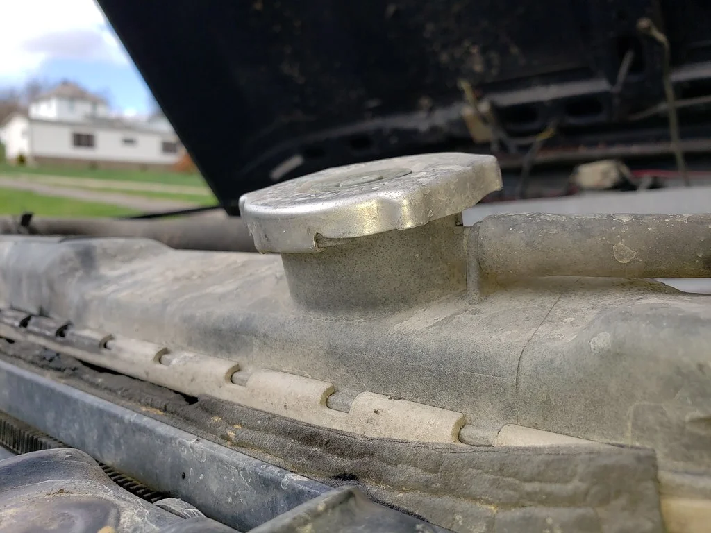

The coolant level looks fine in the overflow reservoir. The radiator cap was on nice and tight (though I think I'll get a replacement just in case).
Battery terminals had a bit of corrosion on them. The battery is practically new (less than 6mos old) and the guy at Advance put it in for me. Put the anti-corrosion stuff on the terminals and all.
Clean your battery terminals and cable clamps. Those are corroded, especially the positive terminal.

Went out this morning to do some running around for the family. Was coming down the hill to my house and the check gauges light came on - looked over and the coolant temp gauge was pegged.
Thankfully I was right in my driveway and shut it off. Immediately heard some very aggressive gurgling coming from the overflow bottle.

I'm going to give it a minute and see if the coolant level in the overflow bottle is low. If so, then I've got a good leak - if not, then I think the radiator cap or something is the issue (vacuum or something).

I put about half a jug of coolant in it (apparently I the line I thought it was on wasn't it) and now it's to the full mark. Also replaced the radiator cap with a new one.
Turned it on, warmed up to temp and was still climbing past the mid-point. I shut it off before it got to 3/4 on the gauge (don't want to do anything bad to it).
This time there wasn't much gurgling going on - nothing nearly as aggressive - and it was much harder to hear. There also wasn't any dripping underneath or anything pooling under the jeep - so I don't think I have a leak. It wasn't leaking inside the passenger footwell either, so I'm hoping that means I don't have a heater core leak.

The positive battery needs cleaning to remove corrosion. Take hot water and pour it on the corroded terminal and it will disolve it. Then pull the battery terminal and clean post and terminal. Also you should take cable to terminal connection apart and make sure it's clean with wire brush and is tight.
