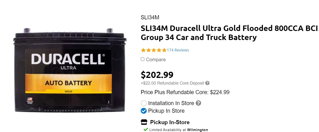

happy with Duracell for the short time I've owned it

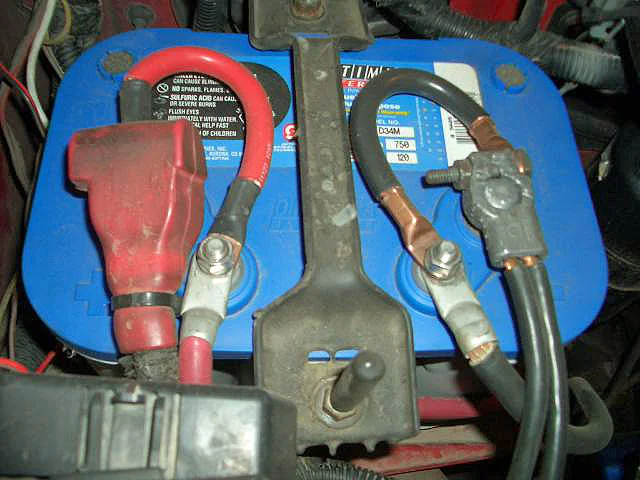

I don't know if it's true for all batteries, but I've seen that it is not recommended to attach a winch to the front terminals.
Definitely true for many like Optima but an Odyssey rep told me their front terminals are up to being used for winching. There's a way to still use the front posts for a winch by adding a pair of 2 gauge jumpers between the top and aux/side posts like I did on both of my previous Optima Yellow and Blue Top batteries.
