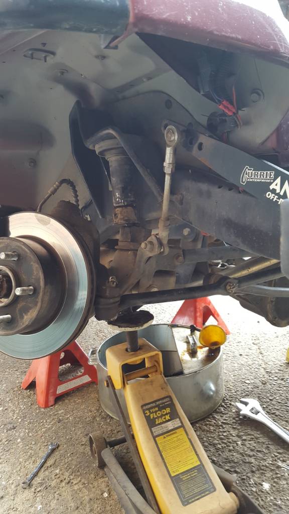

Why not pull your springs and jounces and cycle the suspension to determine your bump stop extension? This takes all of the guess work out of setting up your suspension.
With 33's, OME shocks, ZJ tie rod and MC front track bar I needed 1.375" extension up front to keep the tires out of the steel fenders at full flex. In the rear (with the factory track bar w/ relocation bracket) I needed 1" extension to keep the shocks from over compressing.
Whatever bump stop extensions a kit provides will, at best, only be a conservative guess. Make your own and make them as only as thick as they need to be.

View attachment 32287View attachment 32288
What exactly are you looking for when testing this? Going to be buying Rancho/OME combo and not sure what to buy for bumpstops
You are looking for parts that crash into each other. After that, you can select a shock that will divide it's total amount of travel on half from the normal ride height. Adding bump stop keeps shocks from over compressing and keeps other bits and pieces from damaging other bits and pieces.

The compressed shock is the limit to up travel. Extend the bump stops to closely match the compressed shock and make the soft jounce do it's job of slowing the last bit of suspension travel. The springs need to be removed and the axle fully cycled with a floor jack to find this.

It will vary from vehicle to vehicle. You’ll have to cycle the suspension as @jjvw pointed out if you want to do it right.
Collapsed shock length, tire size and fenders determine bumpstop amounts.
2-2.5" lifts typically have a 13.5/22.5" front shock length. 13.5" collapsed shocks operate on stock bumpstop extension which limits tire size to 31" under stock fenders, as well as metal cloak and any other flat fender that doesn't require the hood to be cut. there's no bolt on aftermarket adjustable track bar on the market that can be used without adding a minimum of 1.75" bumpstop extension, that track bar is rough country forged 0-3.5"
14.5" collapsed front shocks match 1", 15.5" collapsed front shock length matches a 2" bumpstop extension and clears a 33" tire under stock fenders. The stock flares will still rub tires.
15.5" collapsed rear shock length can require a 3.75" bumpstop extension, it's a different situation than the front as the compression ratio is not 1-1.
14" collapsed rear shocks match a 2" bumpstop extension in stock mounts, track bar relocation brackets require a 2" rear bumpstop, this includes the ome kit bracket that only comes with a 3/4" bumpstop, 2.5" rear lift springs have a 5.5" stack height which also requires a 2" bumpstop extension.
Ultimately, it's best to cycle the suspension for other clearance issues such as track bars, steering, exhaust, driveshaft and those with short arm links stretched out longer than 16", but there's no mystery to what shock length or tire size needs which bumpstop amounts, they are all the same. A body lift and highline fenders can compensate for bumpstops where tire size alone is a concern.
