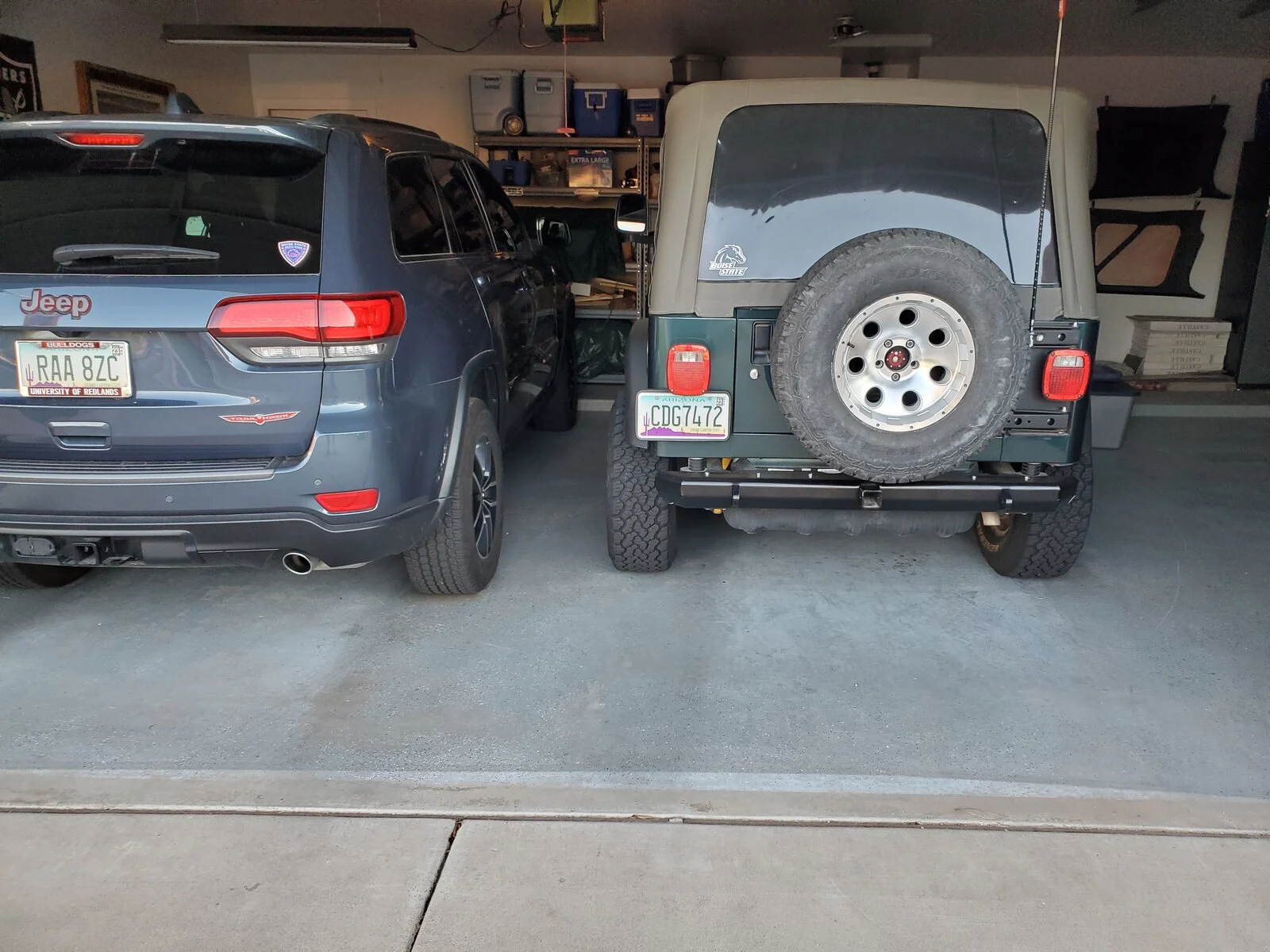

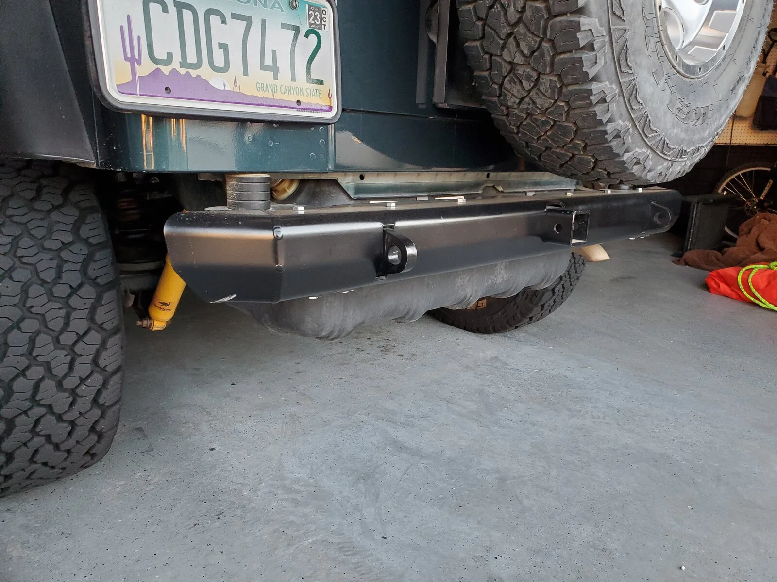

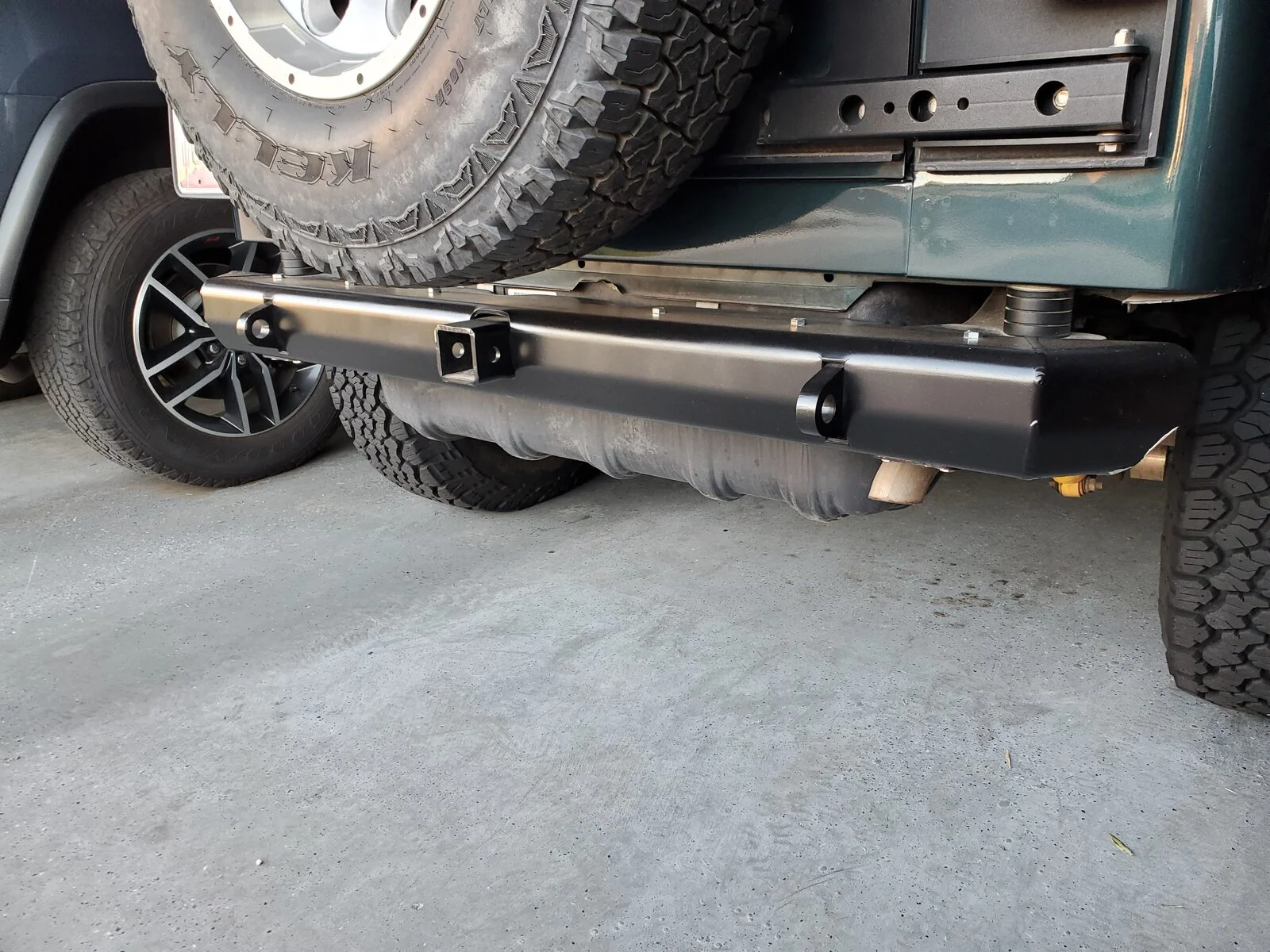

Light duty OME springs both F/R. 4.0 42RLE, stock front bumper, no winch, UCF aluminum/steel hybrid rear bumper (~36lb), MORryde spare carrier, 31/10.5/15 spare, no rear seat, soft top and empty cargo area ~2.5" lift (with a 10mm spacer up front to level the rake).
Can you post your rear bumper? (Please remember we like the forum to have family friendly content😂😂)
Reactions: John Cooper
Not sure how I feel about requests for pics of my backside 🤣

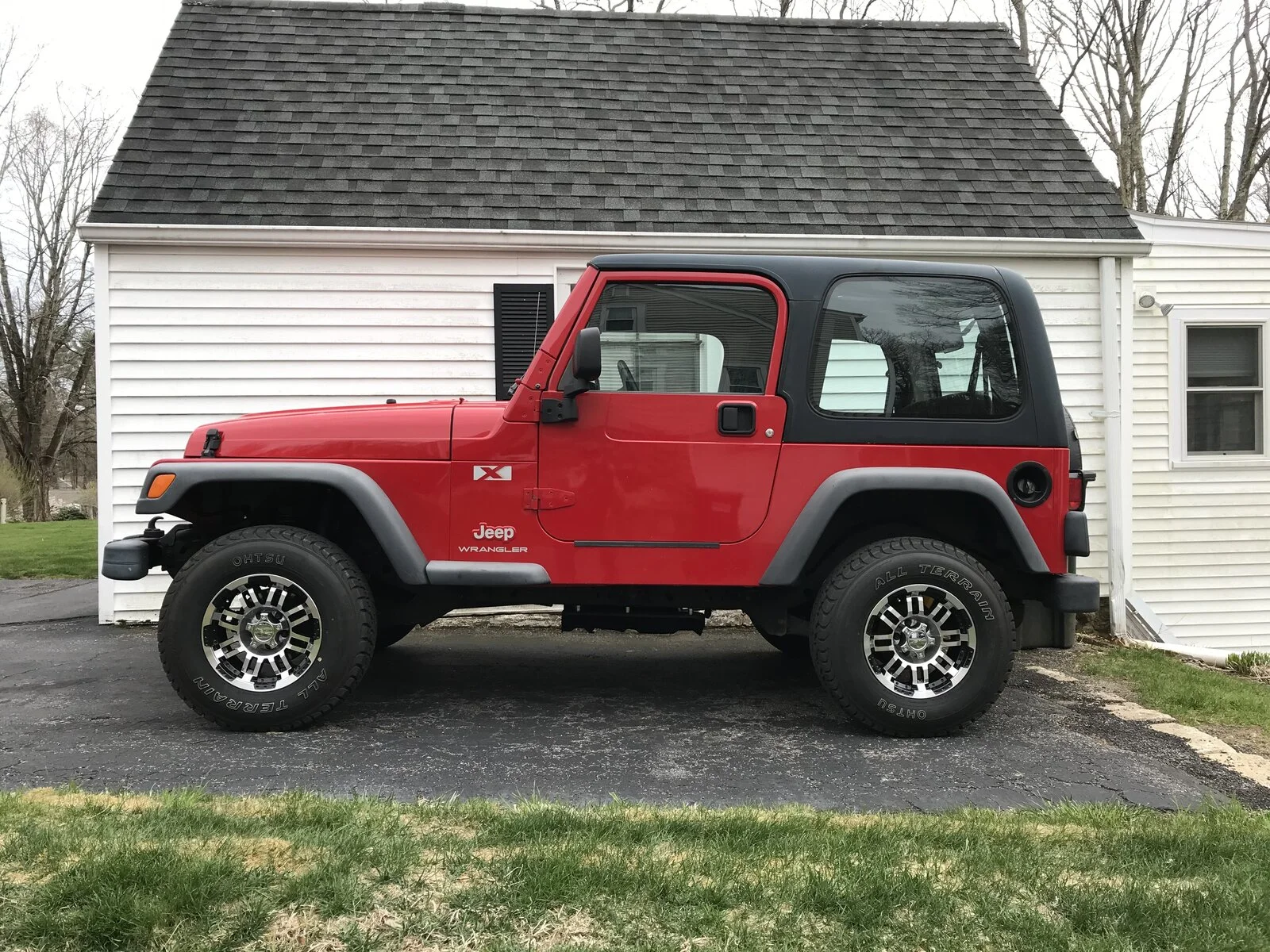

OME 2941 Rears, 2932 Fronts, stock bumpers, rear seat, hard top, no winch, picture is with 30" tires, currently running 31" tires on canyon rims.
And 1" transfer case drop :(. Working on that next year.

Thank you that company is here in Alabama and I like their products- Thank you very much for taking time to do that- That is the perfect blend of looks and function and all around size and weight- I’m good with $514 for that- How much was it on sale
$397 out the door shipped here to AZ. Listed at $467 at the time, so 15% off and 'free shipping'.
I ordered mine raw, then used Rustoleum self etching primer, followed by Ace Hardware satin black enamel spray, both rattle can.
If you're close enough to pick up, I'll bet you could shave a few $ off.
