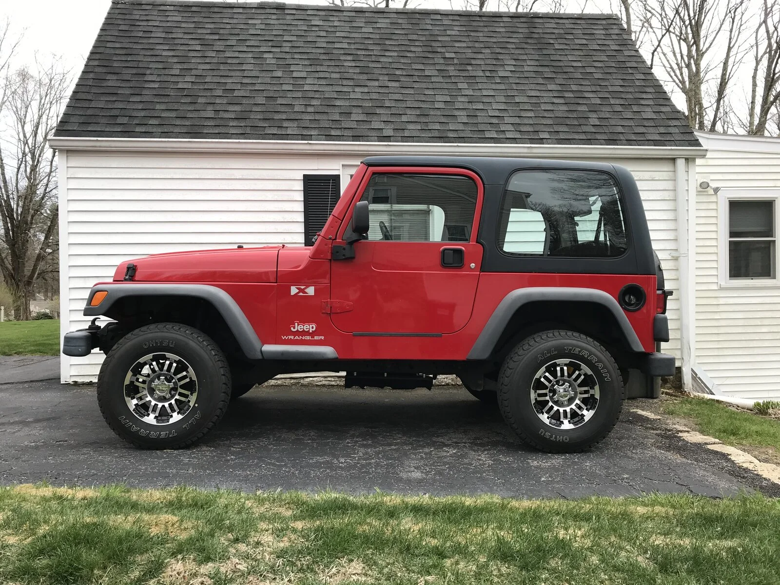

OME 2941 Rears, 2932 Fronts, stock bumpers, rear seat, hard top, no winch, picture is with 30" tires, currently running 31" tires on canyon rims.
And 1" transfer case drop :(. Working on that next year.

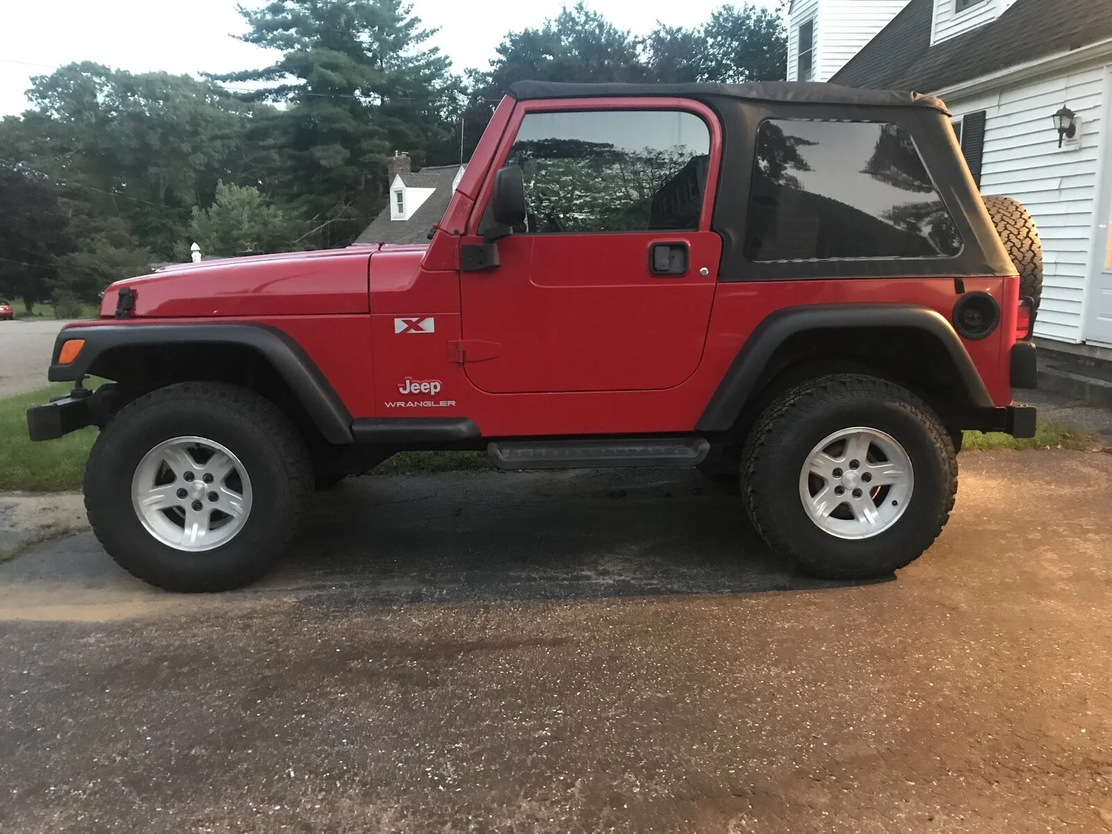

Hi, I am looking at doing the 2932 springs with 31's. Do you happen to have a photo of your jeep with the 31's?
This is from tonight. Frame less soft top, no rear seat, 31's. I currently have no pictures with the hard top and 31's. Hard top goes back on in October.
Hope this helps!
