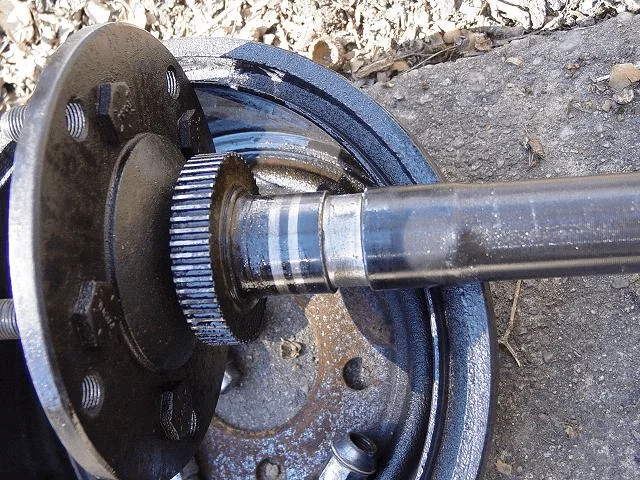

There should be a comment or two further back on case hardening. That is what you are looking at, or the lack thereof.
Your comment doesn’t explain what type of Dana35 shaft that is.
Stock? Aftermarket? What material?
How long was it run?
Like I mentioned in my previous comment, Alloy USA makes a 4140 shaft that carriers a 10 year warranty. Why would it carry that warranty if they knew the roller bearing would wear their shaft out?

For someone that likes to stir the pot and then debate the technical veracity of a lot of shit, you simply don't pay attention.
When is the last time you saw a stock dual drilled rear axle shaft with dual drilled bolt patterns? How about never? Is that indisputable tech for you?
If it is not stock since there are no stock dual drilled patterns, that makes it aftermarket. Is that indisputable enough for you?
When is the last time you saw a TJ rear axle with thread in studs? How about never? Is that indisputable enough?
Does it matter how long it was run since with just a smidgen of extrapolation based on the lack of stock shafts suffering the same issue that something must be different to cause the issue? Whatever could that be?
The reason that Alloy USA does shit like that is because they are like a lot of folks who simply don't pay attention to the importance of details and the nuance of product design. You can derive one of two assumptions as being true about their practice of offering 4140 Dana 35 shafts. 1-they aren't 4140 and they are stretching the truth a bit. 2-They are cheap enough that they don't mind sending out replacements when they fail. Neither makes 4140 a good idea or an acceptable material for shafts that have a bearing surface.

Don’t know why you feel this way. I’m just trying to learn. It was a simple question with no hidden agenda behind it.
You posted a pic with a vague comment and didn’t describe what it was showing. I was just asking about the shaft? I did notice it’s aftermaket, but the tone ring threw me off. And didn’t know aftermarket companies supply larger inner bore tone rings.
Again I’m still learning.
I sent you a direct message about the shaft. So you didn’t have to respond here...
