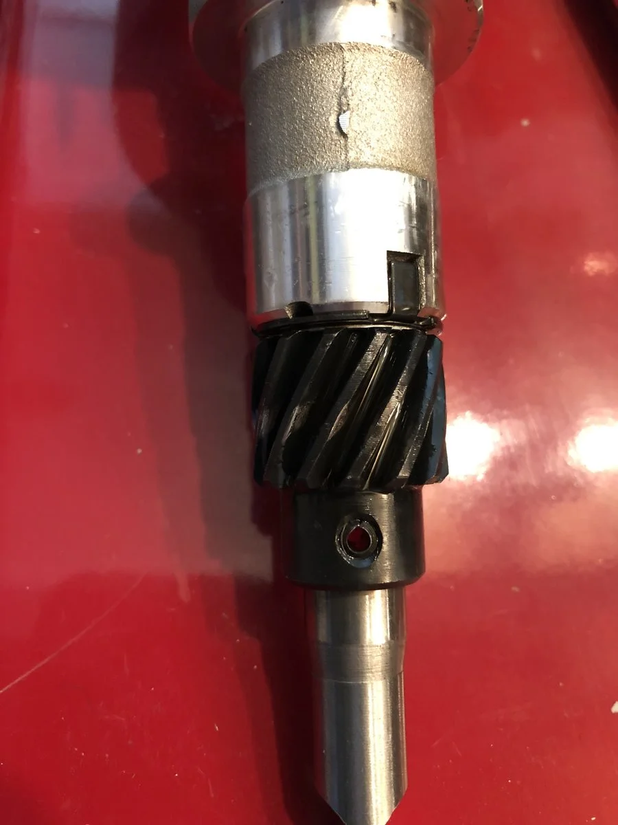

I had changed out the opda earlier this year and replaced the cam shaft position sensor twice, would go a few weeks with no issues then I would get P0340 and P0344. I removed the opda and reinstalled it to make sure I did it right.I'm still getting the same codes. Replaced opda with a crown unit and mopar sensors.
I had taken a picture of the opda when I removed it and was wondering if the wear on it is a problem.
I checked the wiring and didn't see any issues with it.
