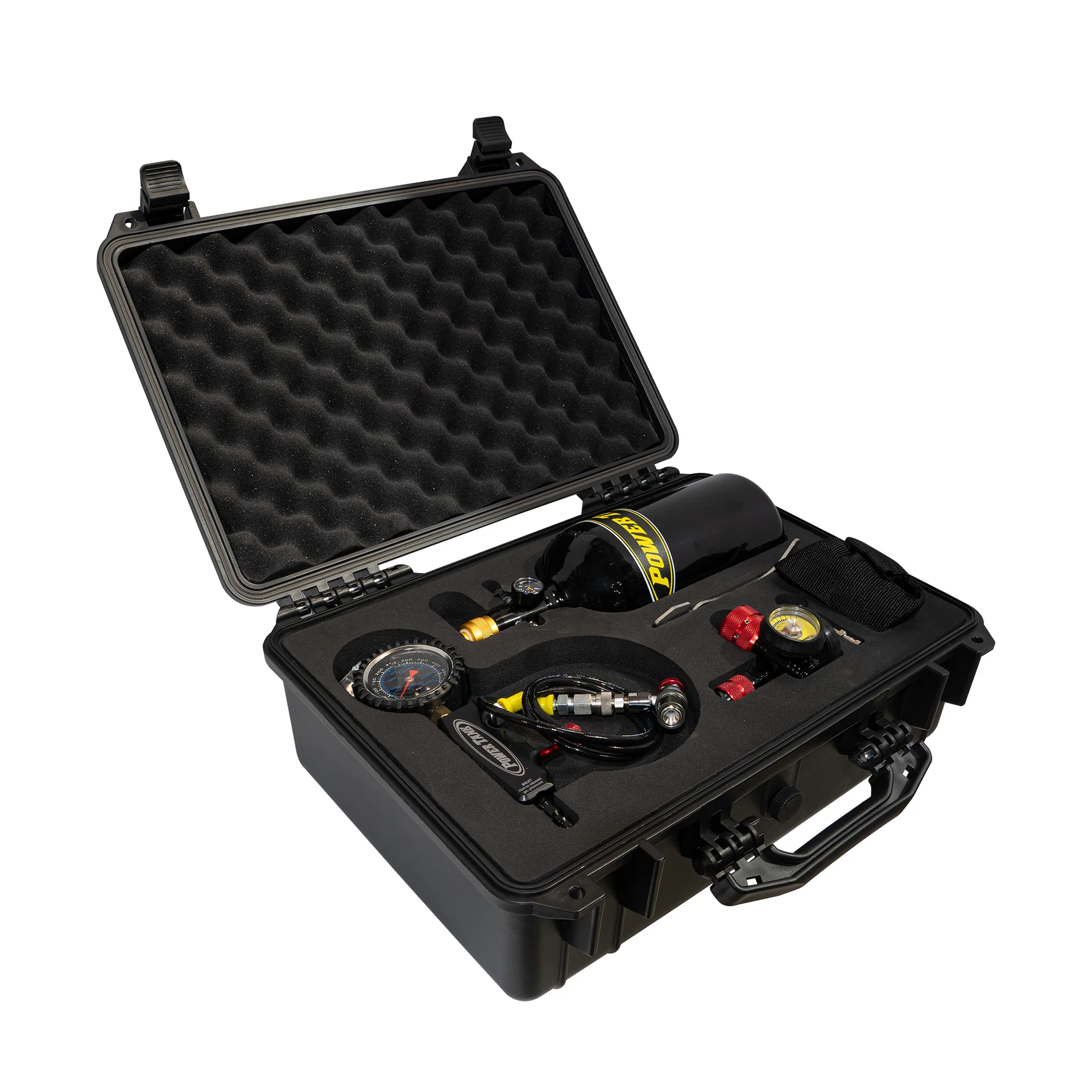

You should buy this so everyone has another reason to visit you
