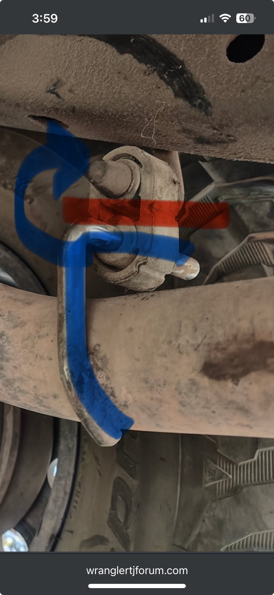

Ok...any suggestions for tucking this exhaust up another inch...do they make a tighter exhaust rubber hanger? I can move the hanger up but I'd only get a half inch and the rubber would be tight into the frame.

Cut the rubber where the red line is (cut it in half). Take the rod welded to the exhaust. Cut the end off that’s going through the rubber hanger. Weld it on the end above where the blue arrow is pointing.

Yeah that's hard mounting the exhaust to the frame. Like to avoid that. I'll find a lower profile hanger or French a bushing into the frame.

Maybe you could find something in this style where the rubber is part of the top hanger and it hooks into the exhausts hanger

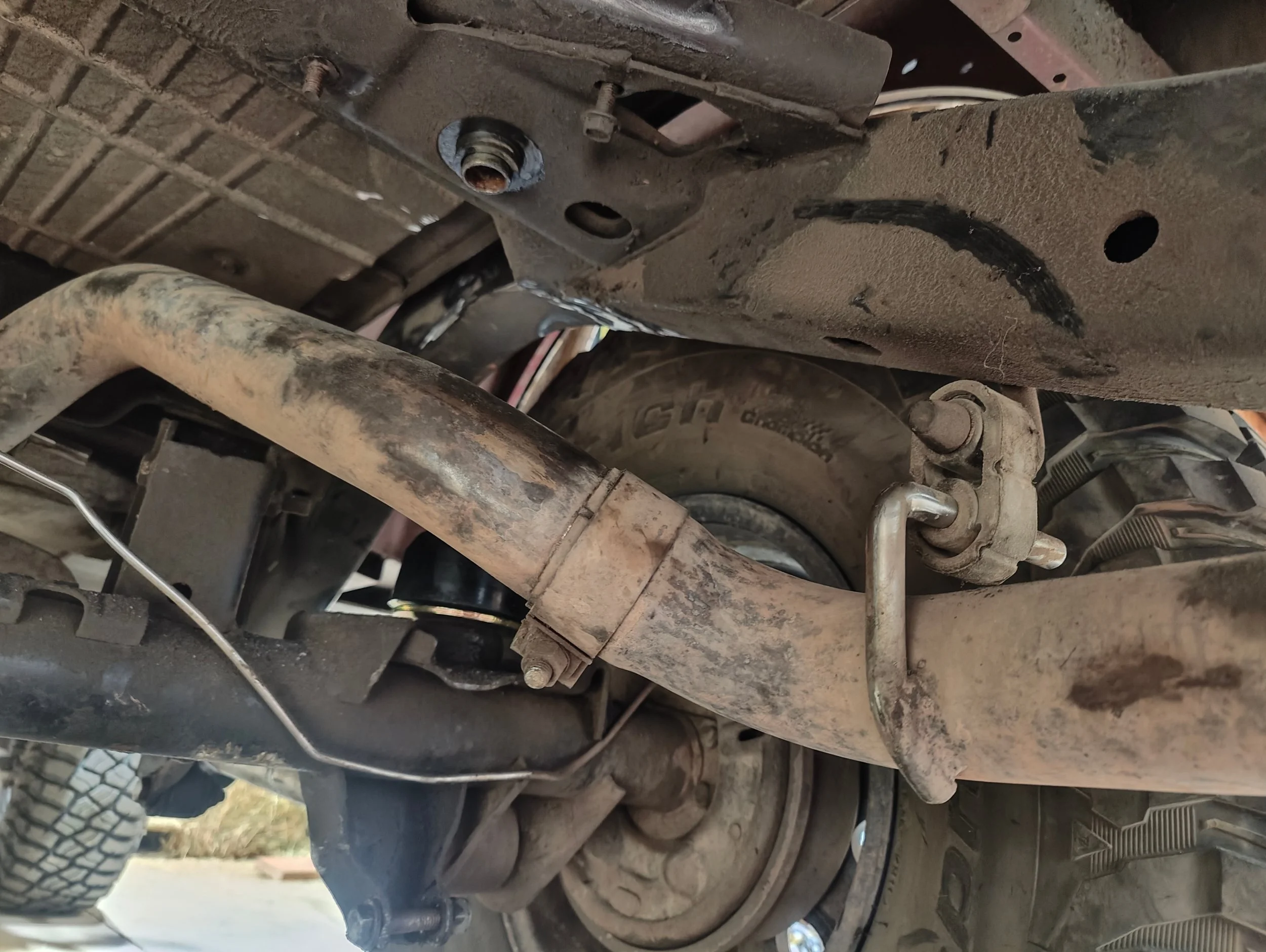

Almost wondering about drilling a hole, welding in some pipe, insert a rubber bushing...then push the hanger on the exhaust through the frame.
I think for now I'm going to tie it up out of the way and continue. I'll sort it out once the gas tank is reinstalled.

I'd grind the mushroom off the hanger welded to the exhaust and tap it 1/2-13, add a nylock...need to research melting temperature.
Insert hanger through frame and bingo.

That won't offer nearly as much movement as the current setup. Sab's suggestion above is best.
I agree. Mount compliance is more important in exhaust mounting than most other component-mounting points on a vehicle because exhaust is one of the largest, most rigid components that connect between body and chassis and because the high temperatures in the exhaust system are detrimental to load resistance. You could actually see cracks appear in welds at the engine end of the exhaust due to low-compliance mounting at the tail end of the system. There is a very good reason the OEMs use the same rubber mounts on all vehicles - they are designed for high compliance, and they prevent cracks. Whatever you end up doing, keep high compliance of your mounting system as the primary objective.

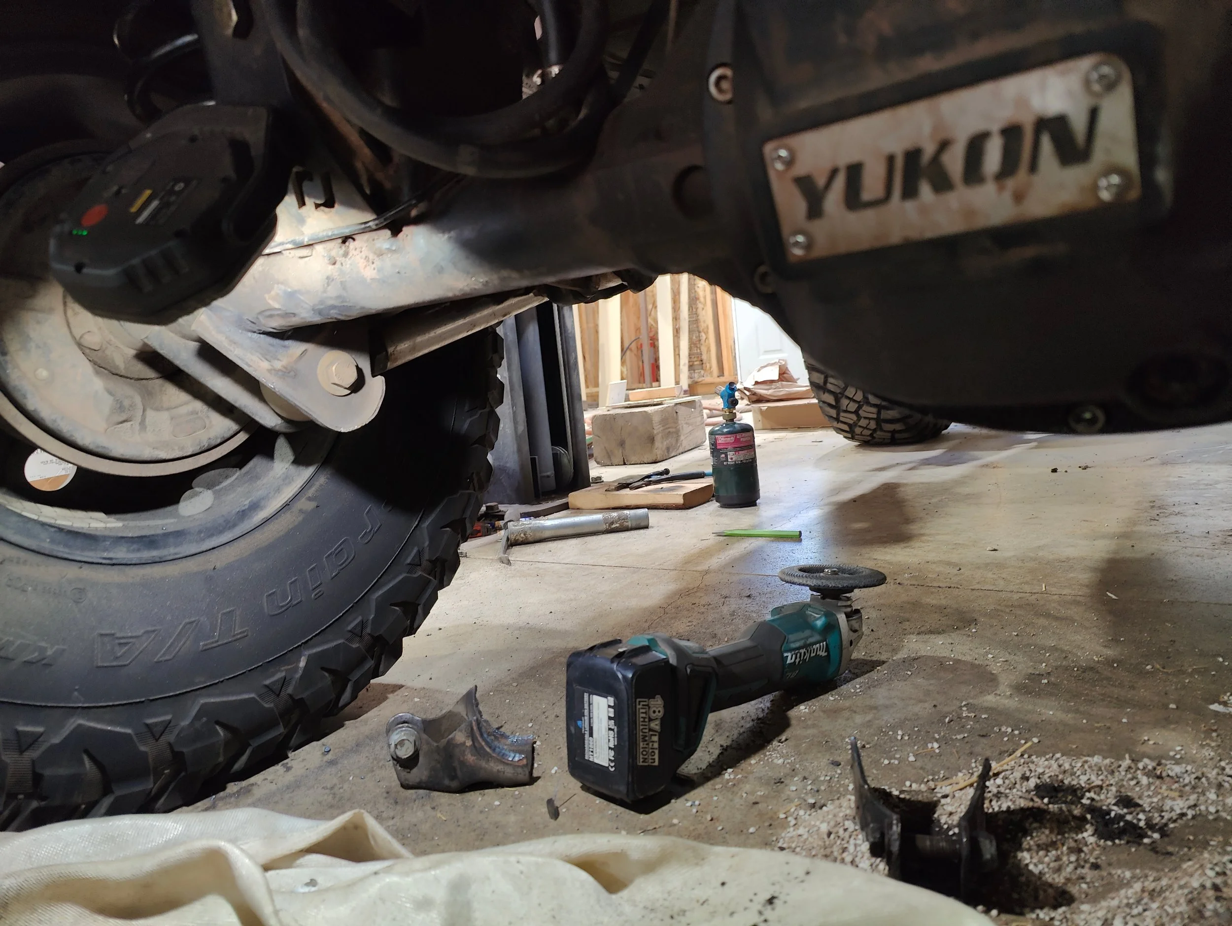

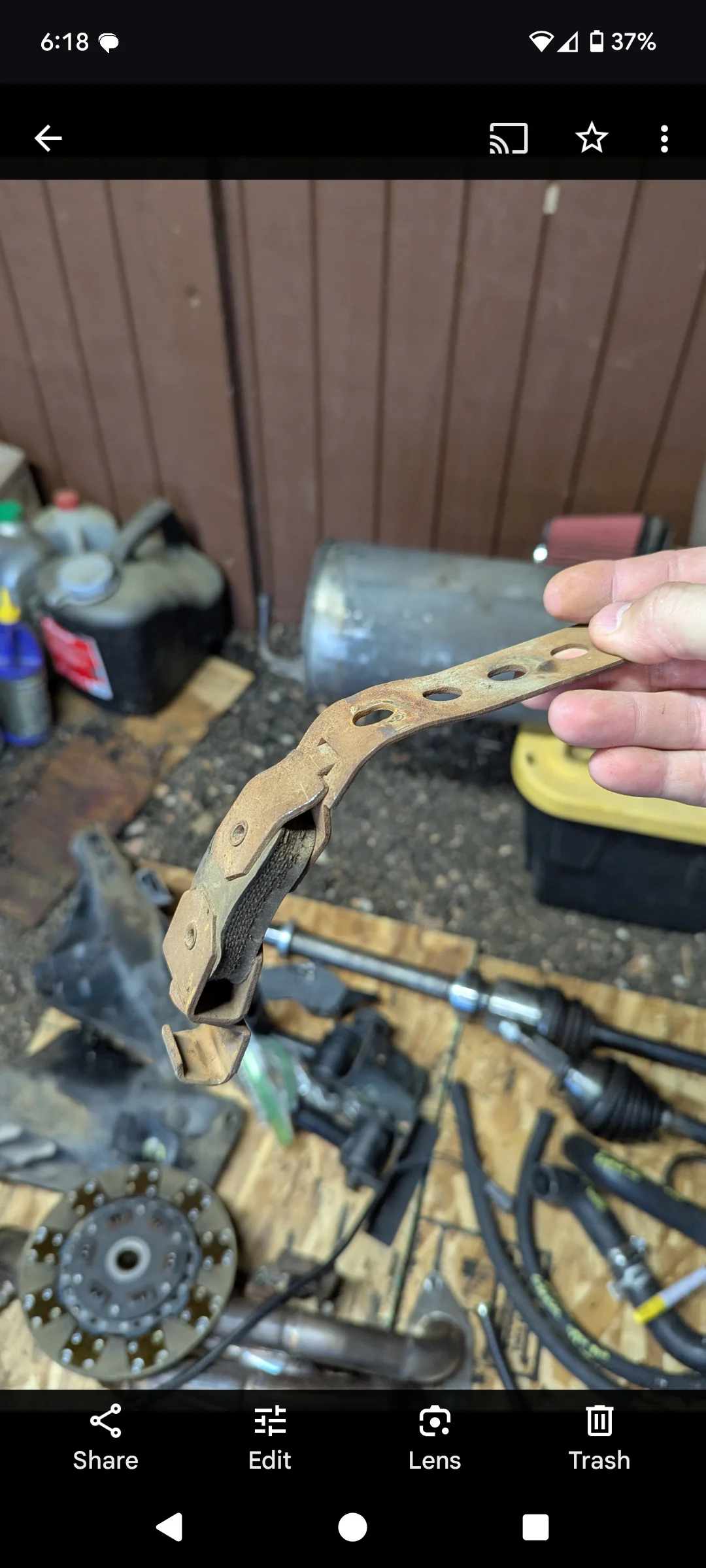

Tried and failed to beat the driver's upper control arm bracket into place. Not only has it collapsed but it's preventing access to the nut inside. No flag nut. I could cut the head but that would not gain me anything as the bolt wouldn't come out the other side...not lined up with the frame hole. So I decided to order a pair of upper control arm brackets from Barnes. And since I was paying for shipping I ordered their body lift frame brackets... since I'm in here I might as well cut the tub mounts and remove my BMB spacers and suck those up tight.
