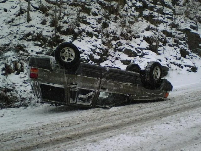

This is how my son's '96 Cherokee ended its ownership (all occupants walked away uninjured)
Glad to hear everyone made it out safely. That's a scary sight for sure & I bet that changed his outlook on driving (if it was your son driving).
Sorry if I get a little off topic, but yes, my son was driving. I get a call at work, "dad, I think I rolled my jeep". I frantically drive to the scene, and everybody is standing around, joking, making small talk. After I made sure everyone was OK, I asked my son " I think I rolled my jeep?". His reply was, "well it's only on the roof, and not a complete roll". Over a decade later, I can finally joke about the situation.
