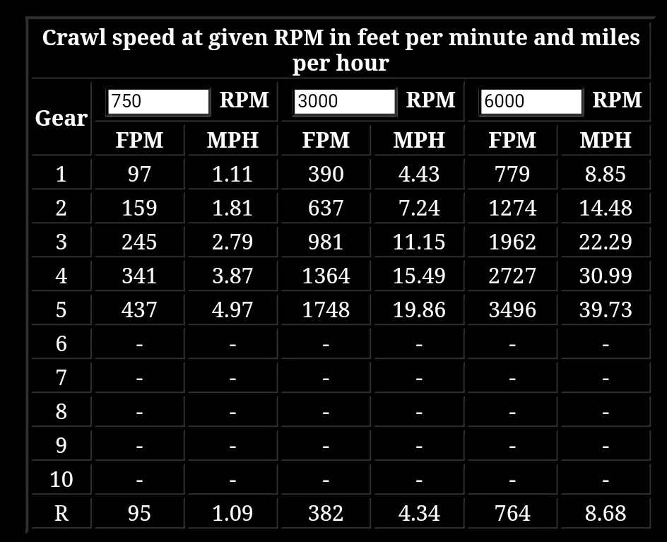

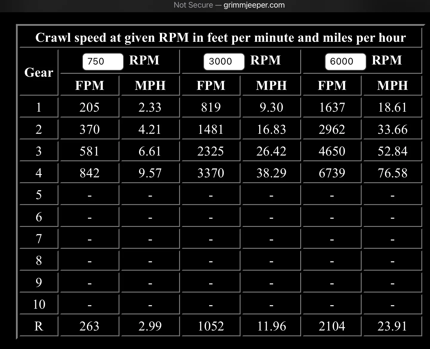

How fast can you drive in 4low?
Reactions: ranger101
I dont know how mrblaines brakes work but it must not use friction to stop ! most brakes work by friction and friction causes heat, so unless you have reverse thrust your brakes are either going to smoke or just get cherry red in the situation you described ! the only problem with your brakes was sitting in the seat pushing down on the pedal rather than using downshifting to maintain a safe speed ! and just how did you use 4low to stop ? you cant shift into 4low unless your at almost a complete stop !
Reactions: Zorba
I know I can and do. And mine is geared low enough to use high range 1st gear on the easier stuff when I need sustained speed without 4k rpm.
I have run down 191 into Moab in low at 70 mph. Couldn't figure out why it was revving so high and wasn't shifting.
